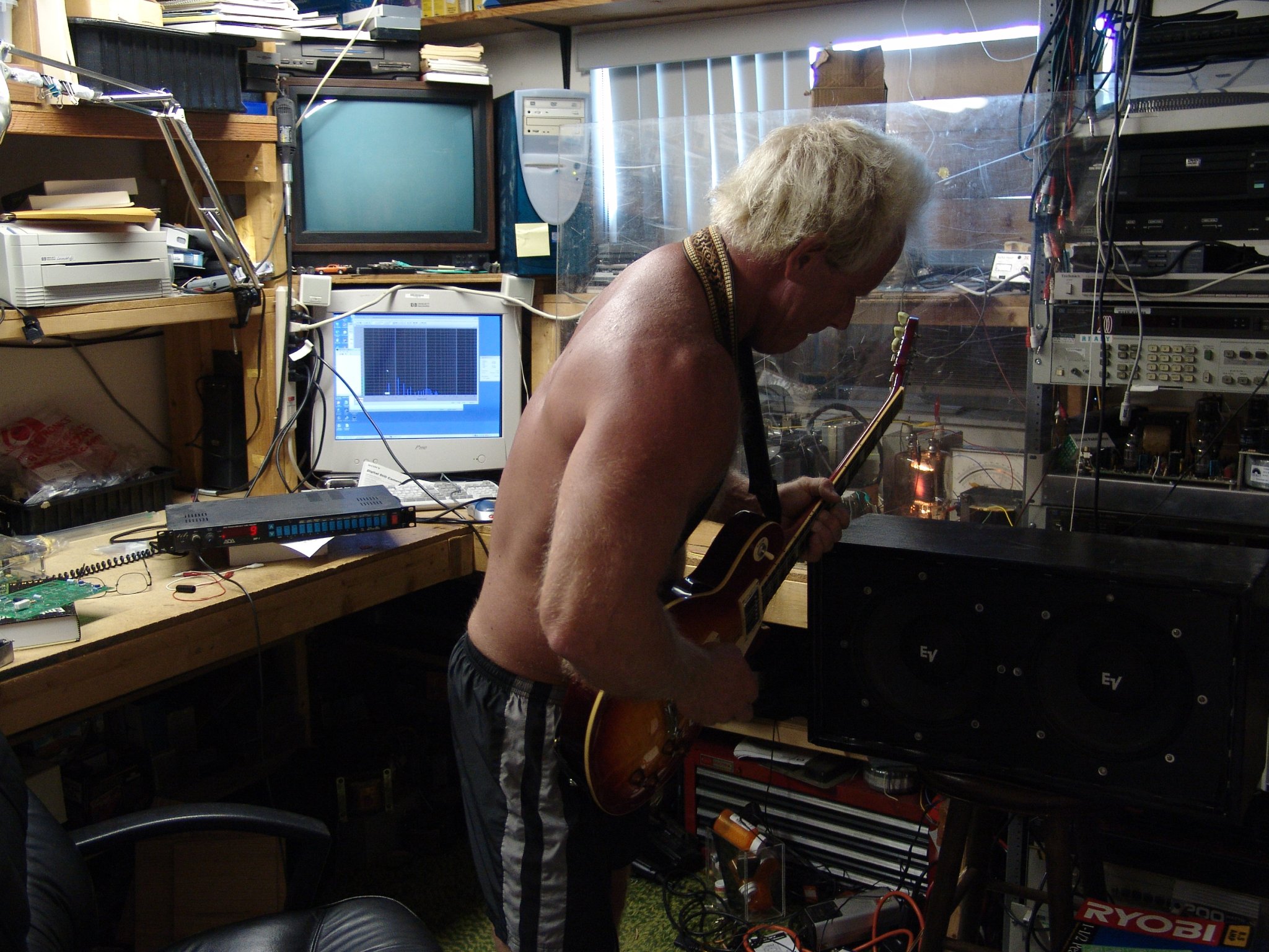

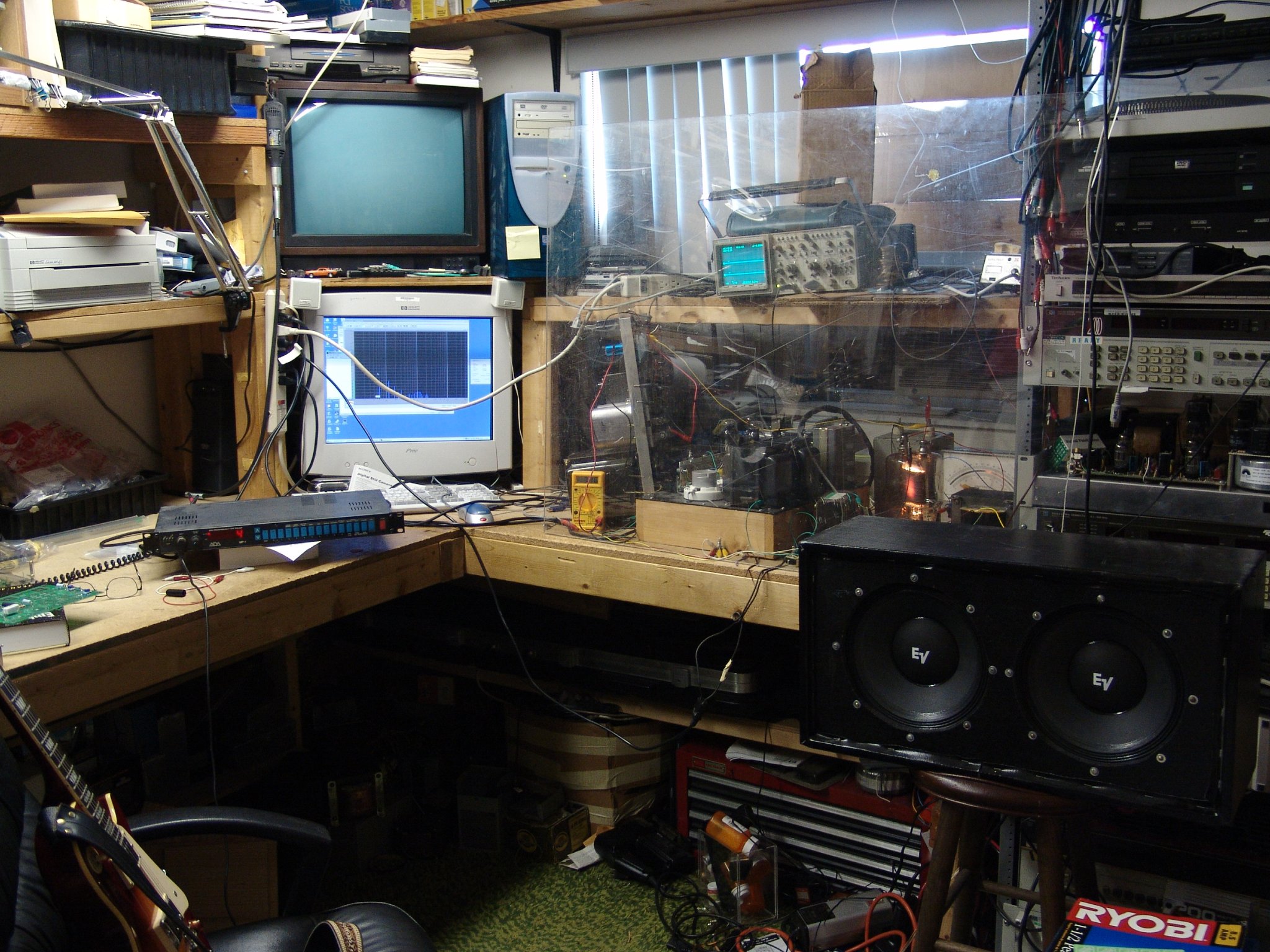

The MP1 can be seen here (rack mount unit on left workbench) driving an 833A tube into the red glow zone on 1500 volts. This was another very loud amp. Thint a 200 watt Fender Champ feeding the same pair of 99 db EVM-10s that I am using now with 40 watts.

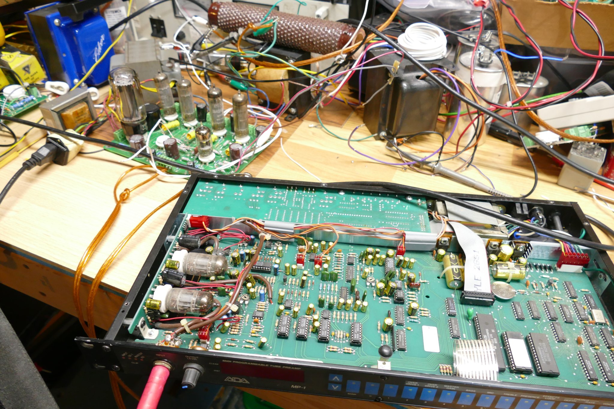

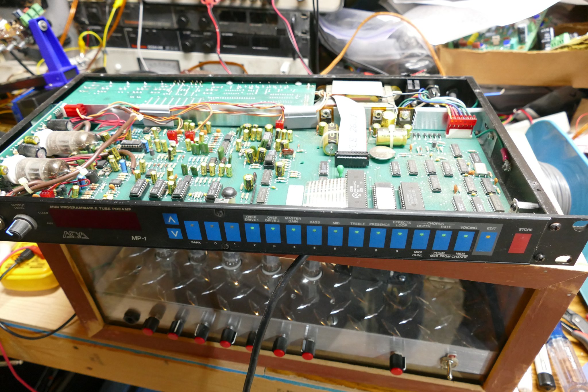

Thanks for sparking up an old memory. I now have the MP-1 opened up on my bench. Thie relic dates from the early 90's since the youngest chip in the thing wears an early 1992 date code. When it worked it was quite versatile and could do anything from mellow to metal and change personalities at the stomp of a pedal. There are a pair of 12AX7's as well as one each NE570 and NE572 chips. Both are "compandor" chips that can be configured for dynamic range compression or expansion. The whole right side of the unit is an 8 bit "computer" that runs a Zilog Z-80 CPU chip.
I'll know more about this thing after I study the schematics a bit and maybe plug it in to see what happens. I like the idea of a digitally controlled tube amp, especially for saving settings and recalling them. This setup is far too primitive though.
At least it's through hole. That's a nice blast shield you have on your bench; has it saved you from flying bits of fire?I now have the MP-1 opened up on my bench.
Part blast shield, part stupid guitar player death prevention shield. Fortunately, it was never actually needed. That picture was taken in my Florida lab about 20 years ago. The lab / listening space / computer room / recording studio was a small 10 foot by 10 foot kid's bedroom. Two walls had 30 inch workbenches from the visible corner to a 19 inch equipment rack at each end. Another wall was completely covered with records, CDs and those Akro Mills blue parts boxes full of parts. That left 40 to 50 square foot of floor space in the middle.
The totally unsafe "don't try this at home kids" test amp on the right side bench at the time the picture was taken was assembled from a 1500 Volt 1/2 Amp power supply from an old tube type RF transmitter (large rack mount unit stood on its end on the left behind the yellow meter), my 845SE HiFi amp being used to drive the 833A tube which is the glowing object on the right in its a custom socket created with Vice Grips and hose clamps, a big capacitor taken from a cardiac defibrillator, an analog current meter, and an OPT, all live with lethal amounts of electricity. The plate voltage / current flows from the power supply to the real "death cap" through the yellow clip lead. There are ample opportunities for stuff to go really wrong here, so whenever this thing was live there was 1/4 inch of Lexan between me and it. My real fear was that I could accidentally touch the head of the guitar to something live on the bench while my mind was occupied with playing the guitar or poking buttons on the MP-1. This amp was built for testing a custom Transcendar OPT that Gerry made just for it. The amp only existed for about a week back in 2003. Note the modern TV set and computer screen.

I have started digging into how the MP-1 works, mostly via Google at the moment. I have not yet plugged it in. I got mine used on Ebay pretty cheap sometime in the 1990s. Now they seem to be going for between $450 and $750 in working condition, so I don't want to destroy it. My random collection of schematics seems contradictory and doesn't make sense sometimes. It appears that this machine kept evolving as time passed and semiconductors came and went. My unit is from 1992 according to the dates on the chips, but the PC board's copyright date is February 1988. There are at least two distinct versions of the MP-1 and a MP-2.
The ADA Signal Processors company has been gone for a long time. There are lots of conflicting stories on the web about when and why they ceased operations. The most credible story from a former employee has the shut down date in late 1997. The large lot of guitar amp OPT's that I have were to be delivered to "ADA Signal Processors" at their Oakland address. The shipping boxes have the number 9016 on them which I assume is the date code. At least 1000 of these 6600 ohm transformers hit the surplus market in the 90's, and there were also some 4300 ohm versions surplussed at the same time. There was a fire that destroyed the ADA warehouse. The actual date of the fire and extent of damage varies from report to report.
This is what I have learned about this thing so far:

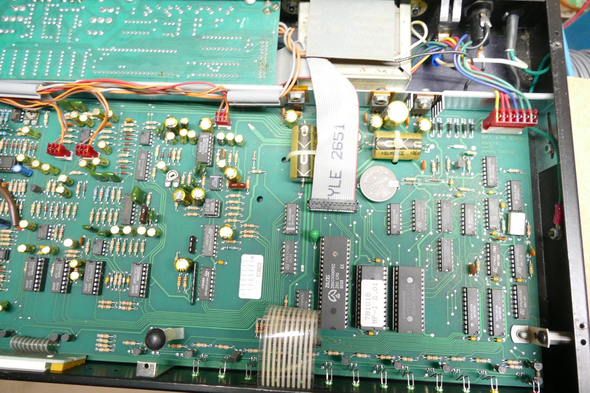

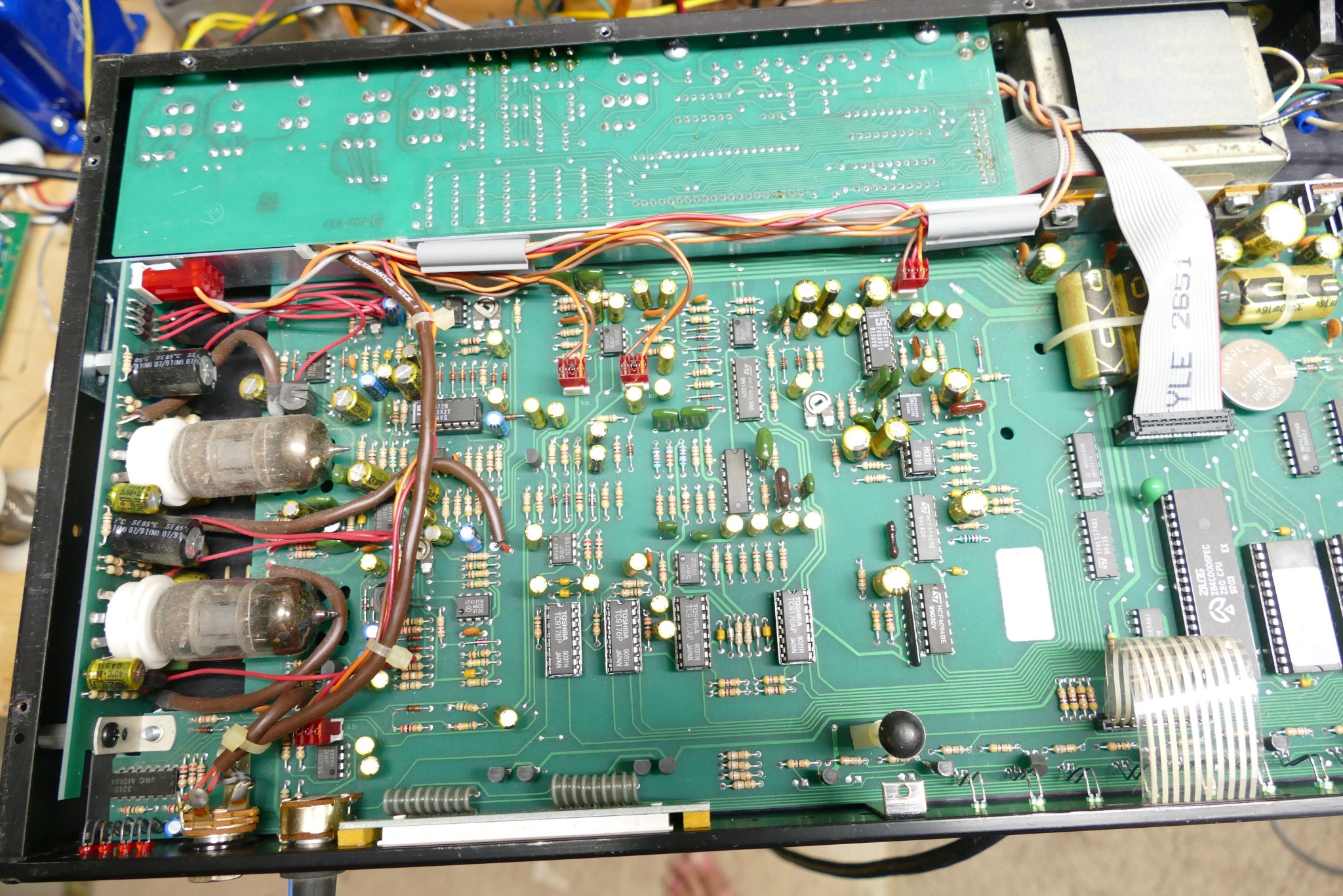

The guitar signal first passes through a solid state J-fet and opamp based gain and "overdrive" stage before making its way to the vacuum tube board. There are 4 12AX7 gain stages on the board with j-fet switches on the cathode bypass caps in the first two stages. A tap after these two stages goes off board to some solid state circuitry that includes one of the compander chips and half of a stereo digtal volume control chip The other two gain stages (4 total) go directly to the other half of the volume control chip. Both outputs from the stereo chip are summed to mono where they are routed to the EQ section.
The EQ section has four independent opamp filters with digipots in the feedback loop. Hand written notes on the schematics put the filter frequencies at 160 Hz, 600 Hz, 1600 Hz, and 3000 Hz. All filter outputs are summed together. There is a path through an external FX loop, and an internal chorus circuit that can be switched, summed, or bypassed to one or both (stereo) outputs. The chorus circuit has the second compander chip wrapped around a BBD chip which is clocked by the VCO in a 4046 chip which gets its control voltage from an 8 bit DAC made from resistors and a latch chip. Hand written notes put the clock frequency from 30 KHz to 270 KHz.
Since I have no intentions of cloning any part of this, I'm not digging much deeper into it, except for what it may take to fix it. There is plenty more information here if interested:
