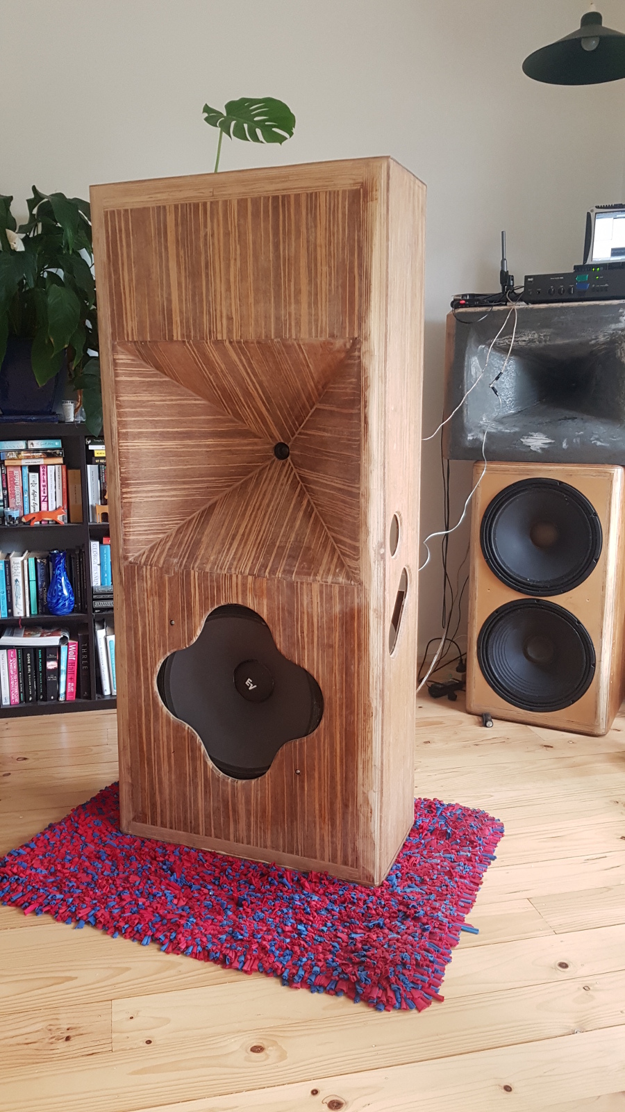

One image shows the in-progress speaker in the foreground. The midbass box in the background will (eventually) transition to sub use.

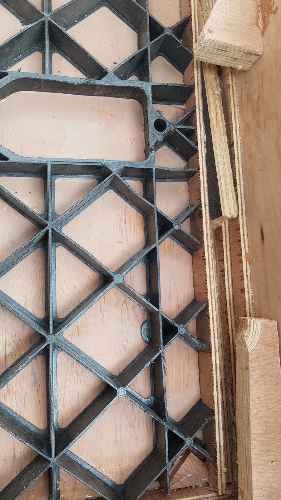

The other image shows how I'm using up scraps in this build. The translam sections are ply offcuts. The plastic grid is a section cut from a damaged pallet.
I got impatient, and fired the speaker up, incomplete. No back, no foam, just a simple open backed 2-way (700Hz cross, same DSP settings as prior speaker used).
Subjective impressions:
1) The horn is good. Dispersion seems quite even*.
2) There's an unnatural sizzle on cymbals and silbilance on female vocals.
3) The 18" is loafing at the levels I play.
A FR sweep shows (using same EQ as prior horn) not much difference:
a) HF is a bit different, with a small 9.5kHz spike, presumably the cause of the silbilance. I assume that's due to a throat or driver mounting problem.
b) a 2-3kHz bulge.
...that's much less difference than I thought there would be.
After applying quick + crude EQ to flatten these, it seems like a very natural, easy speaker.
* one odd effect: the prior speaker sounded really odd when my head was almost on the floor, e.g. when doing push ups, music would sound harsh and unnatural for part of the movement.
The new one doesn't do this - it sounds fine in the same situation.

How do bass and horn directivities match?
Not sure.
It is currently a 'normal' 2-way, crossed at 700Hz, whereas the prototype (in post 2) was a 3-way, using a multiple entry horn, crossed at 400Hz.
Hence, for the finished build, it's somewhere around 400Hz* that I'll be trying to get a directivity match.
The cutout for the 18" woofer probably widens dispersion a little (which is counter productive), but I like how it looks, and so does my GF. Now that she's seen this version, she doesn't want me to make a normal (round) cutout.
