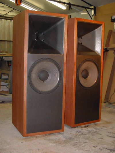

My current system is a horn >700Hz, dual 15" midbass, dual 15" sub. The main flaw seems to be uneven midbass (in a big open room with lots of glass + hard floors). Better pattern control would be nice.

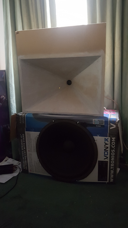

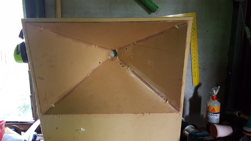

I made a prototype horn based on the Syncalc spreadsheet:
Coverage angle 90 x 65.52
~60cm wide, horizontal pattern control to 400Hz
I picked an easy build (mostly 45 degree angles, no secondary flare), and easy components, so it worked out OK.
I'd like to maintain some directivity < 400Hz, rather than have an abrupt transition to omni, as a small woofer would do.
Hence I'm considering using the biggest drivers I have (a couple of 18"), in boxes like the "Resistance enclosure" on this site:
Cardioid bass
That seems to have good output and directivity to < 100Hz in a reasonable sized box that doesn't require heroic crafting skill or lots of iterations to build.
Is there a similar / better option I've missed? e.g. would 2 x 15" arranged like the woofers in the small syns work better?

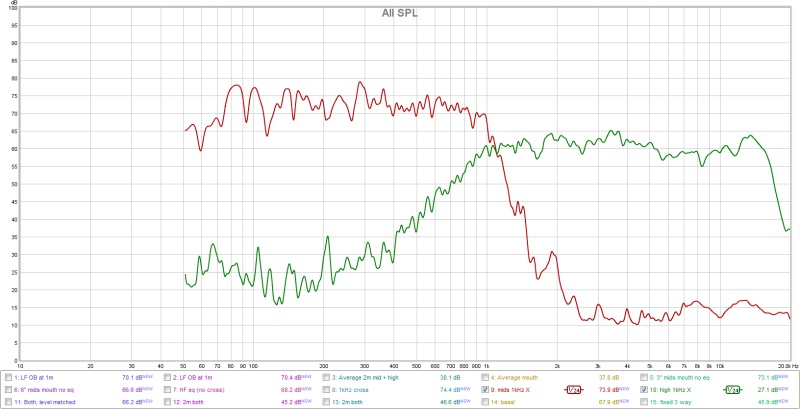

- I'm staying with a small cone driver at the apex. It sounds better to me than the couple of 1" compression drivers I tried.
- an 18" on OB gives plenty of midbass, and seems to go low enough to work with subs. Sweeps show high distortion ~100Hz, but that's probably because the baffle is cardboard and cable ties :) The raw driver is OK.

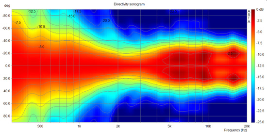

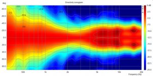

Pix: the directivity image is a Yorkville Unity, taken from the Red Spade blog, to illustrate "waistbanding". The others are from my prototype.
My FR plot has the midbass crossed at 1kHz, no eq. The HF driver is also crossed at 1kHz + has simple eq to address the HF rolloff.

Pattern control means a larger horn.. you can't rely on the woofer (even at 18 inches) to do that at the ~500hz region.
Since i built that K402 replica a while ago i have thought of ways to make it simpler to build - one way would be to use foam at the mouth to combat the waistbanding instead of a tractrix curve ala:
Alternatively, i would just build an even larger conical horn
What driver are you using for your horn, and how sensitive do you estimate it being in the horn? I'm thinking of getting an sb65wbac25-4 for a K402 like horn

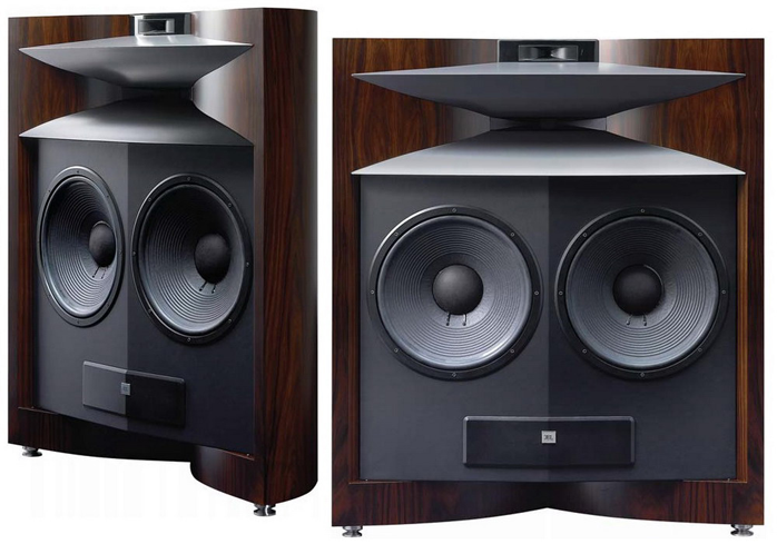

-you can do a horizontally-opposed design with 2x 15" all playing in the same bandwidth.
Say a 40" wide baffle cardioid (resistive side-vent on both sides) with each 15" at either end of the baffle and side venting. You can adjust the upper freq. pattern with how the woofers are "tilted" on the baffle relative to each other as in the Everest below:
Cone driver NE65w-04.
I compared it to a JBL 2" earlier, to get a guesstimate of sensitivity:
paper cone open frame driver for front horn
Post 39 shows the horn the comparison was done on.
That size and multiplicity of angles is a bit beyond me. I doubt I could fit a complex face seamlessly to the waveguide mouth.

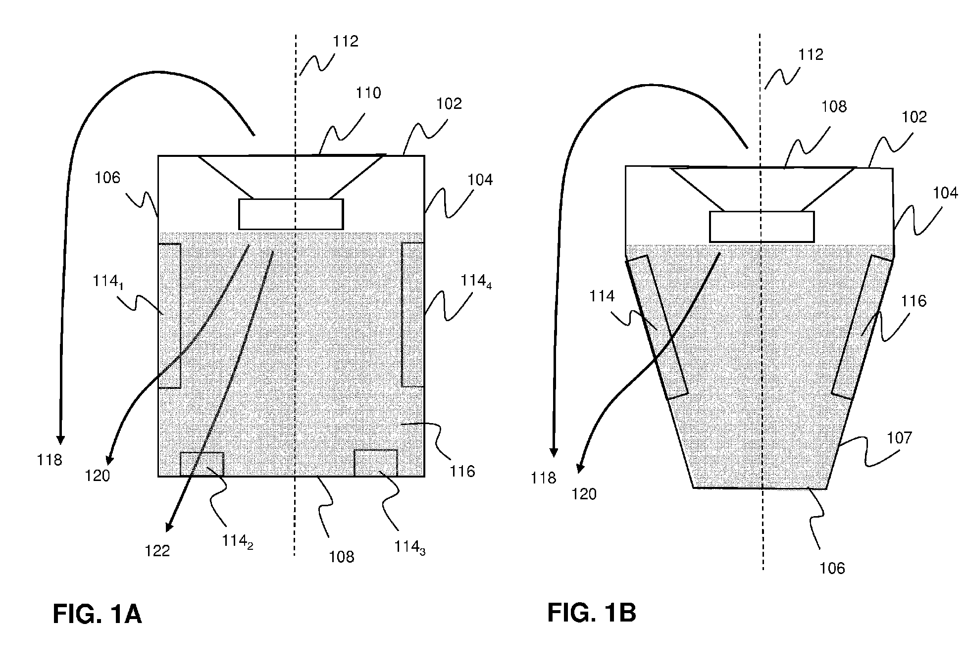

The Dutch and Dutch 8c speaker appears to have done passive cardioid right.
It uses a forward firing 8" that covers 100-1250Hz. The manual (and patent EP3018915A1) claims that "The passive cardioid cabinet weakens rearward radiation by over 15 dB"
The spec sheet states that the rear facing 8" drivers are crossed over at 100Hz, so it seems like they are simple subs, and do not contribute to the directivity of the forward facing driver. The manual recommends 10-80cm between walls and the rear of the cabinet.
I'd like those characteristics, but for about $15,000 less :)
The image is from their patent, and doesn't appear to require rocket surgery - it looks almost exactly like the boxes on the Kimmo Saunisto site.
