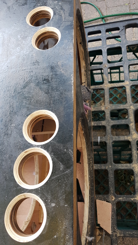

For my prototype, I'm trying light foam on the side wall perforations (some pretty chamfered holes are pictured, the other side has random shapes) and very dense stuff on the holes in the back wall (as yet untested). I'm guessing the lightly foamed holes will do almost all of the work / pattern shaping.
To keep the final version visually tidy, I think I will do something similar - I could do final tweaking by (internally) making some slots much more resistive than others. That seems like less work and mess than modifying the plywood shell.

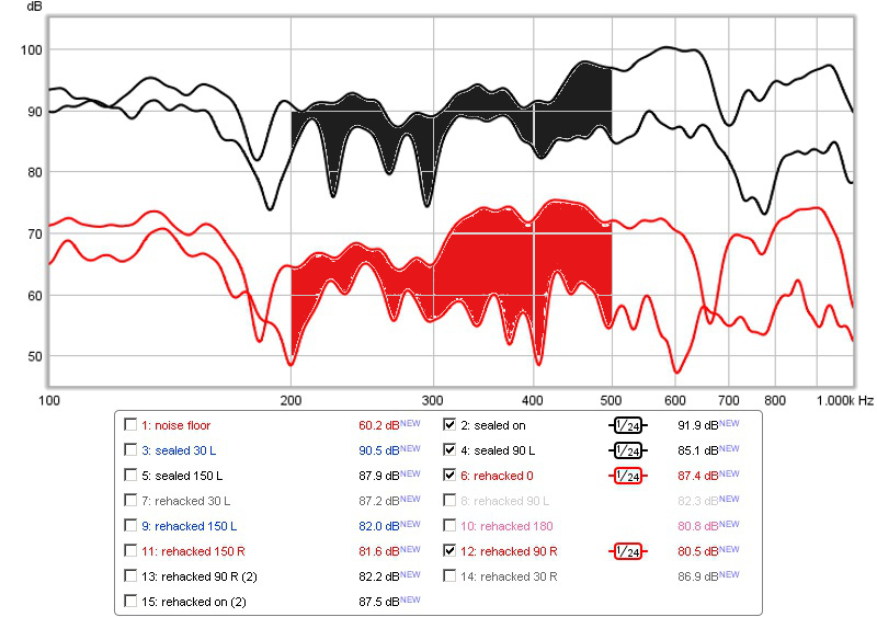

OLD INFO, REHASHED:
(1) Running 2x15" vs 1x15" made surprisingly little difference (outdoors). Only a narrow LF band gets the sensitivity gain. I've probably seen this info before, but it seems much more real now that I've measured it myself.
(2) The simple sealed box (48cm wide) has more directivity than I really understood. It is the same as the previous point - I've seen this info before (e.g. plots of the Geddes Loudspeakers NS15), but the effect seems more real now that I've measured it myself.
POSSIBLY NEW INFO:
(3) It looks to me like any hole in the back wall dominates the pattern you get ...so I think I see why Kimmo Saunisto and then keyser went with a solid back & perforated sides. I'm measuring a figure 8 (dipole-like) pattern, with big dips 90 degrees off axis, not the cardioid-like pattern that they report.
This figure 8 pattern persists even when the holes in my back wall are much more heavily damped than those in the side walls.
(4) Despite asymmetry in the side wall holes, I get essentially symmetrical response. I chopped one side wall further, to have about 2x the surface area open than the other ...and I still get symmetrical response. Not sure if this is always true, or if it is only true because of (3).
AND, THE PRACTICAL STUFF:
(5) Outdoors, the "standard" plots for the listening position (0 vs 30 degree off axis) look better for the "Resistance enclosure" than for the sealed box.
(6) Indoors, positioned near a corner, my "Resistance enclosure" is flatter on-axis than the sealed box.
These last two points are promising, and make me think it is worth persevering. The outsdoor off-axis measurements may seem underwhelming (not much better than the baseline box), but all that actually matters is whether there is a +ve effect at the listening position.

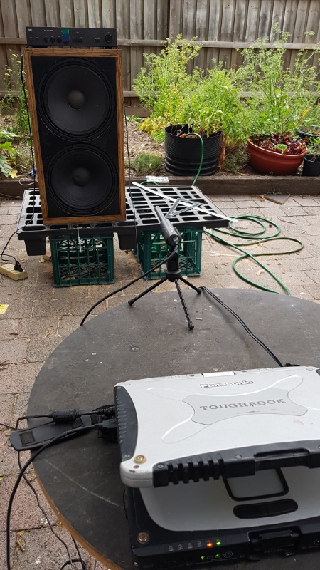

You should move those bushes in pots on the pavement between the speaker and mic when measuring.
I think maybe you are looking at a hose :)
The mic is on the little table in front of the laptop.
Tile floor gives "perfect reflection" now.
That seems right to me. I experimented with stuff to prevent ground bounce, and found that that made the notch in response worse (more complex).

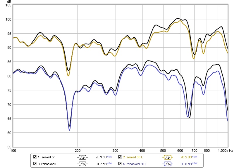

Black/yellow = sealed box, on axis vs 30 degrees off axis.
Black/blue = perforated box, on axis vs 30 degrees off axis.
Not much difference, but the perforated box is slightly 'tidier' off axis.
One has to read around the 2 big ground bounce notches... maybe next time I'll do ground plane measurements.
Looks like REW? I love it but it can't draw directivity graphics or count DI. But taking measurements at 10¤ steps and overlaying all of the 0-90¤ (and 90-180¤ separately) would reveal the directivity "shape". Set IR gating to 6, 12, 20, 60 etc. ms and look at same measurements again. I have found 20ms and 1/12 smoothing best and then first reflections can be detected easily.
