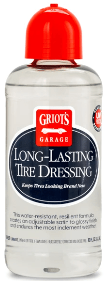

I have no idea what's available in Denmark, and neither of these are going to make cracks magically disappear, but for normal tire dressing, I like this:
https://www.griotsgarage.com/long-lasting-tire-dressing-16-ounces/

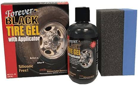

For longer lasting protection and more "rejuvenation," this is pretty good. You have to be careful when applying it, as it contains dyes.
https://www.amazon.com/Forever-Car-Care-Products-FB810/dp/B000EQVMZC

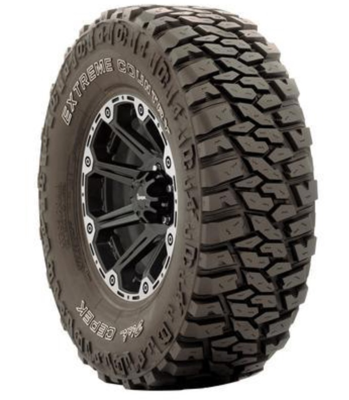

Kevin, your just looking at it with your city glasses on. If my buddy rolls up with a new set of these sneakers, there’s only one thing to say………them’s some purty tires right there I tells ya!
(Wonder how that google translates?!)
