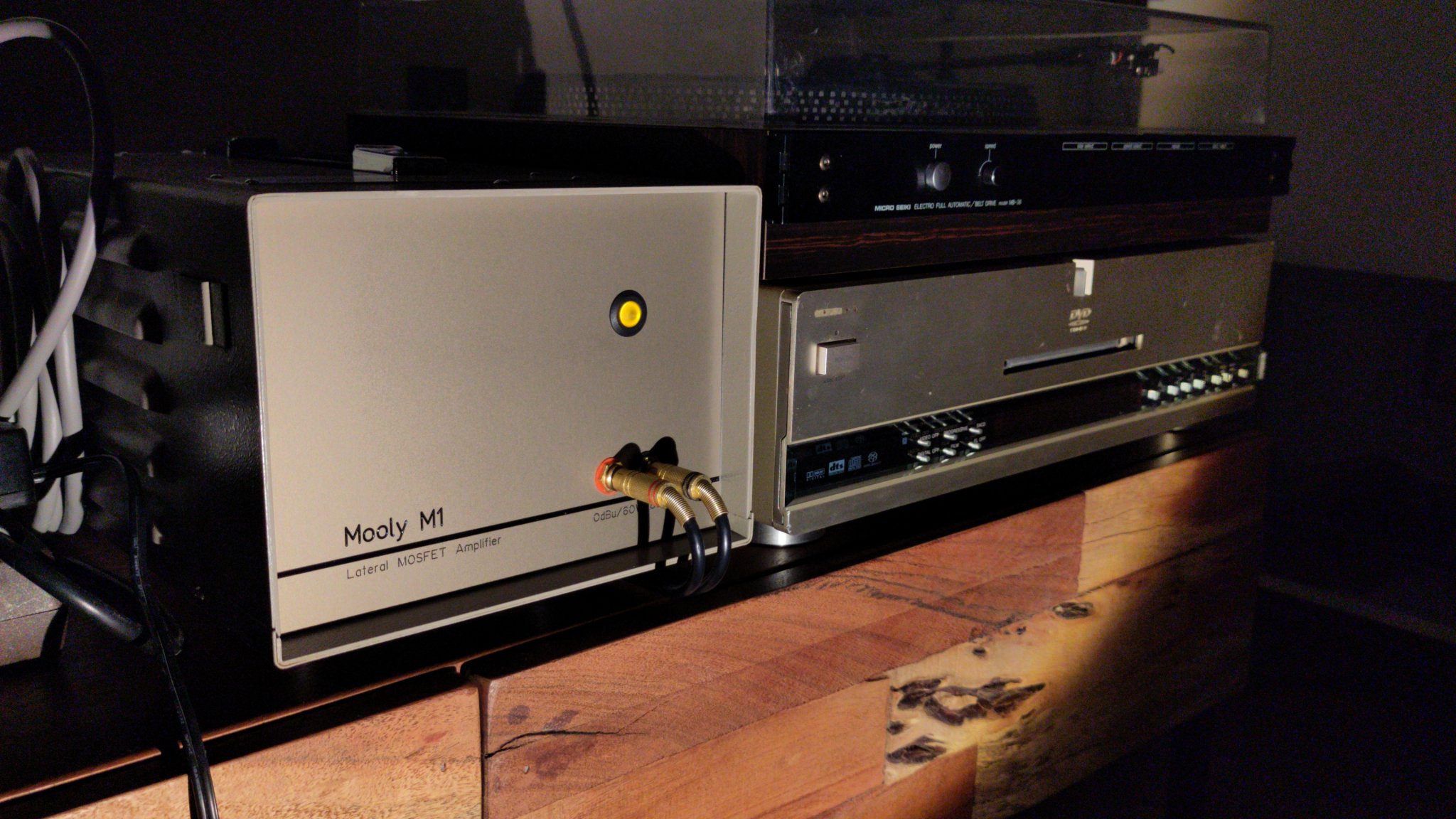

Meanwhile my amplifier is now set up in the living room, driving a pair of Infinity's. First impression is superb!
Finished :giggle:!
And the first impression still holds true. I am not good at answering the question of ''how does it sound?'', but I can say for sure that it sounds different than my other amplifiers, and it certainly sounds pleasing and not fatiguing! It has found its place in my main audio system, and it will stay there.

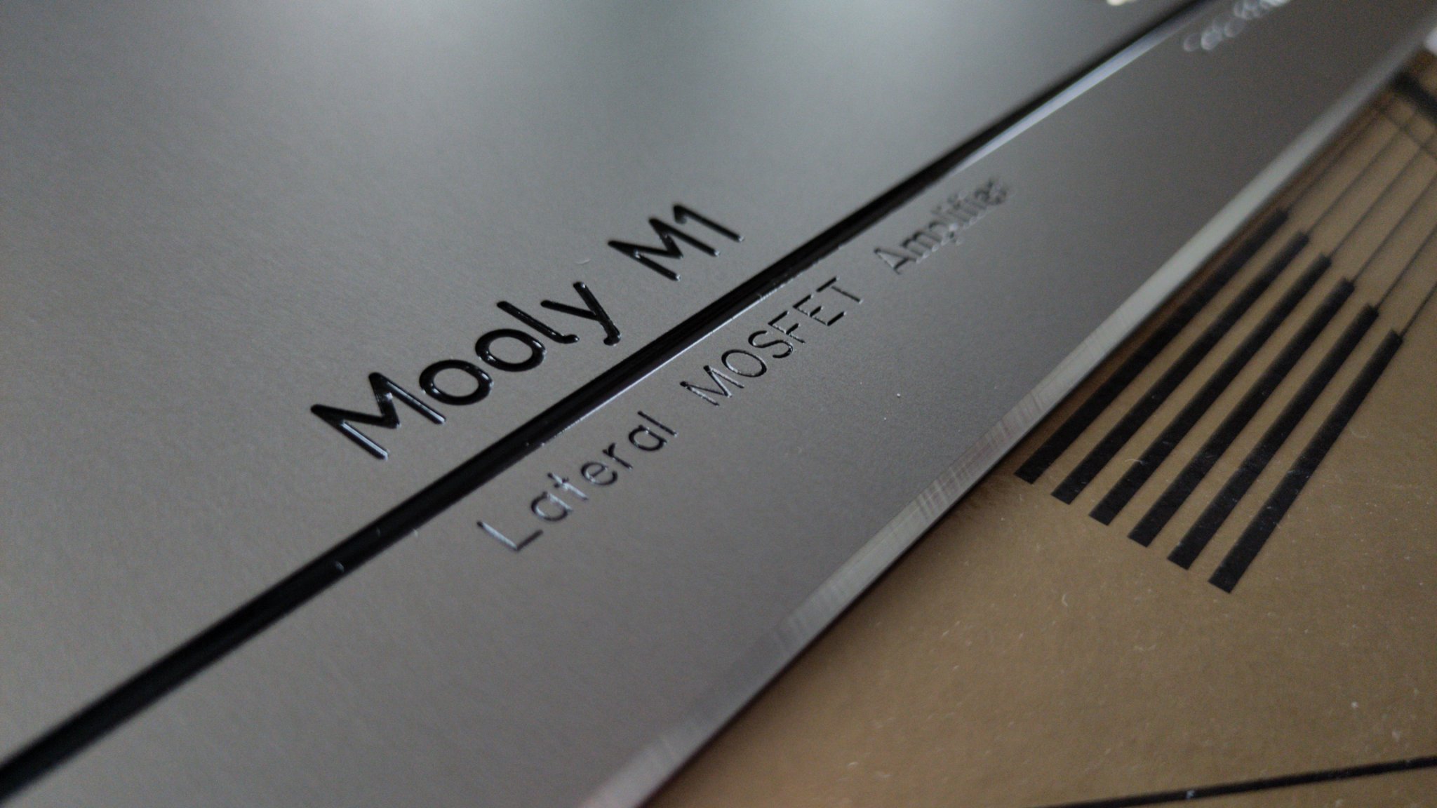

Some final photos (in rather bad lighting). The front panel was made by Schaeffer AG (or Front Panel Express, for those across the pond). It is anodized in a med-bronze color, which nicely matches the beige color of the case, as well as the champagne color of the Sony player next to it. I really like how it turned out!

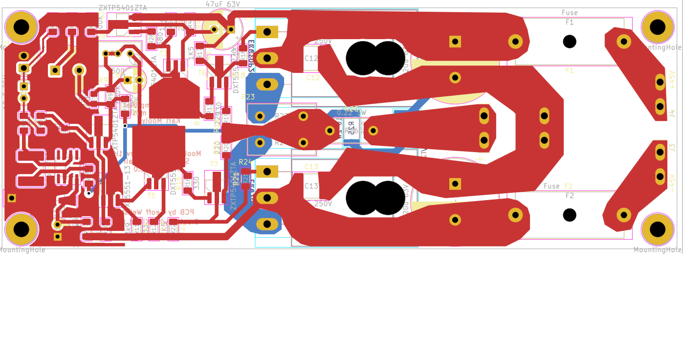

A few posts back I uploaded the schematic and renderings for the revised layout with component numbering matching Mooly's original. I forgot to upload the Gerbers to go with it. Here they are if anyone cares to use them. I've just ordered a min quantity of 5 from JLCPCB so, once I extract 2 for myself, will have a couple spare and am happy to pass them on for cost of postage (within UK) if anyone is interested.
A few posts back, I uploaded Gerber/BOM, etc. for a 50mm width SMD version of Mooly's amp. Looking at the track widths for the MOSFETs, the current carrying ones have a track width of around 1.5mm which KiCad's calculator says will do 3.24A max. That should be OK for domestic use but doesn't have much margin so I've revisited the layout and beefed up the relevant tracks. I've also taken the opportunity to increase the size of the heatsink areas for the constant current and VAS transistors.
