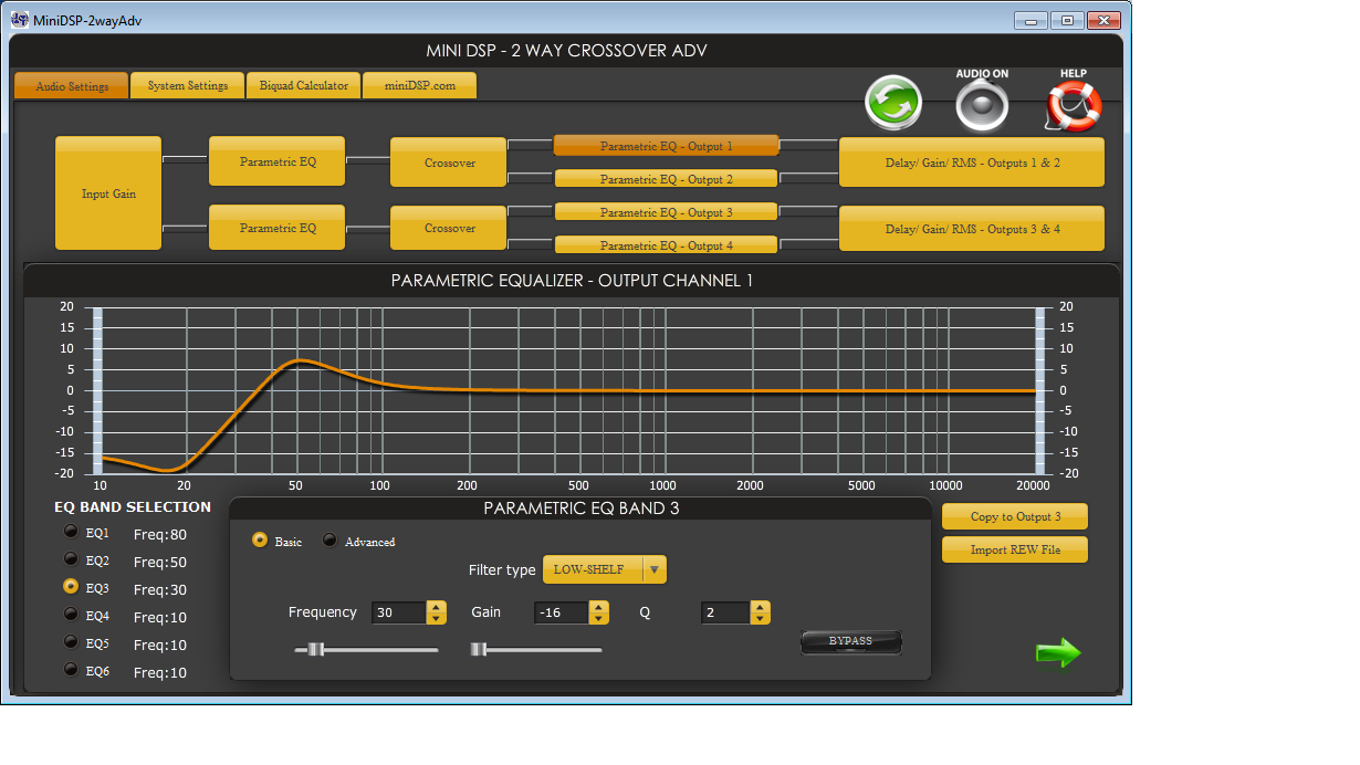

1x12" can only take so much EQ although it sounds very full I have to say.
At the moment I have a 1st order LP at 140Hz which looked good in Basta but I need to turn the amp up quite a bit to compensate.
Additionaly there is a low shelf involved and a negative gain peak filter to further compensate dipole loss and then bring the response down towards fs.

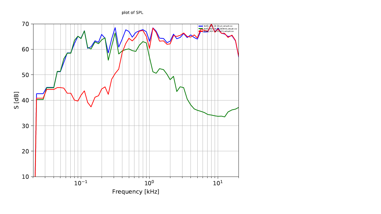

Measuring speakers in general and especially open baffle bass "in the room" is still puzzling me so I have to work on that before making further conclusions.
It looks though as the 6dB-LP is not getting rid of the dipole peaks so I will try a 2nd order filter next. As you can see in the measurement bass drops quickly after 80Hz although there is substantial output down to 50Hz. Thereafter it drops completely.
At 2k the measurement looks relatively flat. I don´t see anything that looks like a resonance but I measure a lot just from the listening position.

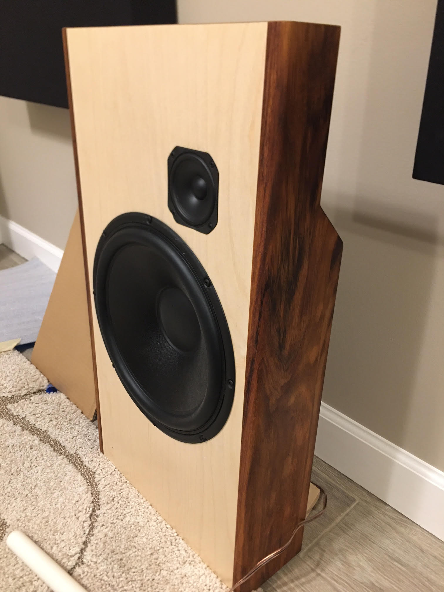

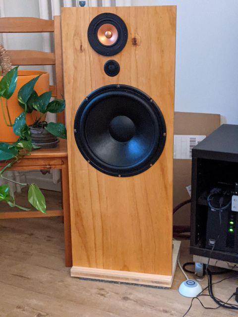

Hi All,
Thought I share my build (not complete just yet).
I love the look of the Manzanitas......and so I went with the slightly less-deep frame around the Mid/Tweeter. I also recessed the Mid/Tweeter. Although it was annoying to do so, I do like the aesthetics with it flushed.
This build was completed with only the scrap wood I had on hand. The baffle is 3/4" Baltic Birch plywood. The side frames are made from solid 3/4" Hawian Koa (from a busted side table we hand on hand). The top and bottom are again 3/4" Baltic Birch ply, but I veneered the top with a scrap teak veneer (I ran out of Koa).

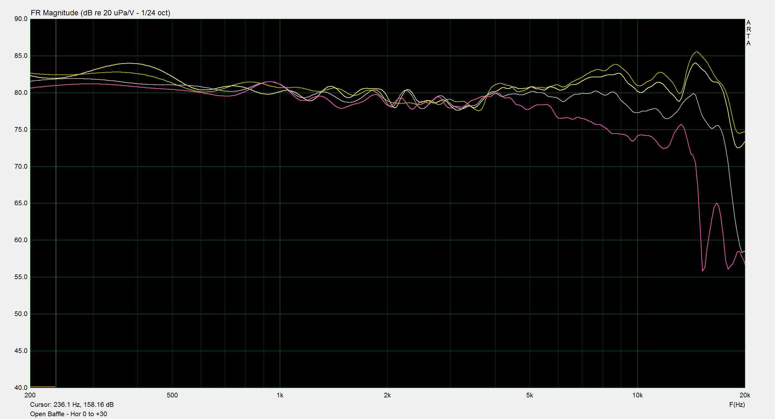

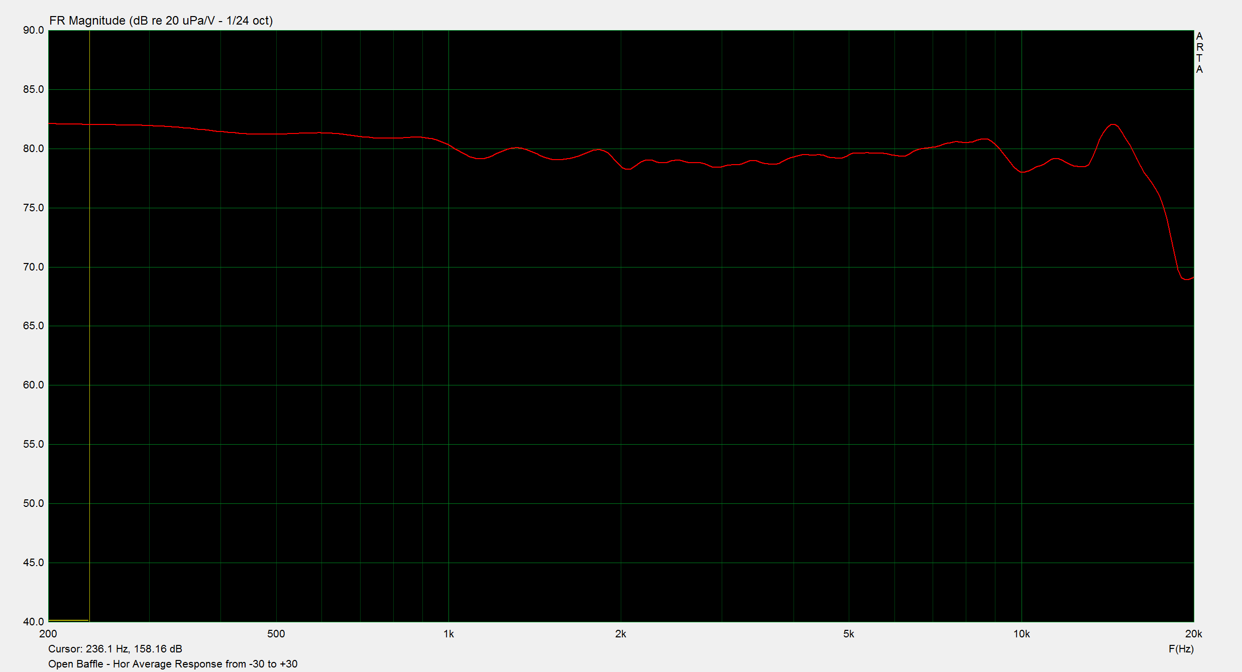

Considering this thread promotes experimenting, I decided to take my own stab at designing the crossover. To be clear, my crossover is in NO WAY an improvement, it's simply just catered to my taste. Some measurements included below. If people are interested, I'll gladly post the schematics and the exact dimensions used for my build.
All measurements were on the Mid/Tweeter axis, centered on the baffle, mic distance @ 1m (although the crossover was developed assuming 2m listening distance). Window: 4ms, Smoothing: 1/24th
Hi All,
Very nice! Thanks for the photos and the graphs, that's a very clean build. Neat work on the tweeters. Geez, with the price of koa these day you probably could have sold those planks and financed the whole project.
Thanks, Pano. You are correct on the price of Koa. A while back I had purchased a whole living room set made of solid Koa (no veneer - solid Koa). The previous owner had it built in 1962 while stationed in the Navy in Hawaii. All pieces were in good shape with the exception of this one side table. The table top was just enough in length and width to cut the 4 side pieces.

Congratulations on a very nice build.

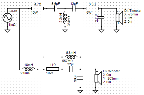

Manzanita is on my short list to build soon, and I'd like very much to see your plans and crossover details.
It looks like you have about a 3/4" round over on the front edges and that's what I have in mind as well.
But mostly I would appreciate your opinion on extending the side pieces all the way to the floor instead of using a stand. When I raised that possibility previously, Pano or John (can't remember which one) had some concerns about how it would effect the bass. Not major concerns, but something that might require some additional tweaking.
Crossover
Sure - see crossover pic.
The crossover was optimized for 10/15 degrees off-axis. The crossover point is approximately 850hz. With the relative close listening proximity for my area, I like the tweeters/mid on the outside.
If you want to bring the top end (i.e. greater than 5khz) down a little bit, you can try the capacitor value of 3.0uf or 3.3uf, in lieu of the 2.7uf. Doing so will move the electrical/impedance phase angle towards 45 degrees, but I personally don't think it's a concern considering the impedance remains above 10ohm (and almost above 15ohm in the concerned area).
While the measurements above indicate a slight frequency response depression (1db - 1.5db) in the 1.25Khz - 4.0Khz range, it is also the same range where tweeter/mid dispersion is at its widest (within its operating range). So there is plenty of 1.25Khz - 4.0Khz energy in the room. Designing for it to be perfectly flat made the speaker sound a little forward for my taste.
Also, the tweeter/mid naturally has a rising response (above, say, 5Khz) when listening on-axis (directly in front of the speaker). I've only slightly tamed this rising response because it drops off very quickly off-axis due to the natural dispersion of the driver.
I used 18AWG inductors, but if you care for more bass-bump, feel free to use a lower AWG. All parts were purchased from Erse I'm one of the lucky few here that can't hear the difference between budget / moderately priced capacitors and the top-of-the-line stuff. I wouldn't want to discourage anyone from using premium parts on the crossover, but one should still consider testing out with budget components to confirm the sound works for their taste (before investing top dollar). I believe my crossover cost was approximately $80 (total, for the pair).
In regards to your concern about extending the sides down to the floor, I (personally) don't think there is anything to worry about....at all.....as long as you are simply extending the sides and not the entire baffle itself. Doing the latter may warrant some crossover tweaks, but I don't think any adjustment would be necessary if you are simply extending the sides (even if you double/triple the width of the sides below the speaker for added stability).

So it looks like you built it according to the original plans, 15"w x 27"h, but are using it resting directly in the floor without a stand.
That would put the mid/tweeter at about 21" above the floor rather than at a typical listening height of about 36". I would also put the woofer much closer to the floor than I think is recommended with this speaker.
Is that the case, and if so, do you think it compromises the sound or not?
Sorry, I’m using the speaker on 18” (or 16” - can’t remember) stands. The pictures was just to show what they look like, but not in their actual listening space.
I would not recommend putting the speakers on the floor - which is in agreement with Pano/John’s recommendation. Nor would I have them so close to the back wall (as in the picture above). I would definitely follow Pano/John’s placement recommendations.
