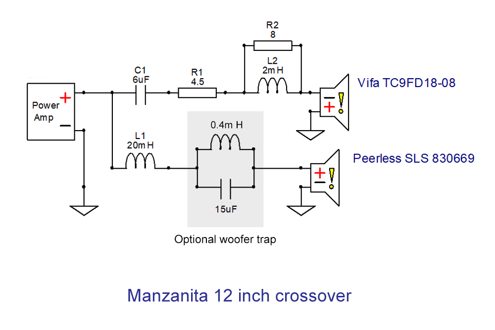

The Manzanita Crossover
Here we have the simple and clever crossover that makes this OB speaker work. See below for the 12 and 15 inch versions. Actually, either crossover will work with either woofer, but the versions below have been tweaked for best performance with the different woofers. The big piece is the low pass inductor on the woofer. It can be 18-22mH, default 20mH. Use a 14 or 16 gauge iron core inductor. This is available from Erse, Madisound or Parts Express in the USA. This part is relatively expensive, but important to the design. Default part at the moment is Parts Express P/N 266-960 (16 ga. 20 MH)
Capacitor C1 is the high pass filter for the Vifa. R1 is attenuation for the Vifa, while R2 and L2 shape the top end response of the Vifa. Tune the value of R1 to raise or lower the overall output of the Vifa (mids and highs) and tune R2 to change just the levels of the Vifa highs. The tweaking/tuning range of R1 is usually 2:1 centered around the nominal value. R2 tuning range is the same 2:1 ratio around the nominal value. 5-10 watts is enough for these resistors. Default is capacitor is Parts Expres P/N 027-236. You can use 5.5 - 6.5 uF to suit. Look for 200 Volt or higher Poly, film and foil, MKP or Oil construction. NOTE: Connect the Vifa in reverse polarity.
Please be prepared to tweak and tune these values to suit your room acoustics and your speaker placement. The overall level as well as the slope of the Vifa response need to be tweaked for your situation. Take your time, start with the default and tune it for you room.
In series with the woofer will you see an optional woofer trap. This helps tame some come breakup of the woofer. It's a nice addition. The same trap works for either woofer.
EDIT: Now that these are posted, I will add some detail to the posts.

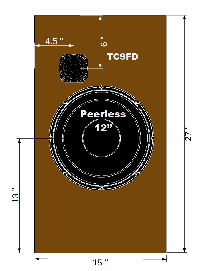

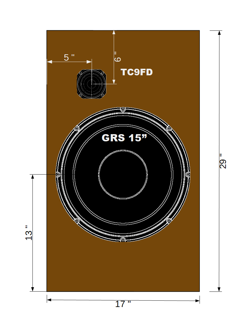

Hello, I'm planning to try my first DIY project and build the Manzanita "classic", but I wasn't able to find wich is the difference using the 12" or the 15" driver version, apart of the price difference of the two drivers, for what reasons I should chose one or the other?
The Peerless 12" had gone way up in price at one point, so an alternate woofer was found. The GRS is perfect for this project and the bigger woofer means the speaker is a little more efficient. It should play a little lower than the 12.
That said, the Peerless is a superb driver and really sounds nice. I love them.
