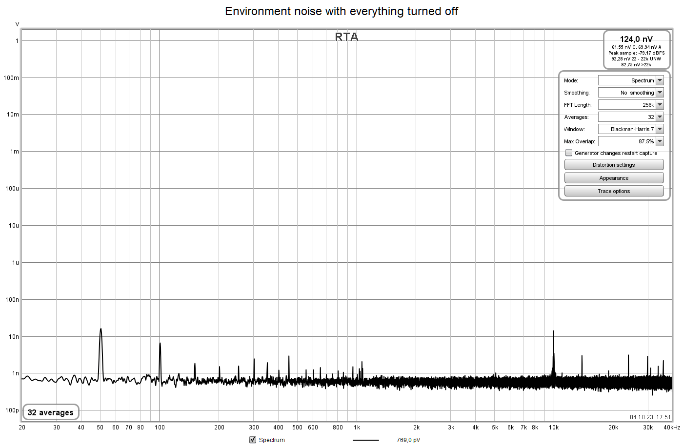

I’ve made a new connection & load box for amp output interface. There is 8 Ω load inside and BNC connector for measurement gear. Here is what noise is there when everything in vicinity is powered down and amplifier is turned off.

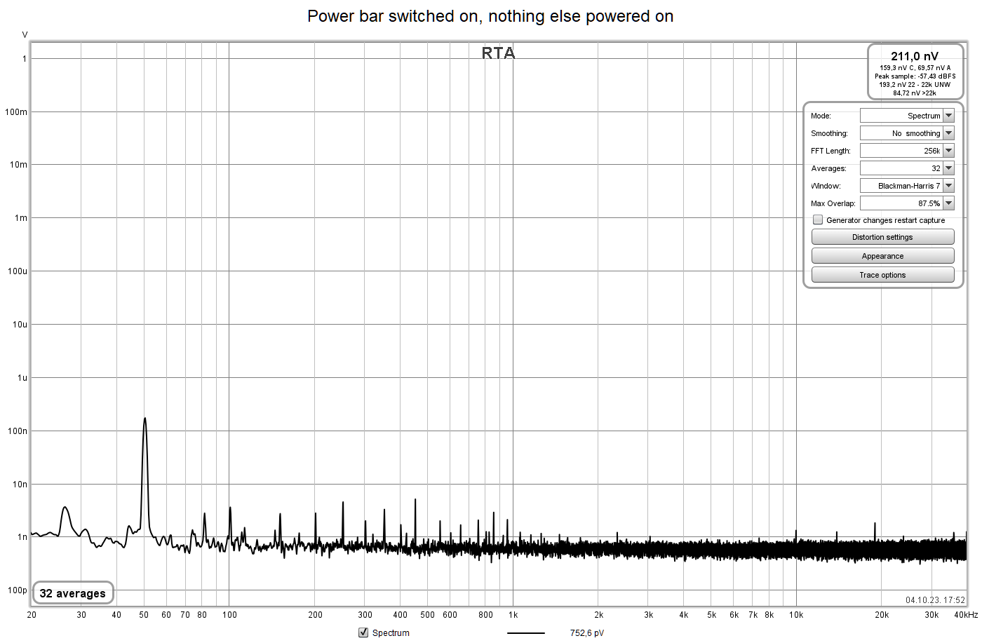

Next, noise with just power bar, 1 m from the amplifier turned on with no load at all. That 50Hz spike is there.

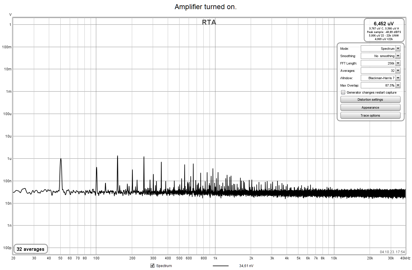

Last, noise with the amp turned on.

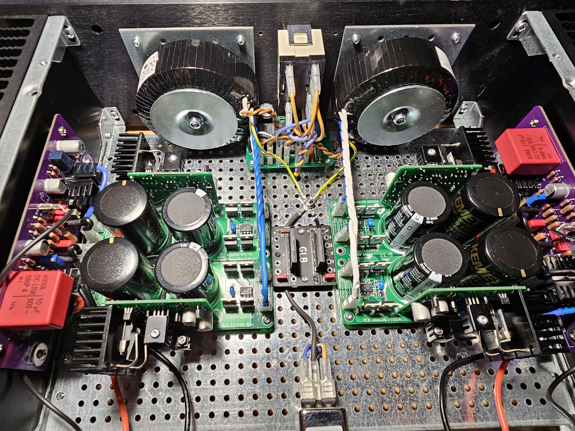

50 Hz noise is not related to the decoupling, so there will be no change. Anyway, decoupling seems to be ‘perfect’ which is proven by 100 kHz square wave response and slew rate measurement.I'd give Q8 and Q9 a chance to get fully decoupled rails (especially in this case... a 2MHz bandwidth) by moving the (C11, C12 & C13) to the left and (C14, C15 and C16) to the right.
Now, just stop for a moment and think how we are all easily fooled with measurement scale that there is something to improve.
Should I care for 1 uV spikes here and there in a power amplifier?
The fundamental question is the coupling mechanism: is i electrostastic, i.e. capacitive, or magnetic/inductive.
I think it's inductive.
I recommend building some magnetic sniffer. This can be a simple current loop shorting the input of the oscilloscope probe. More sensitive is a coil full of magnet wire that you connect to the input of a high gain audio amp, any guitar practice amp will do the trick.
With a battery powered practice amp and a small coil I investigated the premises of a customer complaining of hum problems all over the house. And found a hum loop spread over the hole ground by double wired electrical installation in the garden which we the fixed afterwards by one simple wire disruption.
The area of that magnetic loop was really huge!
Magnetic hum hunting with such setup can be a quite interesting experience. You may detect power cables buried in the ground as well as ground currents in the vivinity of power plants.

Absolutely not. If you connect speakers with 100dB/W sensitivity, those 6uV would produce less than 0dB hum @1m. To be more precise, ~13dB below the hearing threshold.Should I care for 1 uV spikes here and there in a power amplifier?
Speaker cables alone will pick much more hum than it comes out of this amp. So further improvment in this department is wasting time.
Is there a reason you changed the vertical axis to V instead of V/rtHz? Also if you used a BW of 10Hz-100kHz the total noise would be comparable to e.g. regulator specs.Now, just stop for a moment and think how we are all easily fooled with measurement scale that there is something to improve.

Total amplifier’s output noise in the 22 Hz – 22 kHz bandwidth is ridiculously low 5 uV. That’s because of design and great PSSR that amplifier has, in the first place.
Voltage regulators are good as well with 120 dB PSSR and some 2 uV total noise.

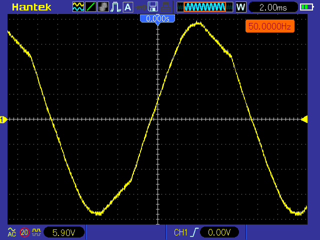

I agree that reason for that harmonic content is rectification process. As harmonics are related to the voltage waveform deviation from the ideal form, any mains waveform deformation will be seen as harmonics. Here is what mains voltage looks like at my place. Nasty.btw it the harmonic spectrum is interesting. The last plot shows significant 100Hz/H2 component, i.e. a heavily, unsymmetrically distorted 50Hz signal. That may originate from a rectified 50hHz circuit.
Best in class actually is about 20uVrms noise at speaker terminals, so hum of 1uVrms is expected to be buried in noiseThat's 120dB below 1V. Depends on where the other noise and distortion levels are.
