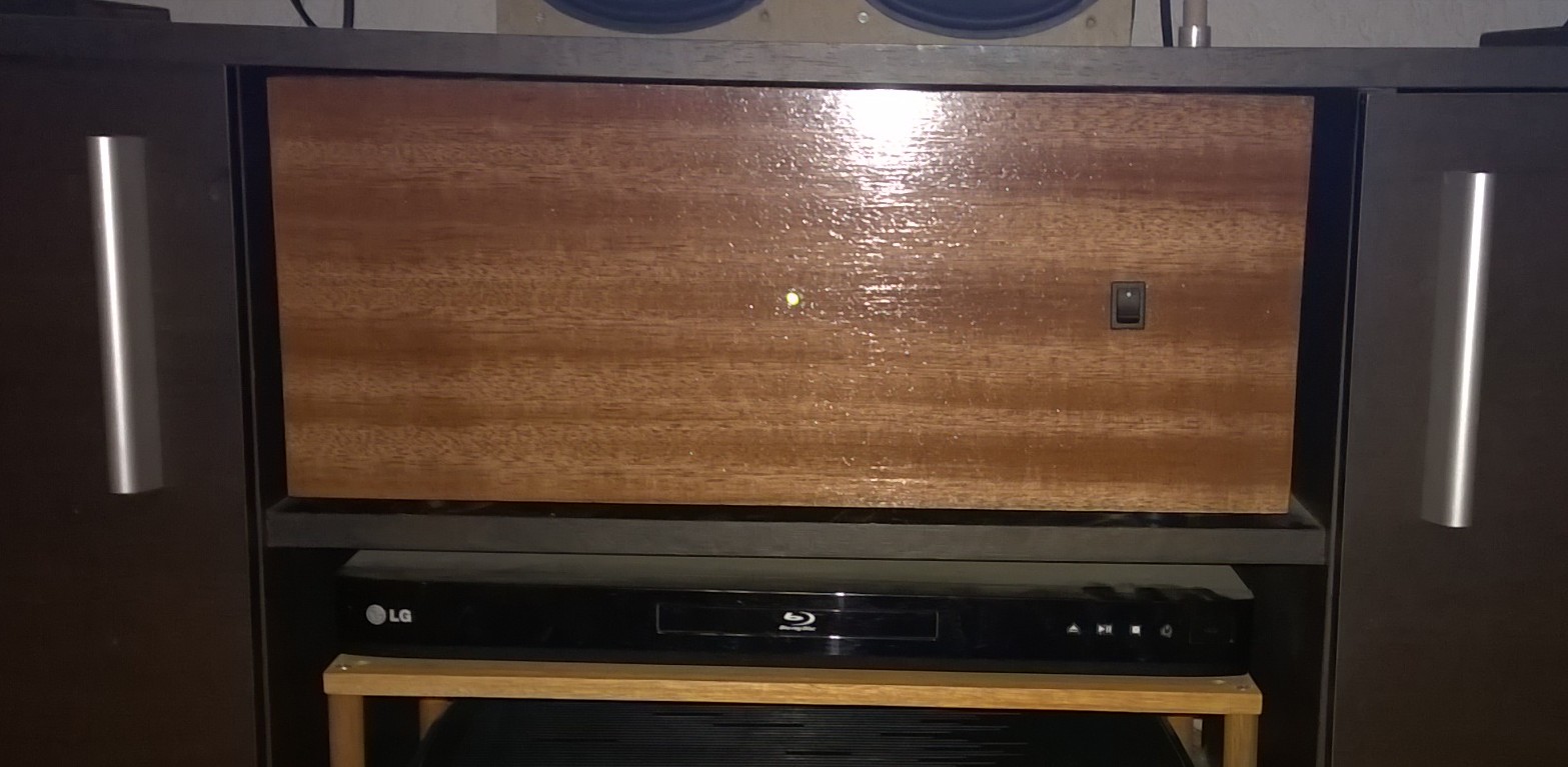

Mooly, you'll be interested to know the amp is properly grounded now. But here is why you can't touch anything electrical anyway. :)
