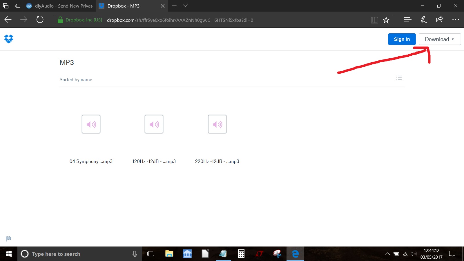

I've sent you a link for the files. They are not compressed and you have a choice of WAV or MP3.
You should see something like this for each. Click the dropdown and select direct download.

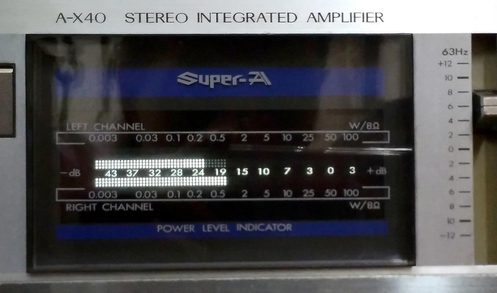

I did the test with maximum bass treble (Audio sacrilege, Please dont shoot me.) and also with tone defeat. Here are the details.
Speakers : DIY three way first order crossover speakers of unknown parameters (Howevers all drivers i.e. tweeter, mid and woofer are 8 ohms), Amplifier : JVC A-X40, CD Player : Generic, Multimeter : Digital with 200mv AC measurements and above, Room Size : 18' x 10' x 9.5' (feet), Music : 'Shoot to thrill' from AC/DC 'Back in black' album.
Measurements :
With music playing : 6.2 V at speaker terminal max.
120 hz With Bass and treble at maximum : 6.6v
120 hz With Tone defeat (Direct) : 3.4v
220 hz With Bass and treble at maximum : 2.7v
220 hz With Tone defeat (Direct) : 2v
Interesting tidbits :
Amplifier is 50 W into 8 ohms. I think with 220/250k volume pot potentiometer, with 10 segments markings on face plate I played unbearable loud at 1.5/2 marking point. I know VU meters are not good reference to see power required but on amplifier VU display it never went past 2w marking. (See pic attached) Don't know if all this is helpfull.
So max voltage is 6.6v and min. 2v. So I guess (6.6x4)(6.6x4)/8 I will need approx 88watts max if I use tone controls AND (2x4)(2x4)/8 = 2watts with direct playing. Right ?
