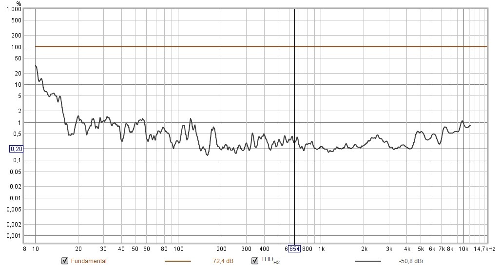

Hi wout31, so which the correct measurements, this post #5 or post #3? Seems the THD measurements are different.Here is a plot of the ESL-63
Fundamental and reference line at 0,2%
With a sweep measurement you have inter-modulation distortion.
This is 75 dB @ 1 meter in the living room.
You don't state volume and distance
Both are correct, different set of the same model have different measurements due to small building differences. Quite normal.Hi wout31, so which the correct measurements, this post #5 or post #3? Seems the THD measurements are different.
Plus measuring with sweep or single frequency gives different results due to interference in the sweep. Single frequencies give better numbers.

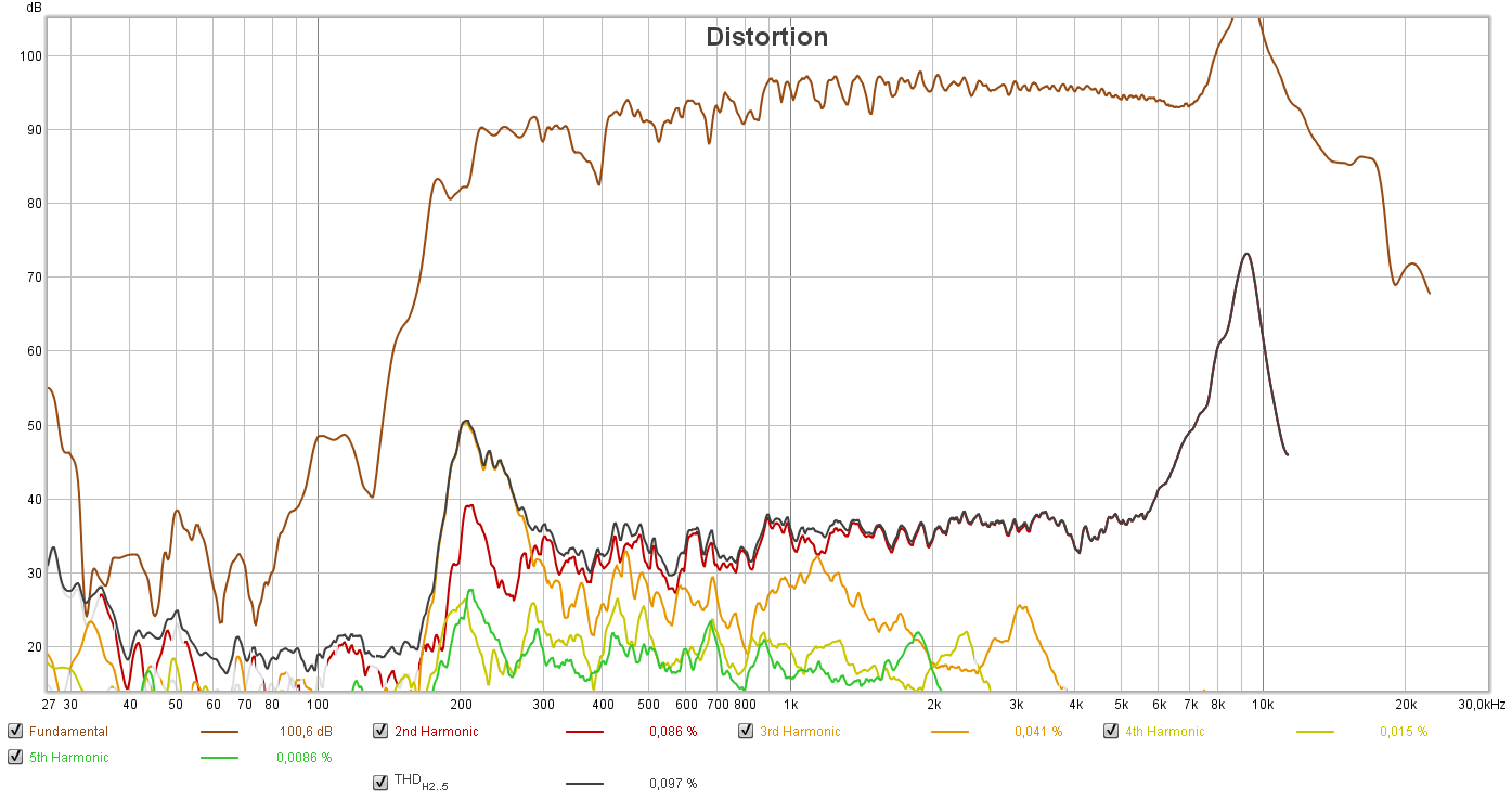

here is a larger midrange distortion measurement @ 96 dB @1 meter, (amplifier could not deliver more back then)

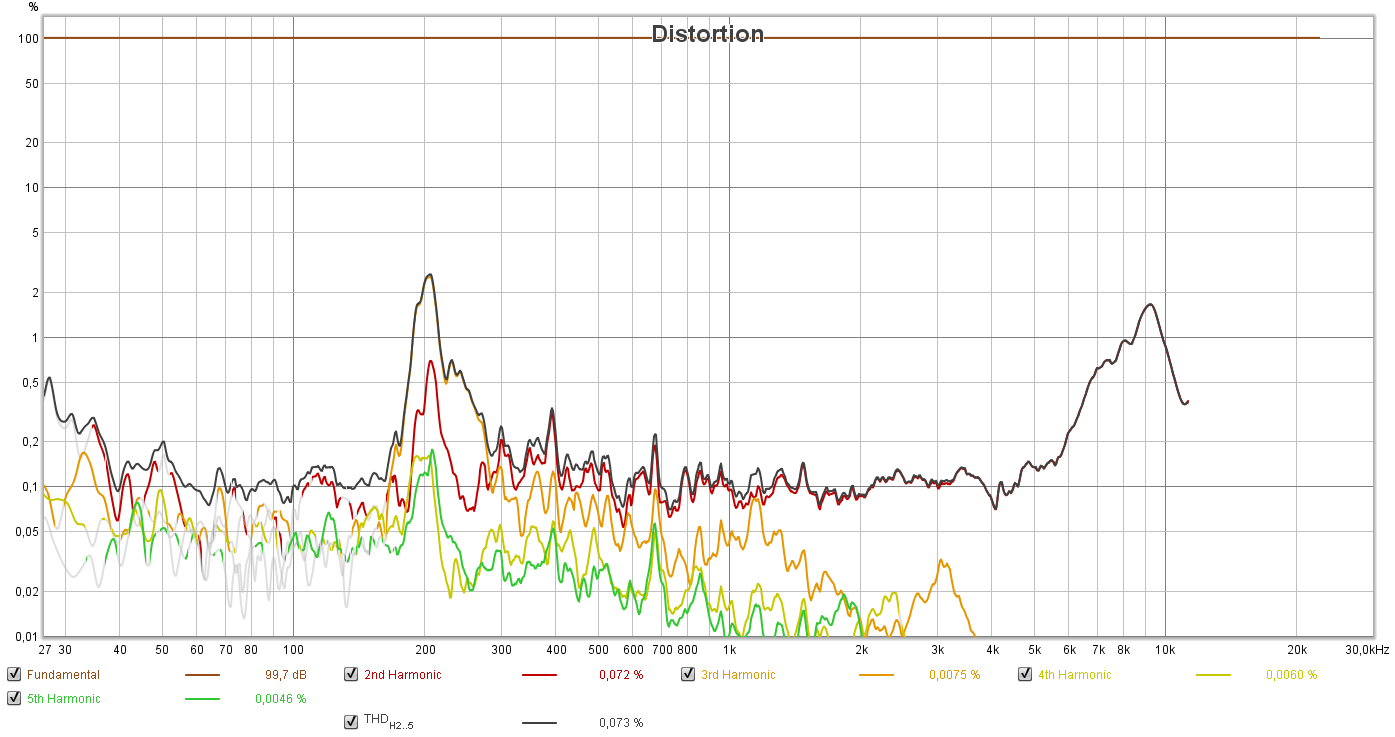

and here when normalized
so in the used bandwith 300-4000hz +- 0.12% THD. but its 6 db louder then the quad test though. so i might even had lower Thd then the quads there.
by the way in that test they used both left and right speaker..... thats unfair so my panel is doing more work
it creates a resonance yes seen here at 205Hz and you also see breakup at 7-9Khz (it also has a cavity resonance at that same spot, so it looks a bit weird)Yes, I agree. It’s all about implementation, if it’s done well.

Does this membrane vibrational modes also occur with ESL membrane? Since it’s driven more uniform across the ESL membrane areait creates a resonance yes seen here at 205Hz and you also see breakup at 7-9Khz (it also has a cavity resonance at that same spot, so it looks a bit weird)
i dont know what PEN is , thinner is useless when you have such heavy coil it results usually in more troubles in dirstortion. tried 6 micron and 3.. 21 works best all around for tweeters and fullrange.Yes, I’ve seen few of your videos. Have you tried thinner mylar or use different materials, such as PEN?
AN ESL has a resonance as well, but not the breakup thing. since its driven on the entire surface.Does this membrane vibrational modes also occur with ESL membrane? Since it’s driven more uniform across the ESL membrane area
When a planar magnetic has coil almost everyhwere on the foil these breakups move up and above the audio range (i do this in tweeters, not useable in bass panels and is related to the width and strength of the magnets used, and the distance from trace to trace.)
