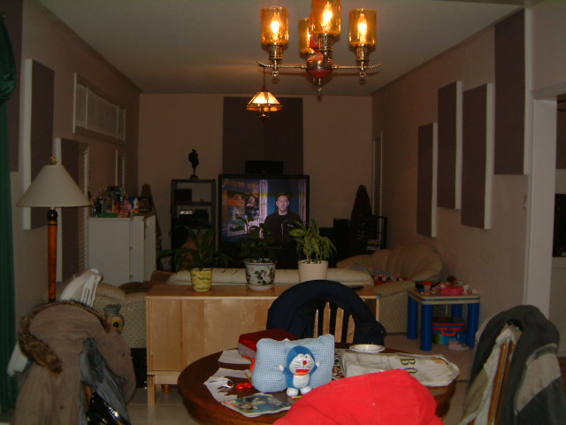

paulspencer said:
What is the benefit of using diffusers as room treatment? In which parts of the room are they best placed? Should they be used for ceilings, and in particular cathedral ceilings? What is their subjective impact, in particular on imaging?
It depends on the use intended for the room. In general
it have been recommended that the ceiling should
be totally dampened and non-reflective surface where
the rear wall can contain some diffuse material.
With my experience however, I prefer fully dampened
room. We have acoustic panels in all walls and ceiling
in our home theater and it works very well with 5.1 material.
It doesn't work with stereo sound source however, the
sound is too dry. But with multichannel in mind, more damping
material is ok and less diffusors are needed.
Our home theater is comparable in reflectivity to local small THX
theater that has quite zero level of audible reflections
(not 100% anechoic if measured, but subjectively anechoic).
Best Wishes,
Karoliina
http://www.karoliinasalminen.com/forums/viewforum.php?f=4
http://www.karoliinasalminen.com/forums/viewforum.php?f=10
While dampening makes a room less reverberant it also "eats" acoustic power which in turn leads to the need for larger speakers and increased amplifier power which isn't only advantageous (larger speakers with worse spatial reproduction, larger THD and IMD, ......).
I recommend reading the parts about spatial reproduction within the following:
http://www.celticaudio.co.uk/technical2.htm
Diffusors can improve audio reproduction by a great deal. Not by killing reverberation but by changeing the reverberation characteristics.
Regards
Charles
