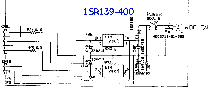

Anyone would have the service manual for the PMC-250 or PMC-250r? One of the diode on the power pcb have blown out and i need to find a replacement for it. I don't know the value..
I think it's written 43T on the diode if it can help..! Anyone?!

Rectifiers rarely die alone. Usually some downstream part shorts-out, killing the rectifier.
I would just use 1N4007. But specifically they used a "fast recovery", which may reduce switching noise. Or may just have been the part they used everywhere; this power supply is very basic no-frills (because no frills really needed to power opamps).
Where it says "DC In" should be "AC In".
