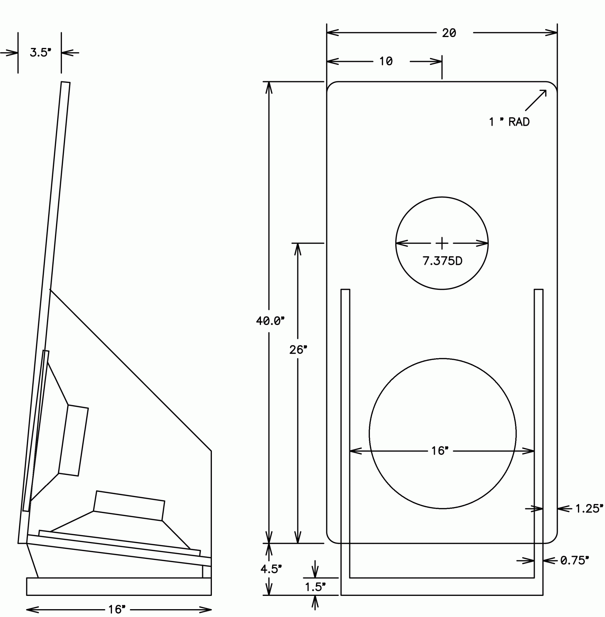

@Studley The Radian Coax in the Birch dipoles is 8" and I wanted to use 15" so the woofers and mid-coax matched in size.
Radian does have a Beryllium 15" coax but the directivity in its top octave is quite a bit narrower compared to the B&C. It's also 2X as expensive. So I chose the B&C with Titanium diaphragm, which has wider dispersion in the top octave. I find this is fairly important.
I had also tried a Beyma 15XA38ND coax, which is a pretty respectable driver, but for some reason the directivity in the 4-7K region is a hot mess. In other words in that octave it didn't have a controlled directivity characteristic, so I abandoned it for the B&C.
As for the "titanium hardness" of the B&C it's only very slight and it also comes down to which amplifier you use as to whether it's noticeable.
ONE OTHER THING: If I were to build these again I would tilt the front panel back 5 degrees instead of 10 degrees. With my couch and listening room, the 10 degree tilt has them firing about 5 degrees above my head. Really not a problem with the B&Cs but it would be a problem with say the Radian 15 or the Beyma 15 coax. Changing to 5 degrees would make it just about perfect.
@perrymarshall so you would change the tilt of the Bitches Brew to 5 degree. Change anything else like the wings (bunching around 100Hz) [shape, parallel] or stay the same with 5 degree? Or change anything else?

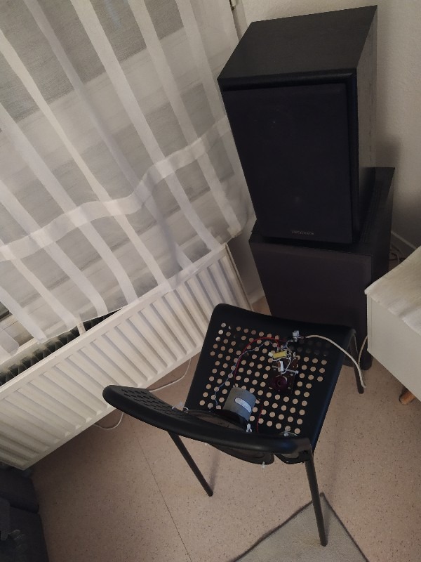

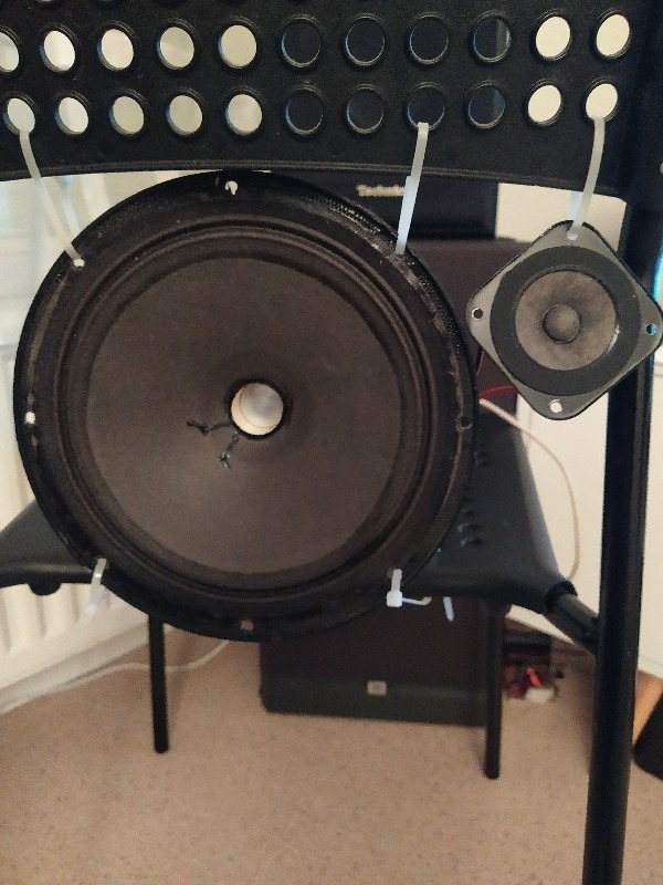

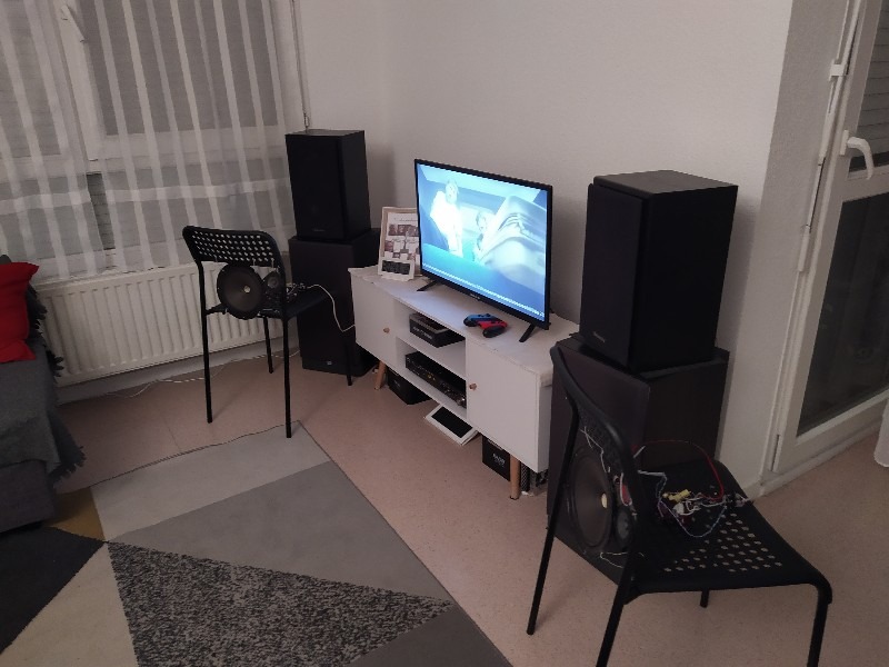

Now for something minimalistic and a bit unusual.
It started as an exepriment, as I got bored by boxed speakers.
I had Open Baffles before 2019, but then I changed residence and the new apatment would not fit the Open Baffles, or at least the ones with an 15" woofers.

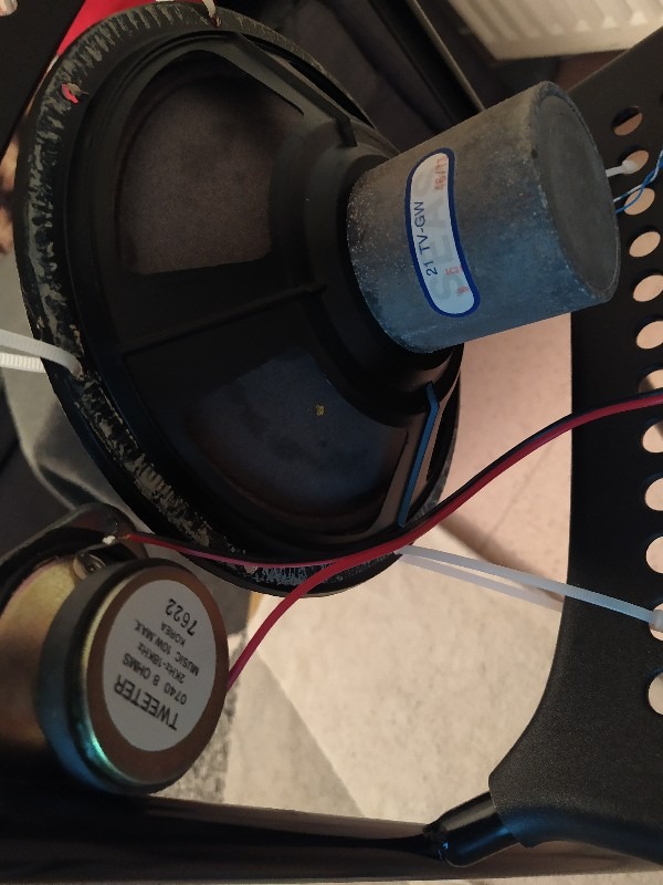

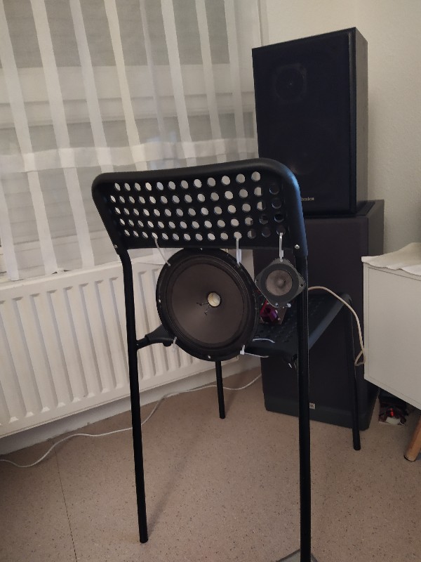

Since I missed the OB sound, and I had some old Seas wide-rangers, I quicky cobbled something, just for fun.
Wide rangers with the helper tweeters, hanged by cable ties on the Ikea chairs, so no-baffle. (And no money too, read extreme frugal)

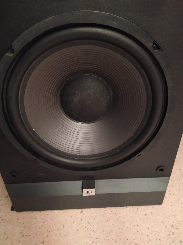

Bottom end is still boxed though. Monarch 250, 10" drivers in old JBL cabinets.
Overall, the idea was to do something that resembles Basszilla, but scaled down. (Should I call it Mini-zilla? :D)
Yeas, it looks ugly. No phase plugs yet, but ugly nevertheless.
The sound?
What the....
WOW.... ;)

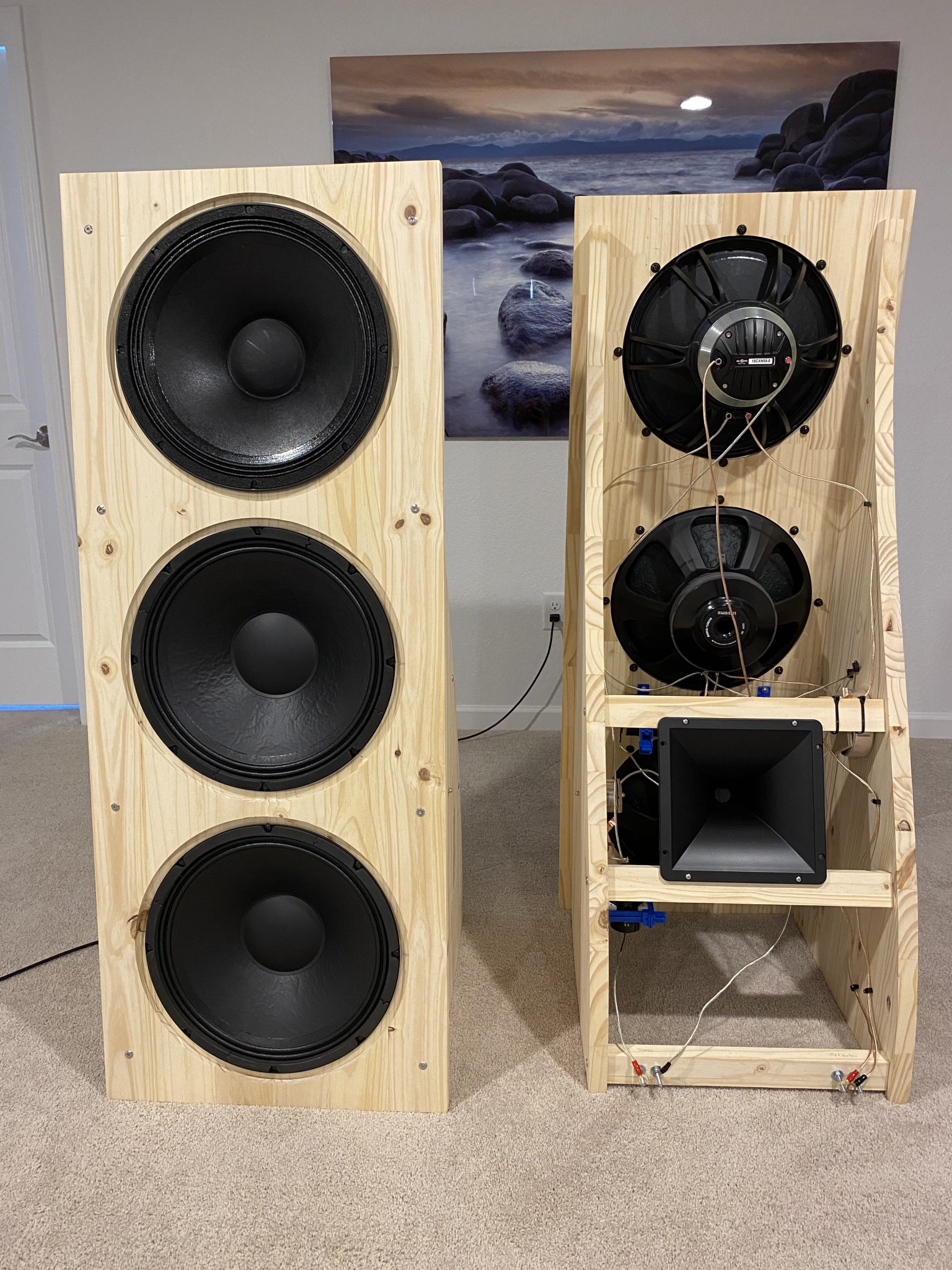

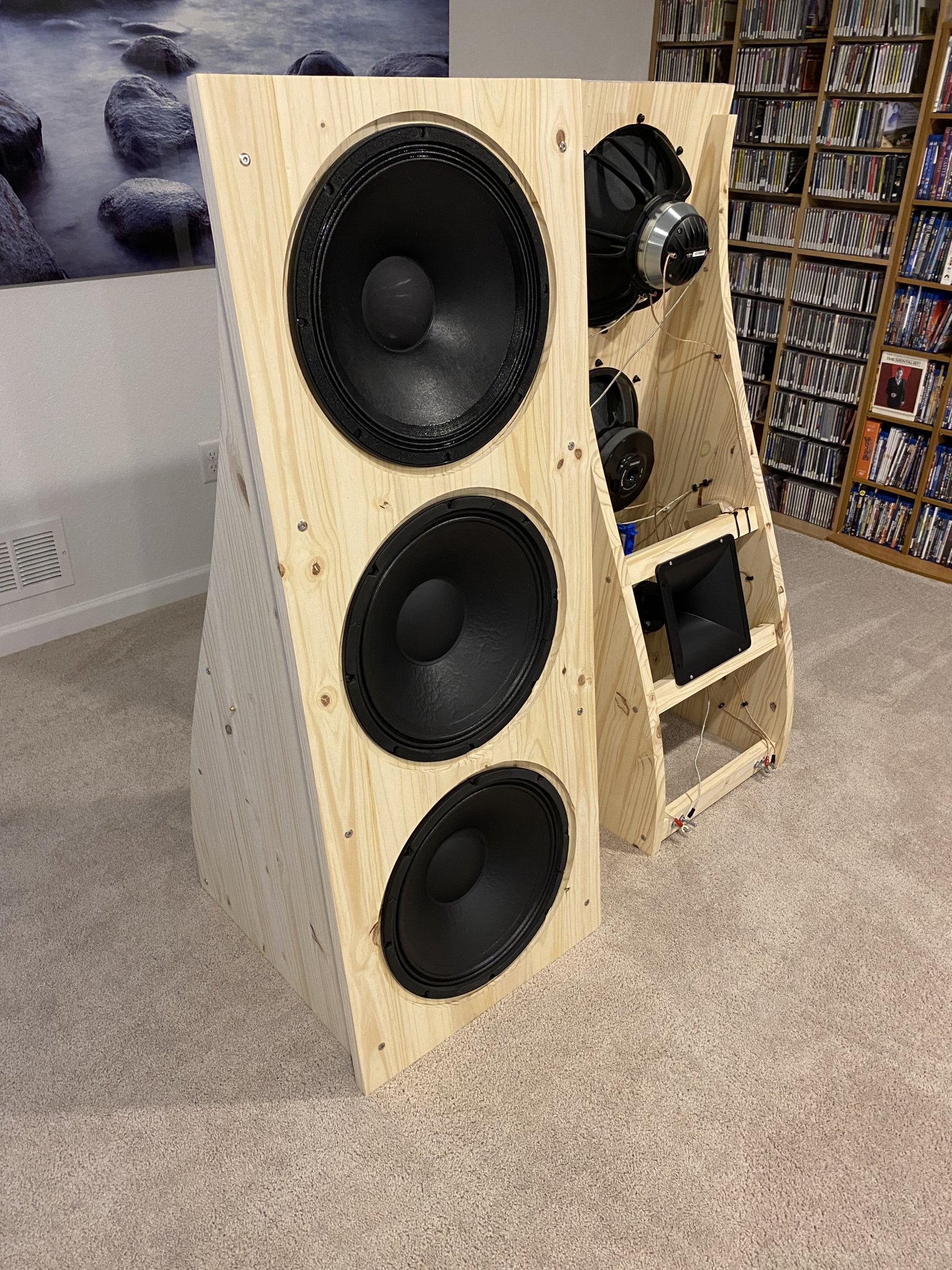

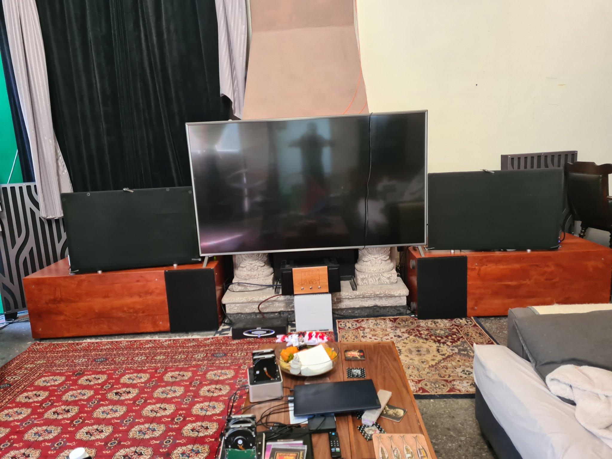

I love the esthetics of the Balthazarp version of Perry Marshall's Bitches Brew speakers. Here is my less esthetic version of the Bitches Brew. The first piece of music I played on them was Mozart's Clarinet Quintet on Calliope with Bohuslav Zahradnik playing clarinet. As it would happen, I'm a semi-pro clarinetist so this piece just made sense. The clarinet's tamber sounded fantastic - far superior to my other not too shabby system. My listening room is in the basement adjacent to my practice room. My wife, a retired clarinetist, who was upstairs at the time, initially thought I was practicing until she figured out the playing was just too good for what I produce. This speaker design is something else.
Reactions: 12 users
Fantastic build, congratulations. Love the story about your clarinetist wife. Do tell us more as you dial these in to your room, your equipment and your listening tastes.

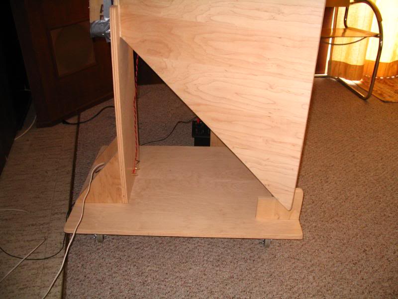

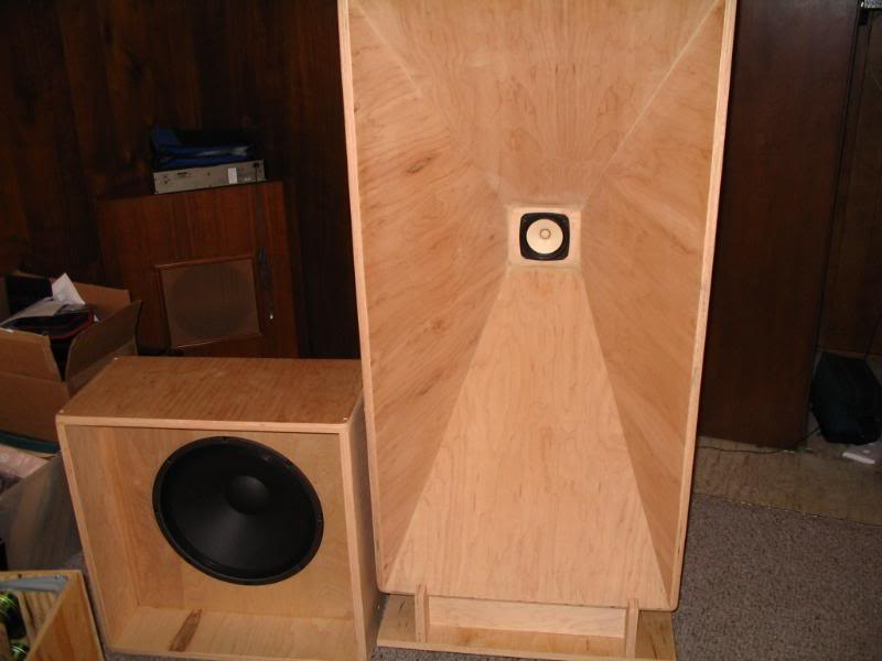

These were made by a local audionut near me back in Michigan. Those are Fostex full range drivers completely open in the back. The woofs are A15s. When I got them, they sounded very good but in time I realized they lacked midrange, so I built boxes to enclose the back of the Fostexs. Then I stained and cleared them. They really came alive. Needles to say, it was a very large sound!!!
