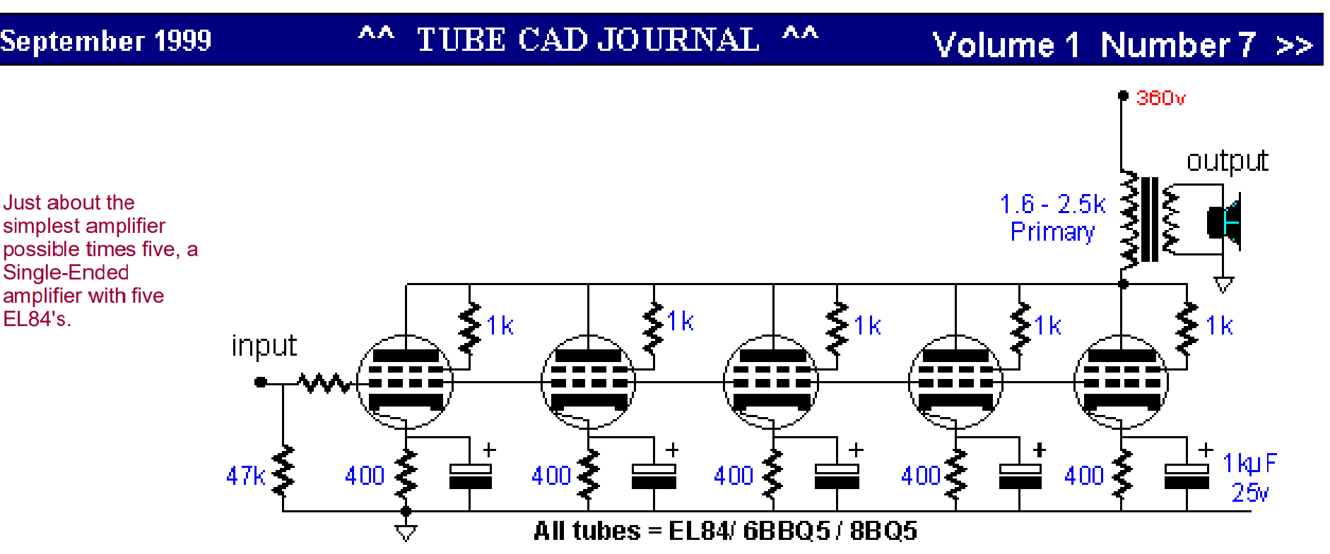

I've gone through this thought process recently for that old Broskie 10 tube EL84 amp. Once you get the current and voltage to reasonable levels then you have many options without resorting to giant heat sinks, giant transformers etc.

I read somewhere that series heater strings prefer current regulation. I'm still deciding best way to heat 10 EL84's for the Broskie amp in one of his very early articles:
