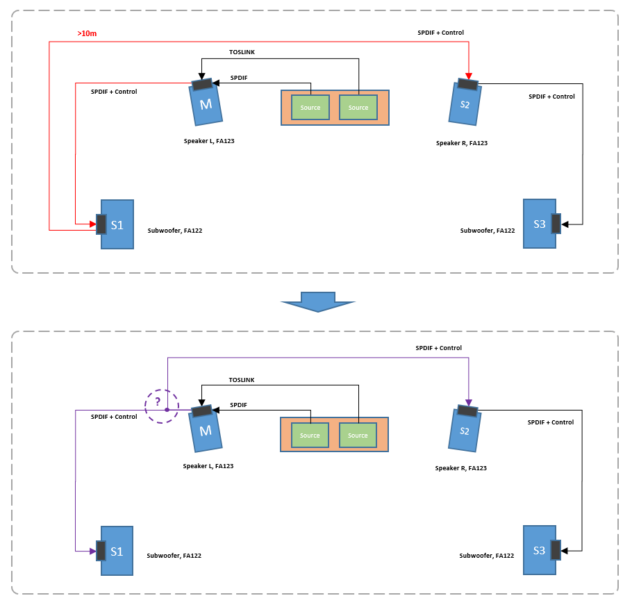

Hi all, does anyone know or has tried what happens when the SP/DIF Output of the Fusion master module is just splitted to two individual slave modules via Y-adapter instead of daisychaining? Will everything - especially volume control - work this way though this mode is out of specification? That may help to avoid some meters of cables....
Thanks!
Best Regards
Peter

Y-adapter is not very good idea as SPDIF interface is made for 75 ohm impedance cables/lines. When Y-adapter is on the line, impedance cannot be any more 75 ohm. But SPDIF receivers can be so sensible (usually they are) that signal will go thru and will not be lost, only "little" jitter will be added. It means you newer konw without testing. If SPDIF generally will work (sound goes thru) then also volume control will work as it is implemented on the SPDIF software layer.
