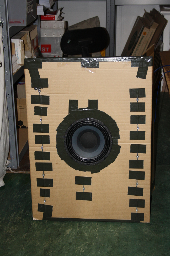

Openly Baffled.....
Yes, I know the Beta 10cx is a poor choice for an open baffle but they turned up and my workshop is closed for 2 weeks and I couldn't help myself.....
So, cardboard, gaffer tape and paper fasteners to the rescue. Voila! Instant OB so I can at least listen to them.
I elected to try them out in the Eminence endorsed arrangement with an ASD1001 and the PXB2:2K5CX crossover and bought 4 sets as a trial run.
The crossovers are the best made I have ever seen.
So how do they sound? Well, it is a speaker with a QTS of 0.39 in an undesigned OB. So, weak bass extension is a given.
They sounded appalling when I first started them up, midrange shrieking like a banshee and a top end that was soft and hard at the same time. The sinking feeling we all know and dread - have I backed a dud?
Well, they got better of course. They still only have a few hours on them, and I am not yet sure they are quite 'Hi-Fi' in terms of stored energy and HD but there is no denying they are very efficient and seem to have tremendous dynamic range and resolution of detail. What bass there is, is very tuneful with great pitch definition which gives me hope for the MLTLs I plan to put them in.
I will report back after they have run in a bit more (hoping the midrange shout continues to abate and the tweeter smooths out).
blakkshepeaudio

Maybe you are hearing the peak in the mid that comes from the typical OB response. It's directly related to baffle size. It needs to be equalised ( preferably actively) or accounted for in some way.
I have a CX10 with ASD1001 on a smaller baffle.Eminence crossover. I really don't hear any mid range shout ! But mine does need EQ for the LF . Maybe you should measure the response. I will but haven't got round to it. The CX12 audibly has more LF extension on a slightly larger baffle than the CX10. But I thought the mid on the CX10 was preferable.
You could well be right ashok. I have very limited experience with cone driver OBs.
I am sure the 'hyper-flex' cardboard construction doesn't help either.
There are just too many variables at this stage to make much of a call - I won't bother to measure them until I get them in a proper enclosure.
Early signs are encouraging and I couldn't help but share my alcohol assisted enthusiasm with like minded prototypers !

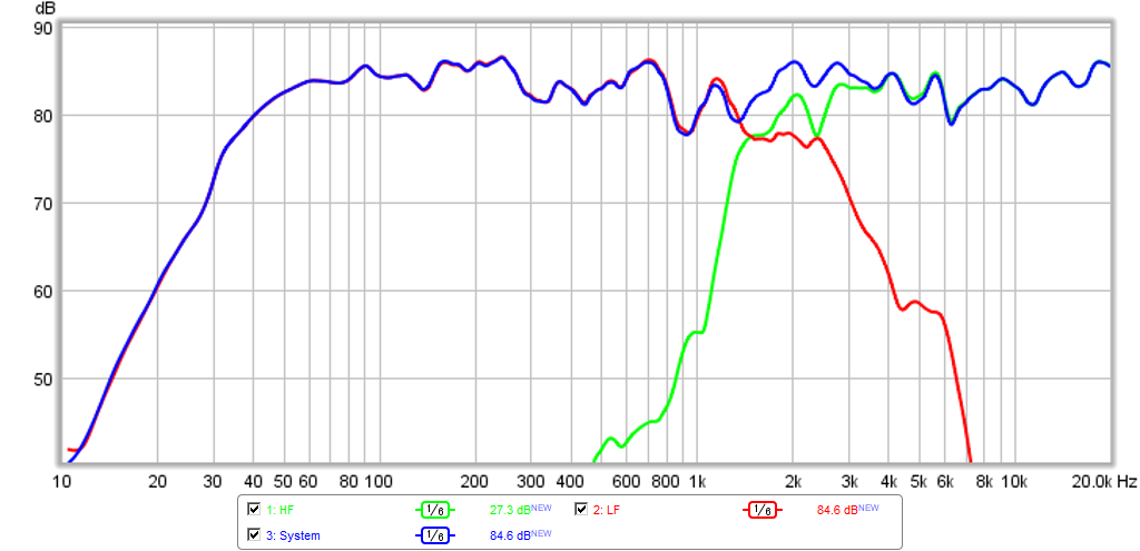

Here is something I did with the Beta 10cx's little brother, the 8cx (same motor, btw).
http://www.diyaudio.com/forums/full...-aperture-z-baffle-dipole-19.html#post4377787
It's a dual Beta 8cx Z-baffle dipole with compression driver on one of the drivers, and a Karlson aperture for slot loading and for deep bass extension for a dipole.
It sounds really nice, and happens to be quasi-transient perfect with a miniDSP XO.
That's my advanced foam core-triple-ply-foam core sandwich construction (3M 777 adhesive on all with latex caulking on baffle for CLD).
Impulse and Step Response:
Sound Clip - Have a listen (change .asc to .mp3):
http://www.diyaudio.com/forums/atta...-aperture-z-baffle-dipole-kazba-beta8cx-2.asc
