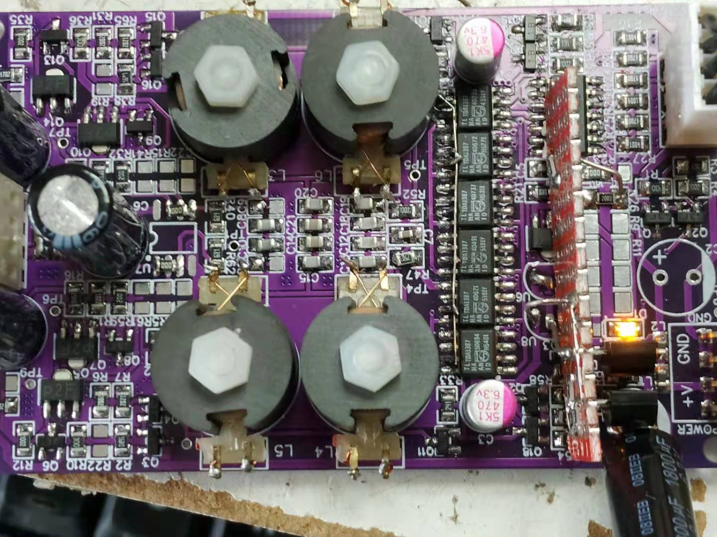

As some of the apparent advantages of TDA1545 seem to have evaporated on closer inspection, I decided to try fiddling about with the pin7 voltage on TDA1387. Many years ago I blew up one or two chips by trying this so that put me off attempting this trick for quite some time. But I figured not much to lose, especially as I have a bag of what I call 'underperforming' 1387s which output below 90% of the typical 1mA the DS stipulates.
The first step to understanding pin7 I figured was to determine the impedance at the pin. I did this by connecting a high valued resistor (100k) from pin7 to VDD and writing down the voltage change then some Thevenin math. It turns out the answer is 11kohm - a very familiar number to anyone who's studied the TDA1545 DS. I averaged this number over 6 chips. Next was to see if I could coax my underperforming chips to give me 1.5mA swing, rather than their default between 0.86 and 0.9. Turns out they can, at least at the max recommended supply of 5.5V. But 'can they do it cleanly?' is the next question, first check was with my 'scope on FFT and at least there wasn't gross distortion (it was below -50dB for sure). Then lastly, how do they sound when 'overclocked' by more than 50%? That's still being determined...
Here's the first overclocked variant of Abbado - the vertical thin wire running down the lefthand side of the DACs joins all pin7s together. The reason for the extra 90-degree red perfboard is because overclocked chips take much more current which would overheat the resistors feeding the shunt reg. I need 6 1206 resistors rather than 4 which the PCB provides for.
