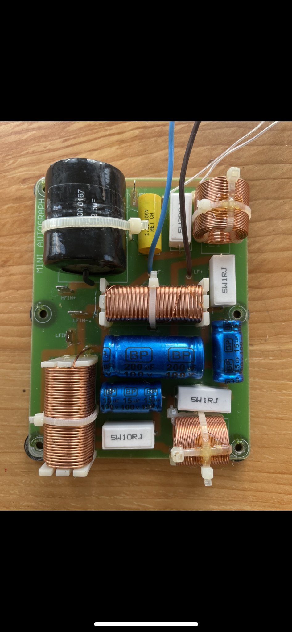

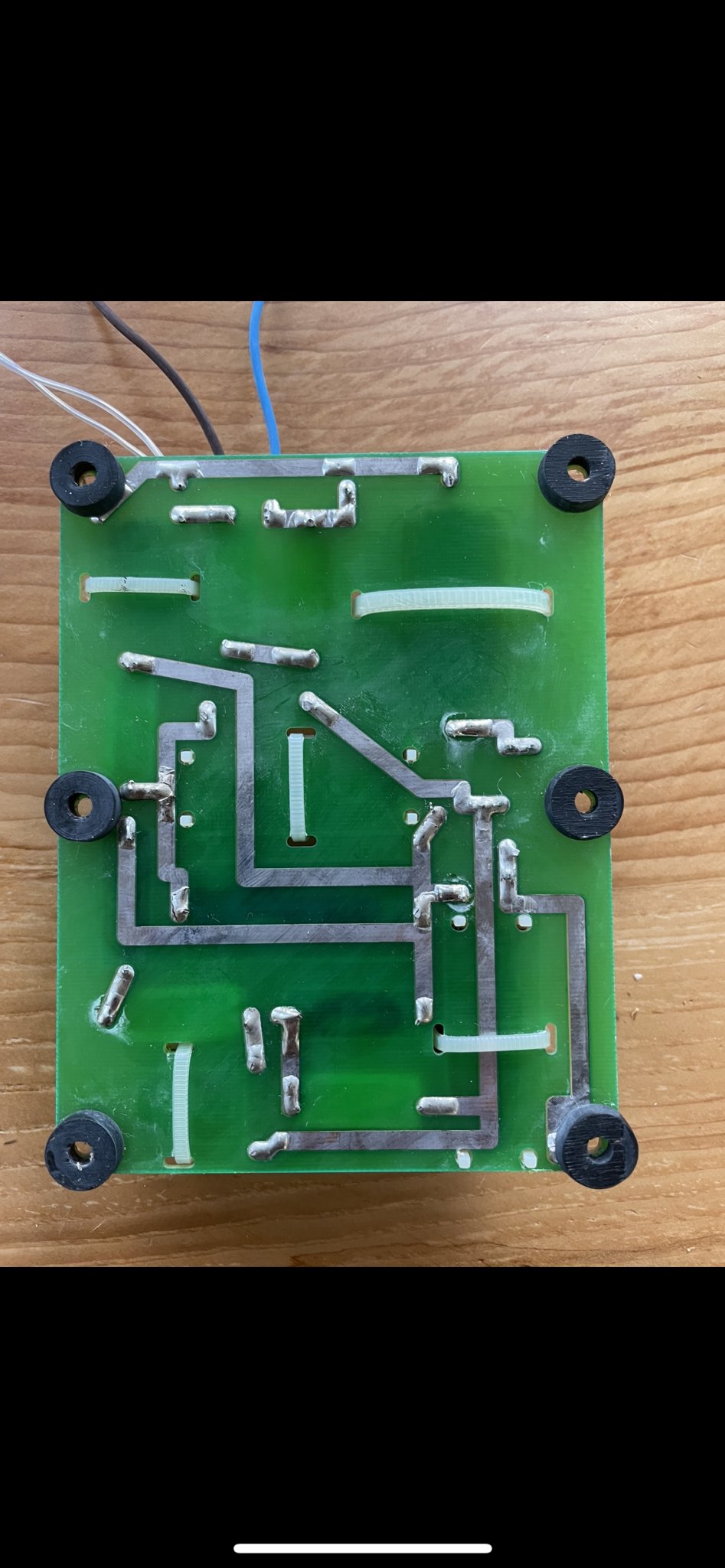

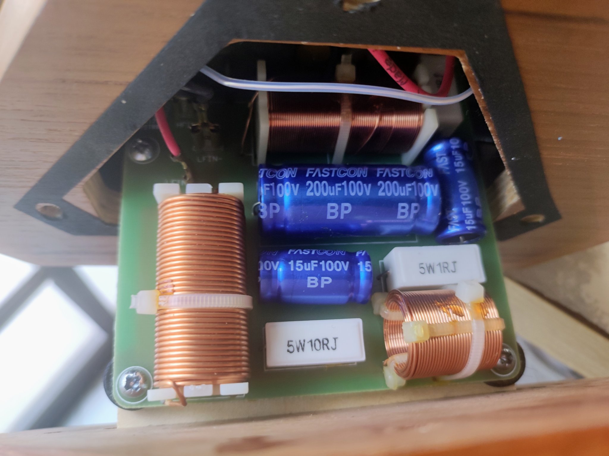

@planet10 , sorry to necro this thread, but I found most of the crossover values as follows:
https://www.hifiwigwam.com/threads/help-figuring-out-tannoy-autograph-mini-crossover.111526/
Three questions. Firstly, why the Linkwitz XO? This was one of the responses received in terms of pairing it with the Tannoy Autograph Mini drivers when it was raised as a possibility, based on the information you've provided here.
Second question, other people seem to advocate running the Autograph Mini drivers with MiniDSP 2x4 HD. What are your thoughts on that?
Finally, third question, if not the default enclosure parameters, what type of enclosure for a 4" driver would you recommend? Or does this require measuring the frequency response of the driver, and adapting accordingly?
This is an analogue active crossover designed by Nelson Pass that has a crossover frequency and response curve specifically tailored to match the LX Mini speaker. Looking at the response curve in Nelson's article, the xover frequency is about 750 Hz. As I have already said once in this thread, the Autograph Mini drivers need the xover frequency to be around the 2500 Hz mark (Tannoy actually uses 2300 I believe), so this design would be totally unsuitable for use with the Autograph Mini drivers for that reason alone. The carefully crafted frequency response of the crossover as designed would also not be a match for the Tannoys. You would be wasting your money if you took that advice.

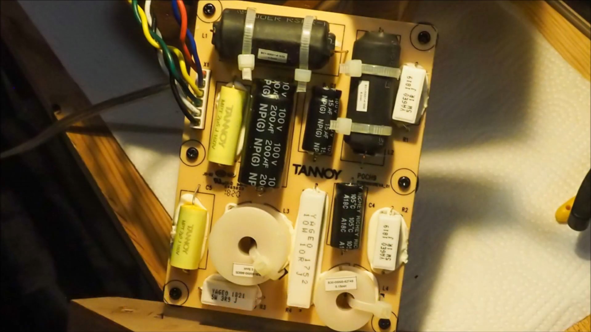

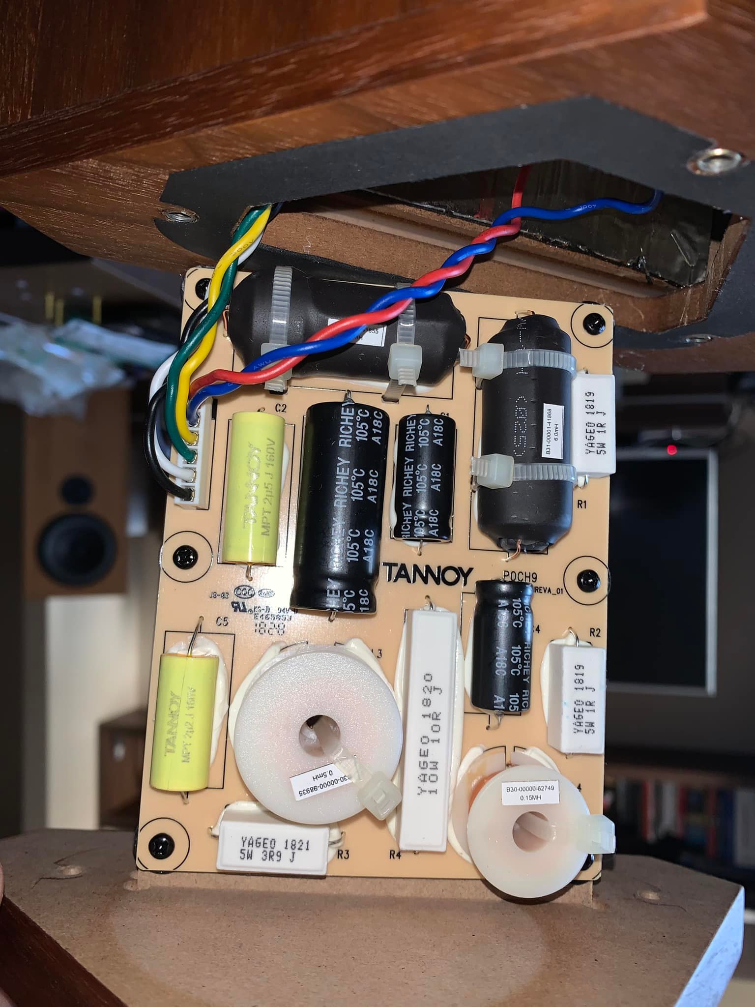

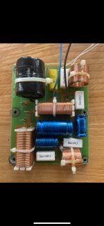

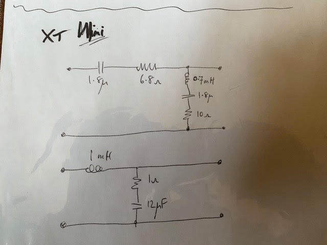

@planet10 , thank you for your response! Admittedly, I don't really know what that means, and I am of the impression that the crossover may need to vary significantly if I go for a different enclosure size.
My impression is that you said you weren't impressed with Tannoy's default offering, and I was curious to hear what other enclosure you would potentially recommend for these 4 inch drivers.
It should be noted the 'XT Mini' crossover schematic is for a cheaper (but similar-ish) speaker in the Tannoy series, as compared to the Autograph Mini. The idea was that with both being dual concentric, perhaps there would be similarities in the design.
However just about everything else relates to the Autograph Mini and its crossover.
