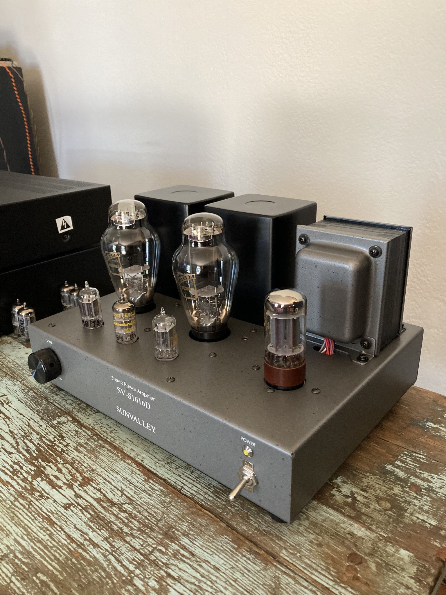

After finally getting into the box and seeing what I had to work with in terms of any upgrades, I decided to do the following ;
Upgraded the resistors to PRP.
Using a single 1.2k ohm 10w MIlls instead of the parallel 2.4K 5w. Mills resistor on the other 5w wirewound.
Nichicon capacitors, audio grade (FG or KZ) where I could get them.
WBT binding posts. Vampire copper base RCAs.
Will bypass potentiometer. BTW Parts Connexion has a great sounding Audio Note 100k pot. using in my preamp and reasonably priced (compared to TKD).
Maybe a helpful observation for builders and upgraders ;
The dual binding post cutout precludes mounting them as singles without doing some modification to the chassis.
The excellent instruction manual has a fused AC inlet (bad IMO) in that build.
The kit has a seperate AC inlet and fuse holder (good IMO). I did not notice an indication of the change in the manuel.
Will stick with the same wire, but silver wire like rwind 4197 did sound like a great upgrade.
Will update when done

Just a follow up on the SV S1616D. Got it with with WE 300B, Brimar driver tubes, Audio Note caps. Used Takman REY, PRP and Mills resistors, Nichicon electrolytics, WBT binding posts and DH Labs RCAs. Belton audiophile sockets. I will preface by saying it is my first SET amp so I don't have a great comparison, but it sounds wonderful. Great high frequency detail without any shrillness. Liquid midrange and good bass with plenty of power in my 92dB speakers. Quiet for tube amp.
Sound exceeds my other amps by far.
Very happy with result and thanks again Victor.

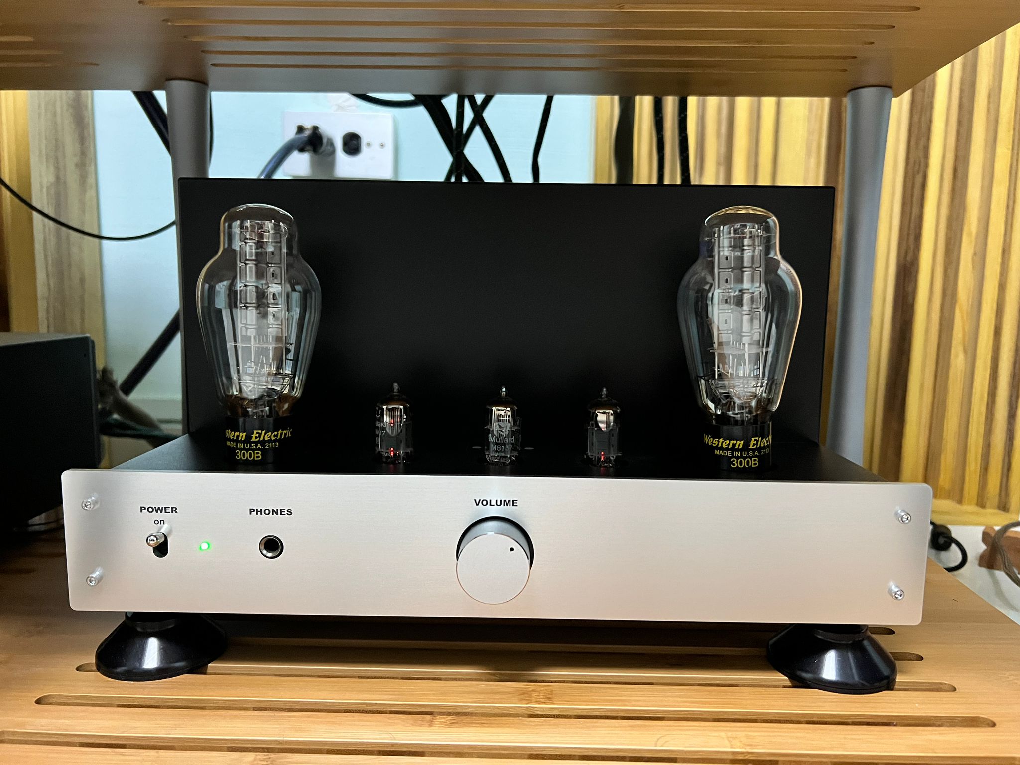

I used a Furutech IEC and VH RCA which I believe are "standard" size. The cutout for the speakers terminals are a double. The only ones I found were WBT besides similar ones that were supplied with the kit. Despite the cost they are worth it. I also used Belden audiophile tube sockets which I also recommend.
I found the supplied wire a little fragile for my clumsy fingers and used a little heavier gauge PTFE and Mogami.
I will echo Victor that the components supplied are of high quality and WE 300Bs are the best.
He is great to deal with as well
Hope that helps. BTW what speakers did you get ?

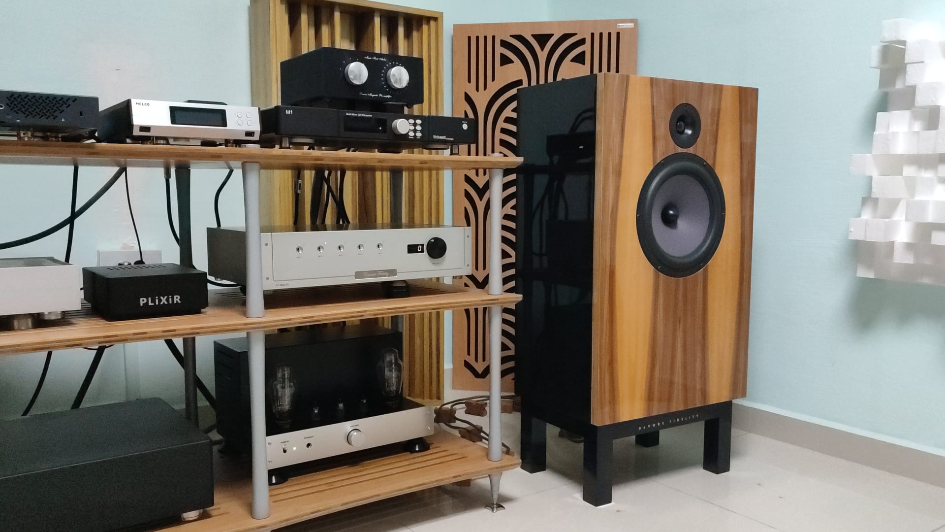

Hi, much appreciated on the info! I got the Devore O/96
Very nice choice of speakers and on my most wanted list. They should pair wonderfully if you decided on the SV 1616D.
