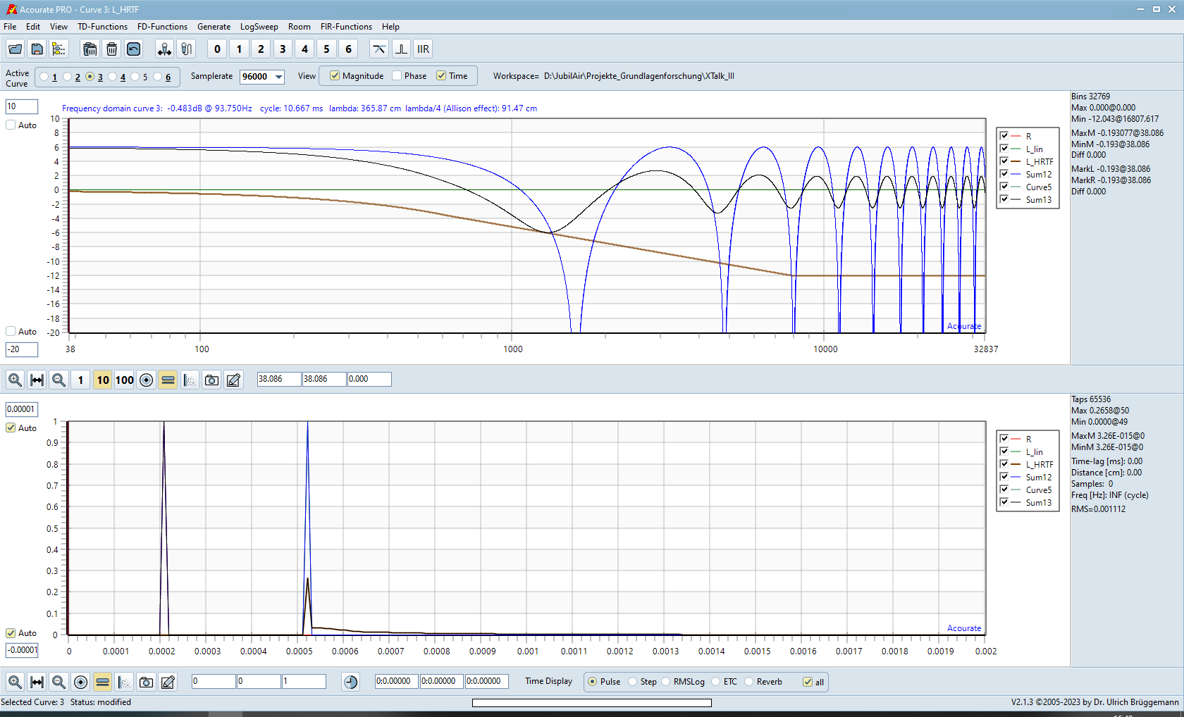

I chose to make the measurement without convolving a HRTF into the L (crossing) signal. Still, the results would have been similarly interpreted: The less ripple in the summed signal, the better the XTC is working. With HRTF, the ripple would have shown up differently and less intensly. The graph shows a syntesized difference between xtalk summing to direct signal with, and without HRTF

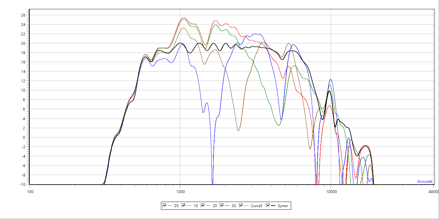

sorry, having hard time to understand so you played mono signal over both speakers L and R at the same time. You first measure in the centre position(black line). And then move sideways to position of ear(red line) also playing mono over L and R ?I measured the SPL of the combined mono L+R signals. R is direct sound, L is the X-Path. If there is no X-Path signal arriving at the mic, then either there is no signal on the line (as the reference, black data points on my last graph), or the X-Path signal has been completely absorbed and/or deflected. The better the XTC works, the more the red line merges into the black line. In case of a straight reference frequency response then, there would be no ripple on the summed signal: 1+0=1
Yes. This is shown in the very first graph. The first center, sound path symmetric measurement correspond to black line. Then the mic was incrementally and laterally shifted to the right at positions of 5, 10, 20 and 30 samples delta between the left and the right sound paths. 30 samples pathway delta between left and right corresponds to approx. 11cm microphone distance from the center line. Which would more or less correspond to the right ear position if the nose was on the center line. The measurement at this spot is shown by the blue line (labeled '30'). The notches of this blue line more or less nicely fits the notches of the HRTF-inclusion simulation for two pulses at 30 samples offset:

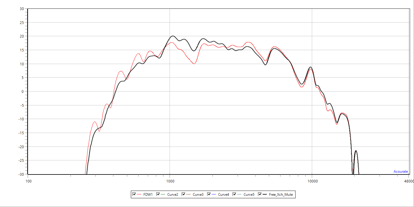

This other graph instead shows both measurements at 30 samples mic offset position to the right:
Black is free field, no obstacles in the sound paths, with the left channel muted.
Red is with a setup of a tube deflectors and a board absorber placed inline in the stereo triangle center line, e.g. symetrically affecting all sound paths, with both channels mono.
Now i understand. Strange for me that you get such similar curves black and red. If curves are the same so it means indirect path is completely eliminated. How is that possible? Measure with mic in ear position indirect path.only indirect speaker should play. And then measure just without deflectors. So you can see attenuation provided by deflectors. Anyway are you going to use stereo with these physical barriers?
The frequency of the lowest notch is 1600Hz, therefore lambda is 21.4cm. The obturating/deflecting monster tube had a diameter of 50cm, which is more than twice the wavelenght at the notch frequency. Therefore, such a tube certainly has the potential to be acoustically very effective for this frequency, causing at it's curved surface a strong dispersion away from the x-pathway.... similar curves black and red. If curves are the same so it means indirect path is completely eliminated. How is that possible?
As said, the (acoustically hard, therefore deflecting) tube was placed in variants of some 30cm ... 35cm in front of the measurement baseline, which nearly completely eliminated this 1600Hz notch. But it strangely enough, the 8kHz notch was unaffected and remained nearly as deep as without the tube. This upper notch then could be eliminated by an additional vertical, absorbtive board placed on the stereo triangle symmetry line between the tub and the measurement baseline.
This effective setup is nothing but a promising finding. But it's certainly not suited for everyday use.... are you going to use stereo with these physical barriers?
Last not least, I should check with real fullrange speakers having a wider dimension (think of the baffle edge diffraction effects), while placing the microphone at a regular hearing height of approx. 1.15m or so. This will include the influence of the floor reflection to be further checked for. And as for the OAF (Optical Acceptance Factor), I also should eventually check with two symetrically placed, smaller tubes instead of this huge monster right in front of your eyes. For such a twin-tube setup, eventually tubes of 25cm diameter could do the job. 25cm, because this diameter is still above lambda at the first notch, and therefore acoustically effective enough to provide an effective enough diffraction.
