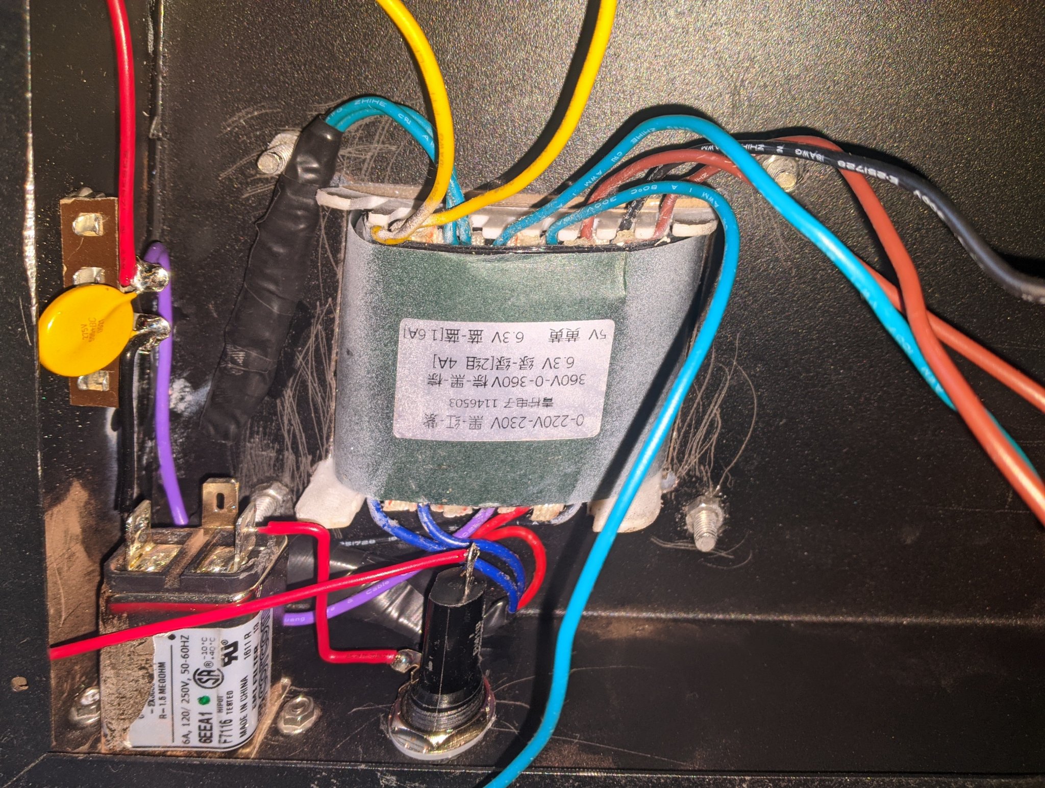

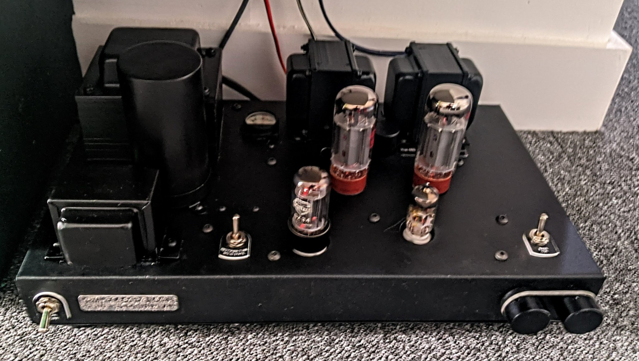

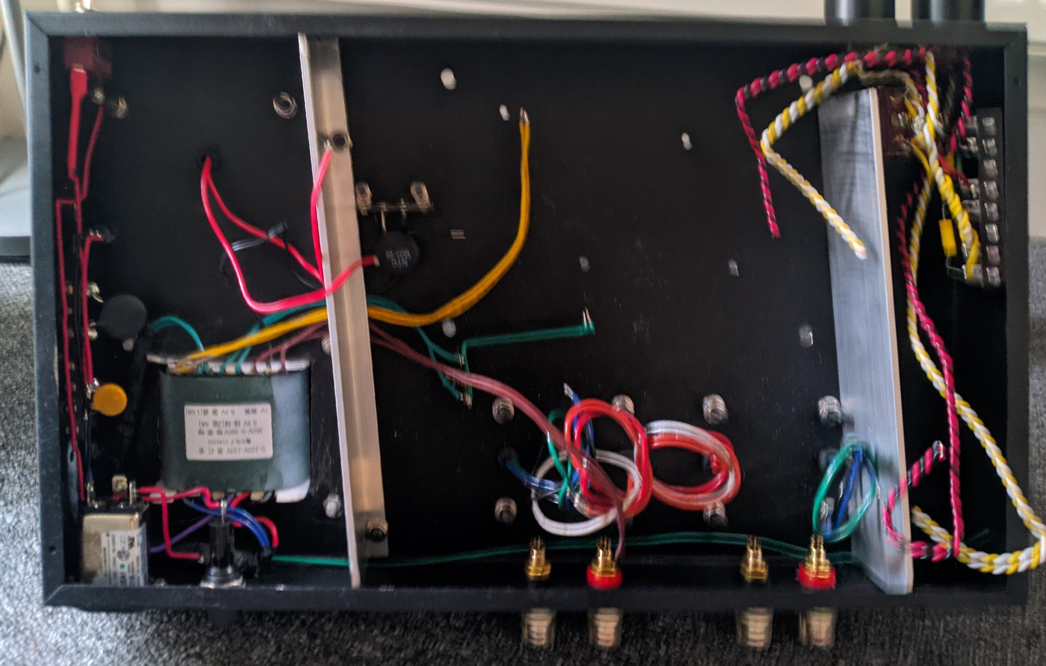

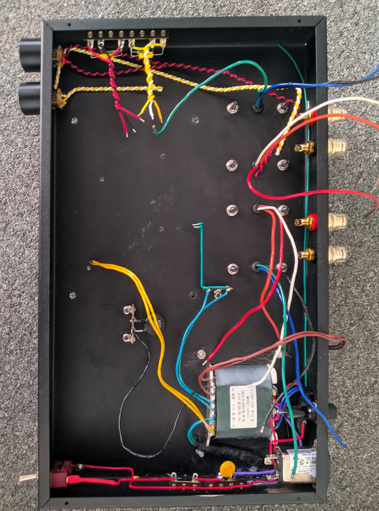

Just begun building my SSE amplifier.
Using 360-0-360 @0.4amps, 2x6.3v @ 4a, 1x5v @ 4amps transformer from 230v at 50hz.
Here we have a steady 240v AC supply here rather than 230v so I guess that'll increase the output a bit to 375-0-375
SSE OPTs (not push pull) at 5k with taps @ 1.5k/3.5k so hopefully I can utilise UL
100uf run capacitor
5h choke impedance somewhere between 50-100 ohms - not arrived yet so unsure. Does the impedance matter?
Planning on having independent volume controls for each channel to allow balancing of tubed if they are not matched well.
EL34's for output valves, just cheapies from China initially.
100uf run capacitor

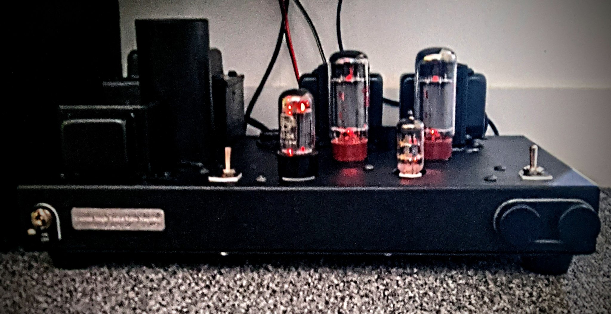

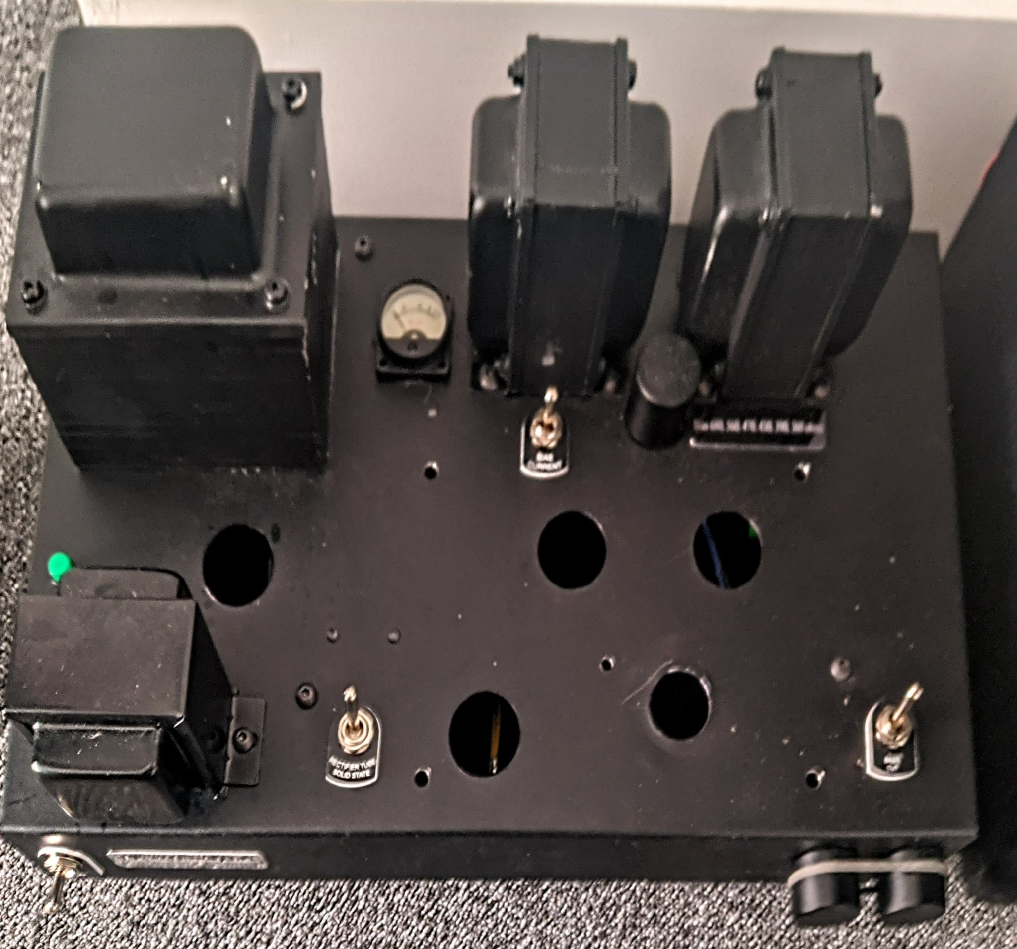

CheersYou are in for a treat. I built two with switchable voltage and bias, the flexibility and sound is incredible. Value for money in spades. Good luck.
I am looking at bias adjustment via a rotary switch and resistors in parallel with a 680 resistor.
What was the switchable voltage you did? Or was it just bias resistor changes like I am thinking?
First build I put a DPDT switch with 275 & 300. I get 310, 340 & 360v with either SS or tube rectifier.
Second build has 300 & 350. I get 340, 360, 390 & 410v with either SS or tube rectifier.
- The higher voltages work with Russian 6P3S-e & EL34 at 560R.
Please try UL /Triode switching. Earlier I didn't like Triode, but with 560R it sounds great. I'm running Altec speakers but can't say if that makes the difference.
- 340v for 6V6 | Vk ~23.4v | 680R
- 360v for 807, 6L6GC, 5933 | Vk ~27-30v | 680R /560R (560 sounds superb)
I understand what you did now. CheersFirst build I put a DPDT switch with 275 & 300. I get 310, 340 & 360v with either SS or tube rectifier.

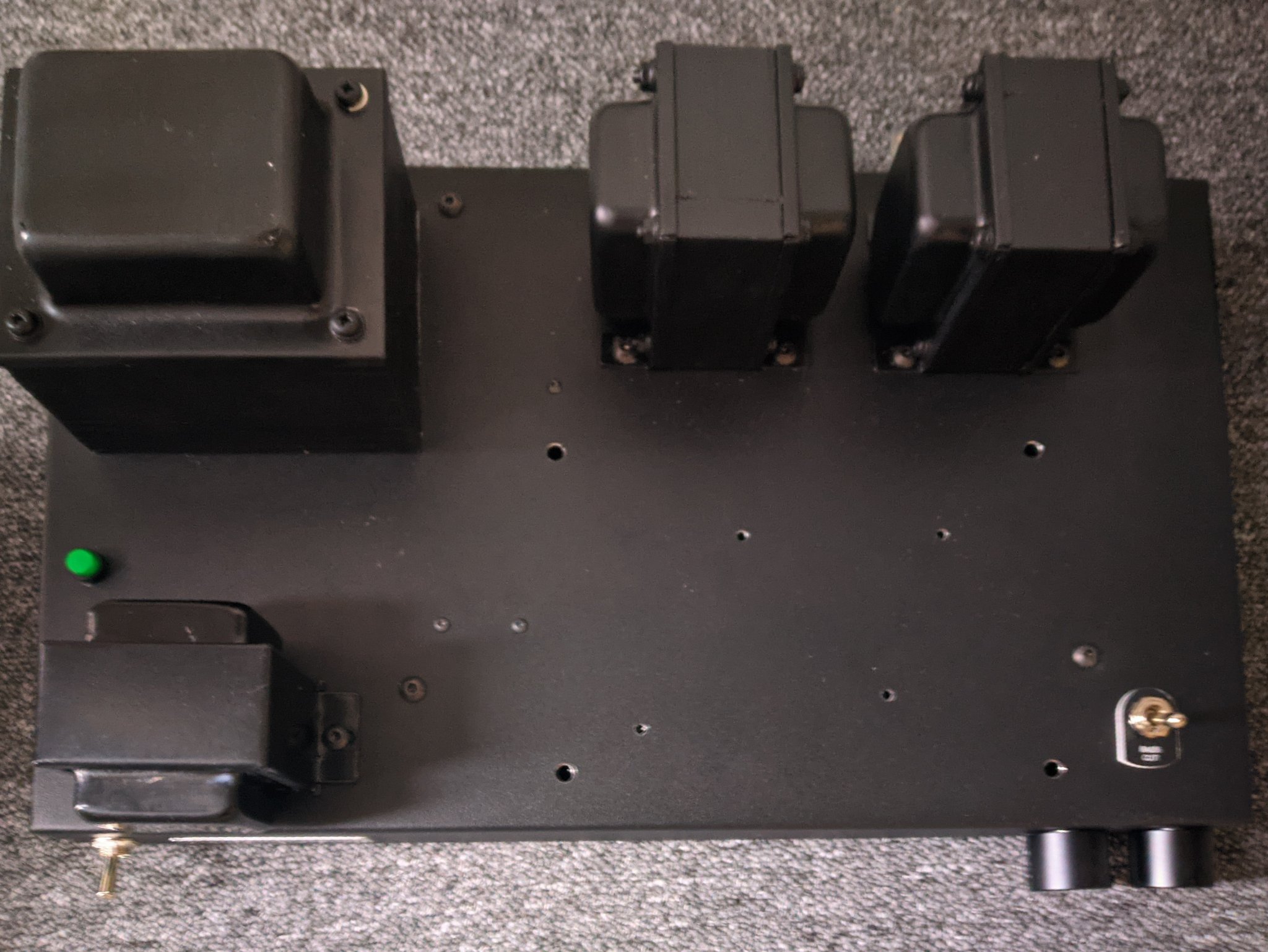

Cheers, yes getting there. Waiting on chassis punches at the moment. Once they arrive hopefully I can make some more progress.Looks like you're getting about eyeball deep. Looking good. Getting a station ready to start my own.
