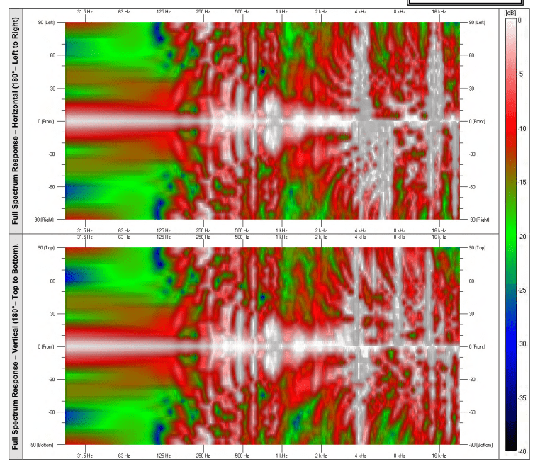

Generally, the picture is more murky when you consider the directivity of your loudspeakers vs. frequency (and where you've chosen to put them in relation to the room's walls, floor and ceiling). For any direct radiating loudspeakers, generally, they don't do a very good job of controlling their polars below ~800-1500 Hz--and perhaps higher. For corner horn loudspeakers, they may control their polars all the way down to the room's Schroeder frequency (about 100-200 Hz for medium-damped or lightly damped rooms). So with these type of loudspeakers, nearfield absorption/diffusion is much less of a concern and is easy to achieve with perhaps 12 ft^2 of absorption on the side walls. It may take 6 times that amount of nearfield absorption on the surrounding walls for a loudspeaker that doesn't control its polars below 1-1.5 kHz.
Note that Flaesh above posted a plot of desired room treatment type vs. frequency--absorption for low frequencies and diffusion for high frequencies. Unfortunately, once you place absorption in-room for low frequencies, generally, the absorbers usually get more and more effective as the frequency rises. So, again, there are complications.
So you can, fairly straightforwardly, calculate the amount of surface area absorption needed (away from the loudspeakers--at least 2 wavelengths at the lowest frequency you want to acoustically treat). But the nearfield absorption/diffusion needed is not so straightforward--because of the loudspeaker directivity issue described above. It's pretty much cut-and-try until you reach something that's a good compromise, I've found. This is not easy to calculate because of geometries and loudspeaker directivities, as well as absorption material effectiveness vs. frequency and by thickness of the absorption material.
In general, the more broad-band diffusion you add the better the resulting sound in-room, but the limit of what your ears want is usually far in excess of what people want to spend on diffusion panels and what it looks like when you're done.

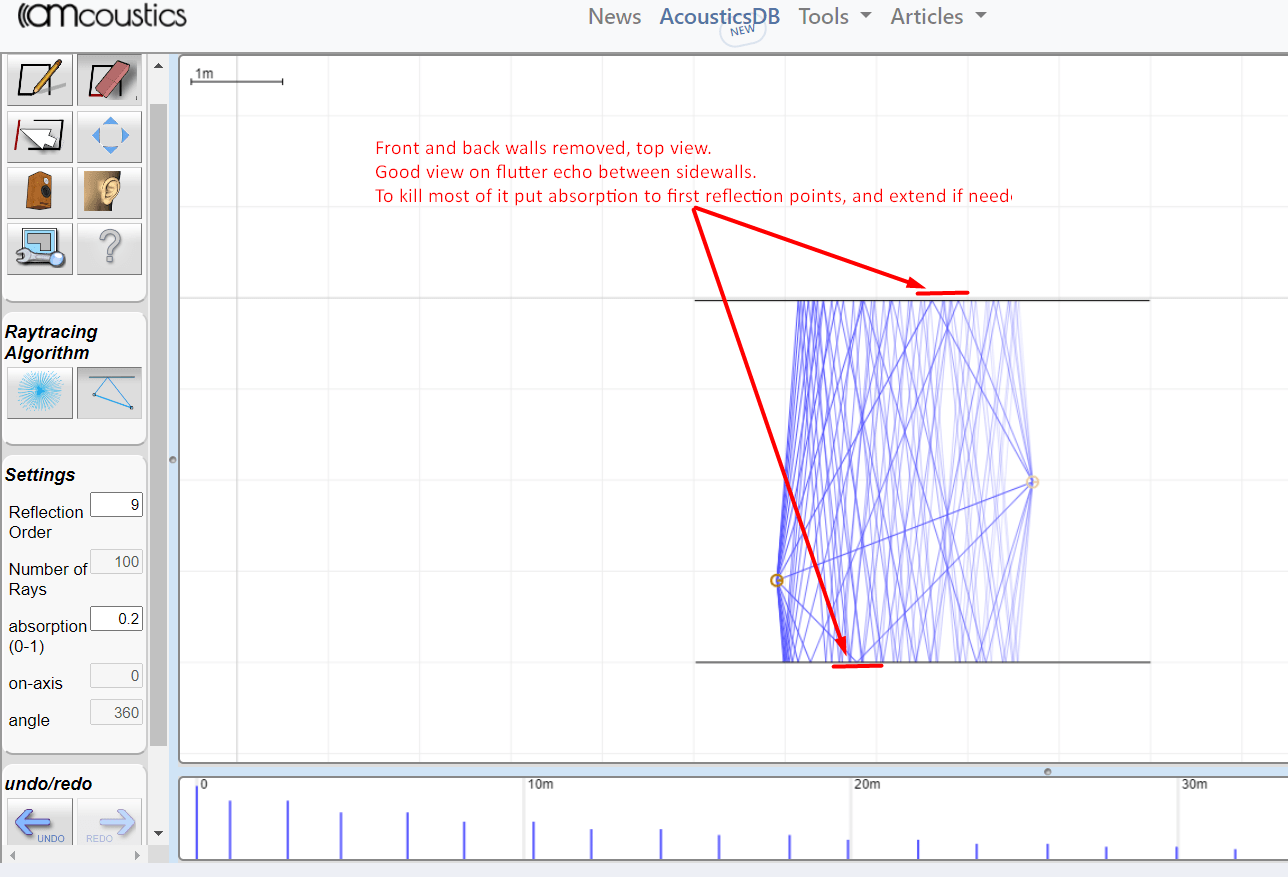

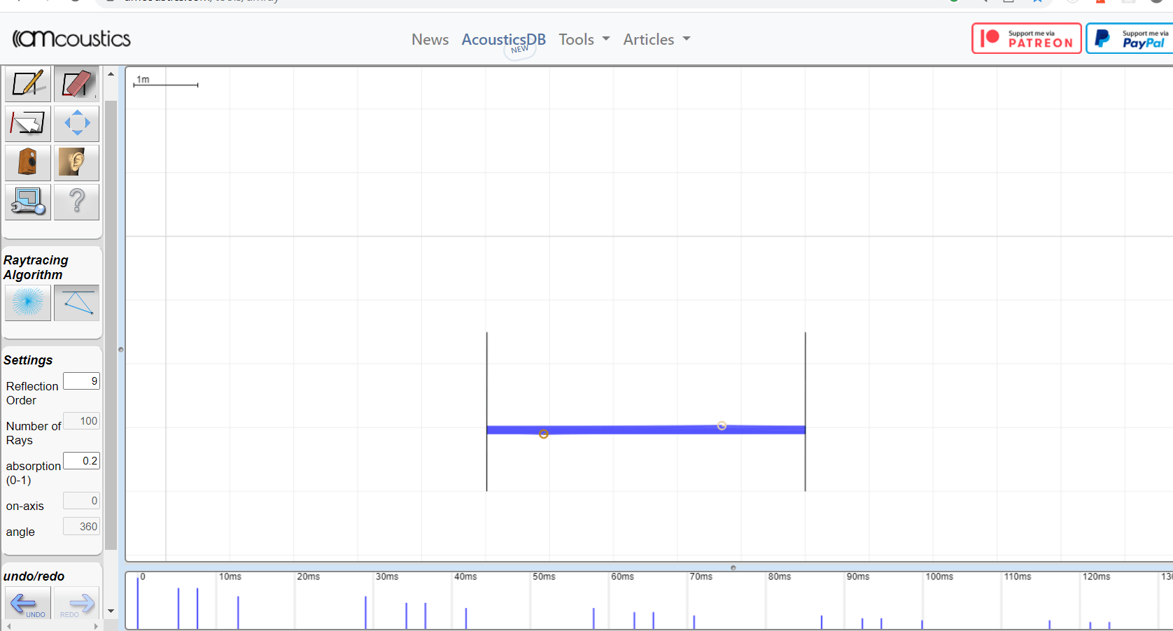

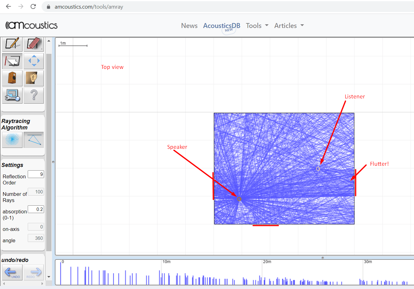

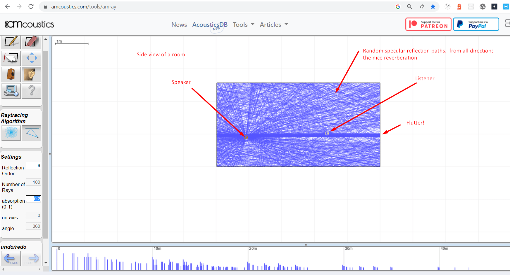

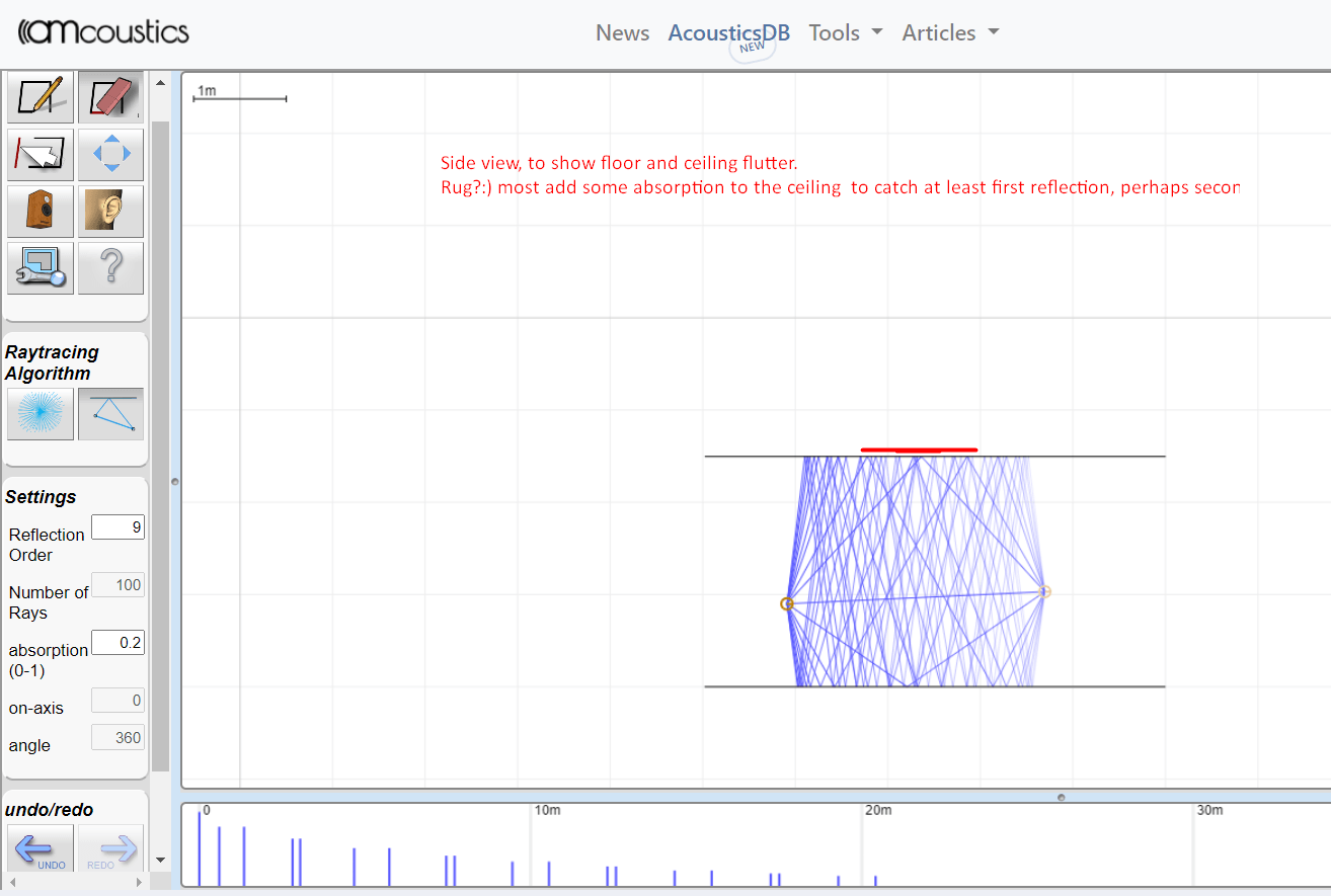

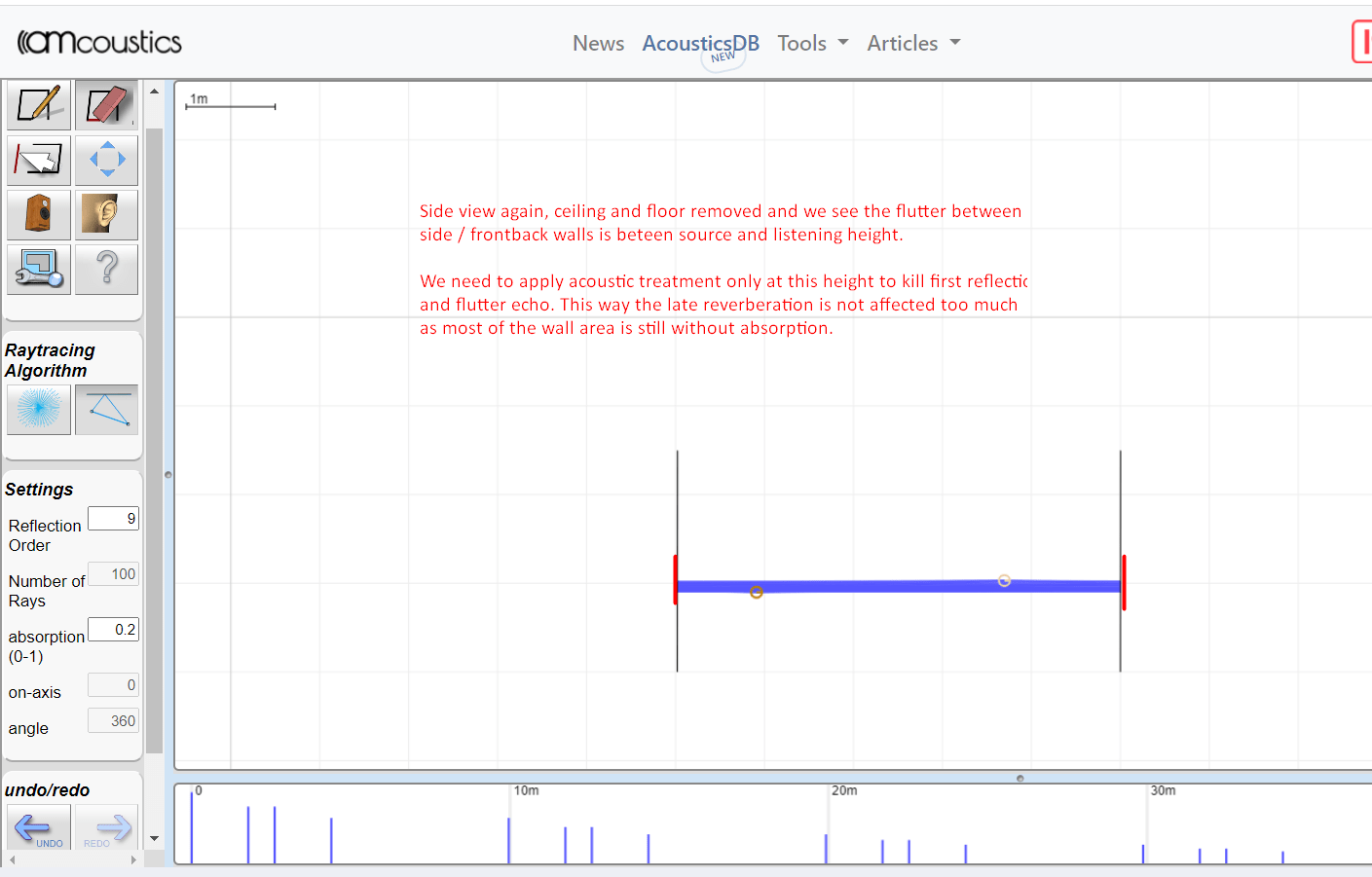

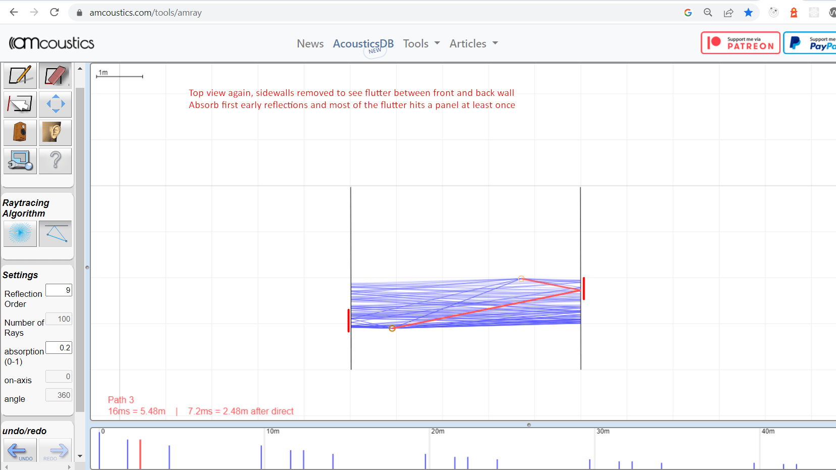

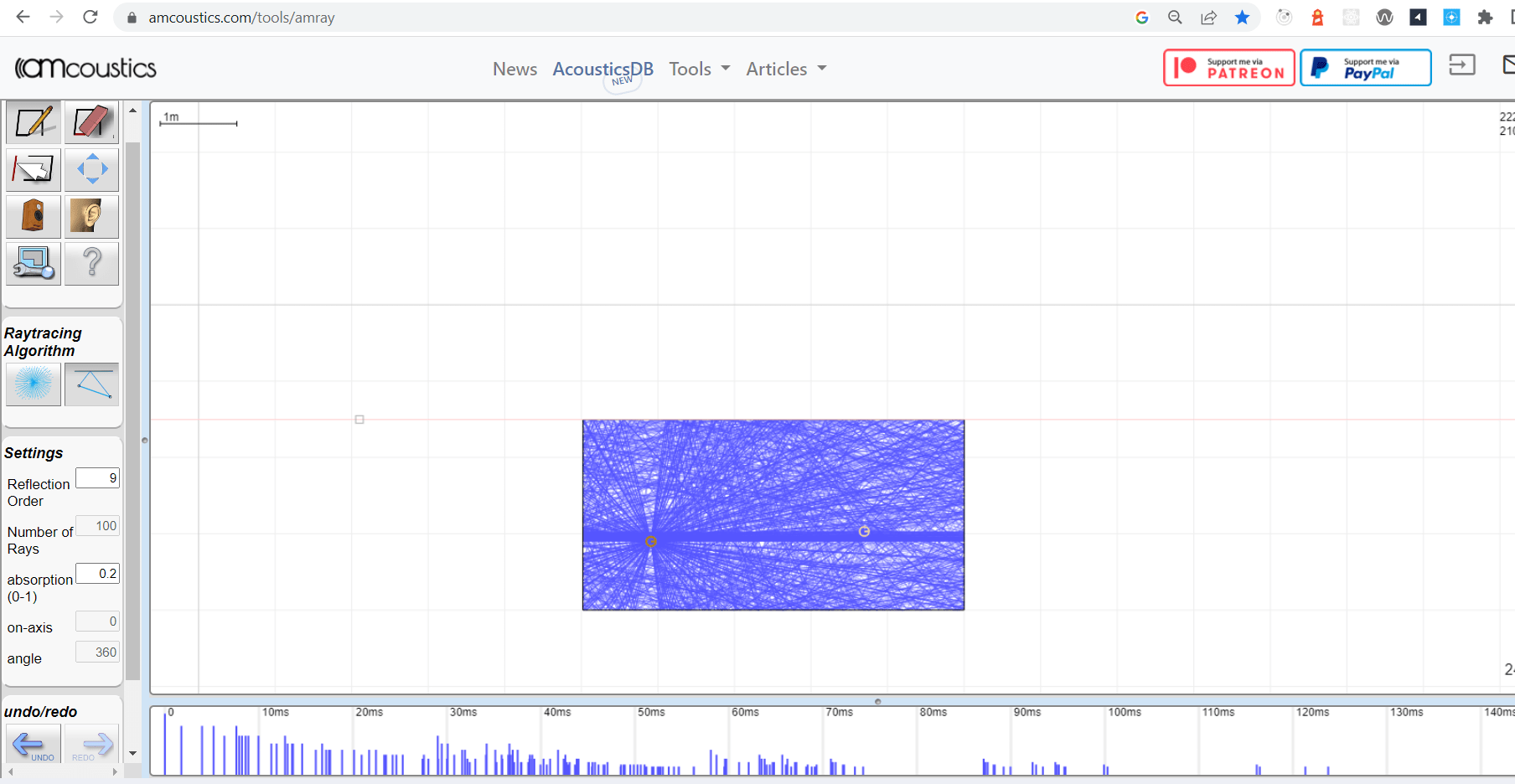

If someone needs further material about flutter echo and how to perhaps address it, here goes:
Some kind of visualization to distinguish reflections that arrive to listening position from all directions at various intervals, this is what we want, the useful reverberation, spaciousness and all that. And then there is the flutter, multiple reflections between parallel boundaries that kills intelligibility for example. This happens portion of the boundaries that is between source and listener. One source available but anyone can adapt the idea to a multiple source situation.
Some more example, some boundaries removed to better see where it might be good to places to put some absorbers to address early reflections, and flutter echo:
edit.
here is one more image, all 9 early reflections the simulator can show come within first 100ms so yeah not much late reverberation as its all pretty early
Practical guide from the above:
If one considers sidewall reflections good, then perhaps use some absorption on front / back walls in strategic positions. If rug is not enough for vertical reflections consider some panels on the ceiling. Now you'd have reduced flutter echo without touching any useful reverberation there is, the RTx0 values.
This is practical to me, perhaps not for all though I don't have dedicated listening room so haven't gone into studio construction stuff. All this is what seems feasible and practical to me, also minimal, for a family living room. One panel behind each speaker, perhaps few to back wall, perhaps few on the ceiling. Lower speaker height between furniture and perhaps no acoustic panels is required. Few subs also on plans to address notch around 30Hz.

And even if there are some missconseptions in your link they still do corner trapping first and the go for early reflections - exactly what I would suggest, just do it right in the first place
When your room is long enough you can use diffusion at the rear end but you must know how this stuff works. You need distance to diffusers, otherwise you hear comb filtering. And diffusers are strongly frequency dependend - so they diffuse just a part of the audio spectrum.
This is a measurement of a very good diffuser - and you still see it's not working as good between 1kHz and 4kHz - which seems typical for skyline diffusers and is exactly the frequency range where you would NEED diffusion. I only use a curved "diffuser" in my recording room which helps against flutter and is broadband but is a very simple way of "scattering" (in fact debateable if you count it as diffuser) and also needs some distance of listening or audio sources.
And the better your room get's controlled the more annoying is flutter cause it doesn't get masked by all the other reflections any more. As it's a living room you probably move around freely ;-) so this can happen at any place in your room. A good example are high rooms which are only treated up to 2m - sound bounces happily around up there and comes back after a quite long time, very annoying (I tested this in one of my first flats very long ago ;-))
The problem in YOUR room is you have not enough broad band absorption and way to much high frequency absorption! Your room get's dull and is still boomy and reverb/reflection in the 100-300Hz area destroys clarity/muddens stuff. It's unbalanced, what you notice when you move your head.
Follow the "simple" rules first and then post a scetch and a few photos and we can help with fine tuning.
