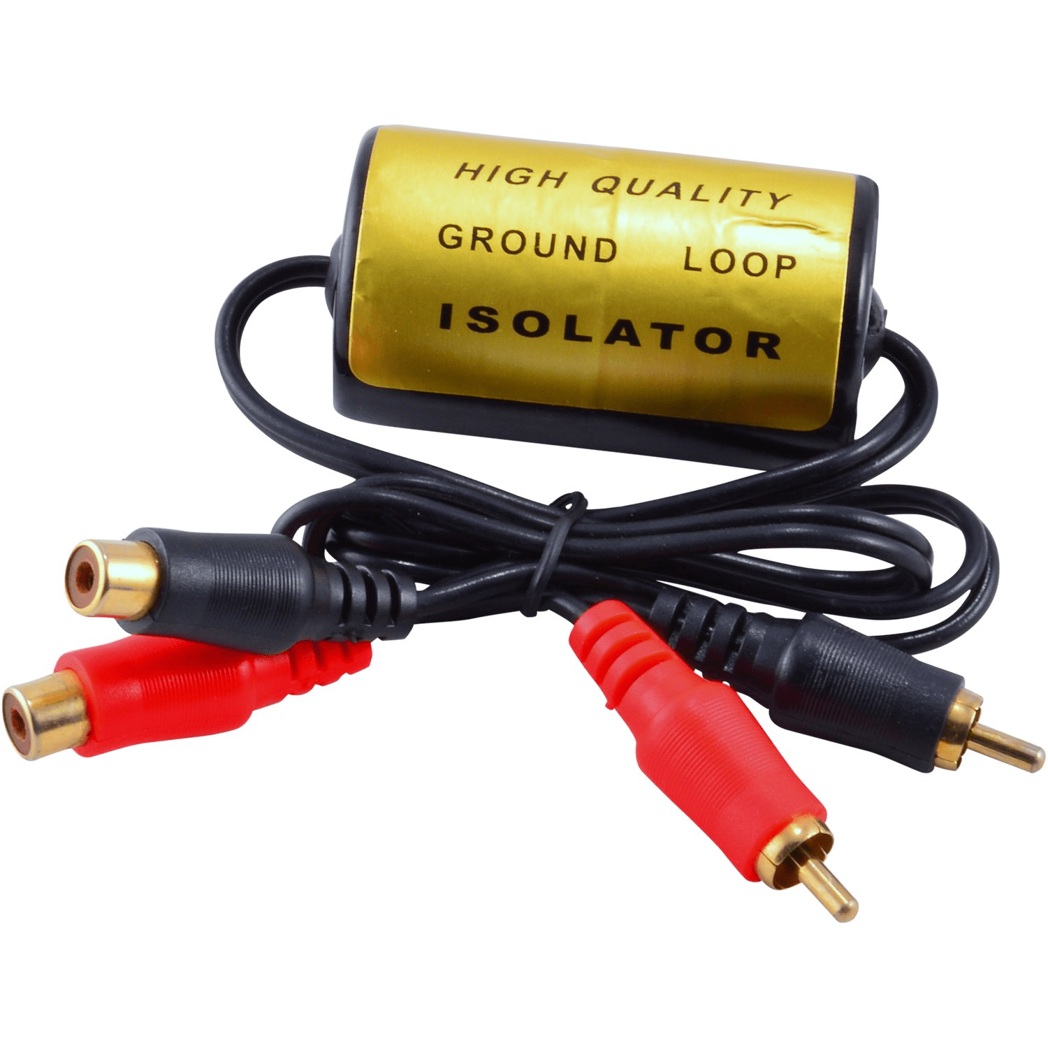

Would connecting a ground loop isolator between headphone out and line level in avoid the problem?

@julianfletcher
To be on the safe side, you could use a ground loop isolator.
I connected the Monacor one in the following link between my son's Benq computer monitor headphone out and the line in input of his Blackstar amplified speaker: https://www.amazon.co.uk/FGA-40MF-P...x=monacor+ground+loop+isolator,aps,105&sr=8-6
This device ensures galvanic isolation of the source and destination equipment by incorporating two 1:1 transformers, one for each channel. (Galvanic isolation means that no direct conduction path between source and destination is permitted while still allowing information to be exchanged.)
My addition cured a nasty interference noise without audibly affecting the signal.

It depends.
On the Walkman, no big deal, it is designed for headphones so output level is "just that" and very close (a few hundred mV) to generic Line Out levels.
While on speaker driving power amps, that is the main output, think 15-20V RMS, and headphone out is kludged by connecting headphone jack to speaker out through a 100-200 ohm resistor.
Cheap a$$ solution.
If you connect low impedance headphones there (8 to 32 ohm) output is automatically attenuated to safe levels.
If you connect a preamp input, typically 10k or higher, there is NO attenuation, you get the FULL 15-20V RMS through, which destroy any preamp input, even a power amp one.
I bet that was your problem.
