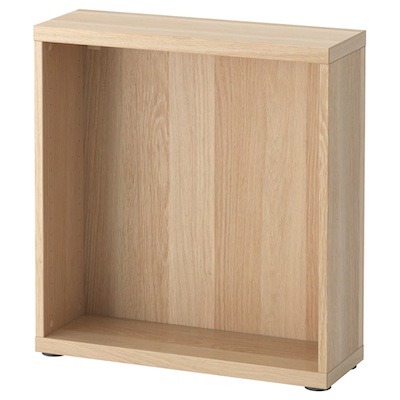

Took a lot of back and forth but I ended with an ikea besta, 60x64x20cm, that exists in black or tan.

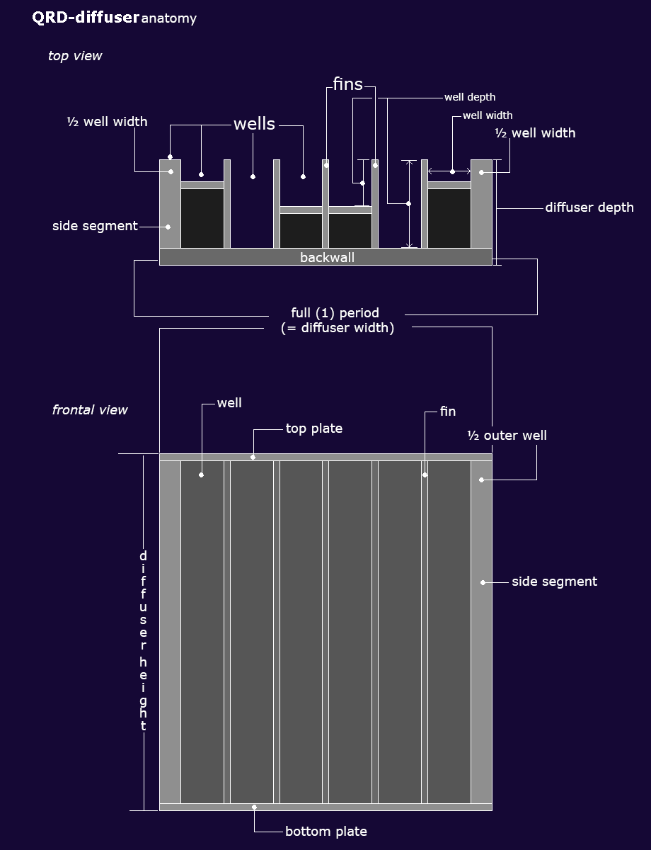

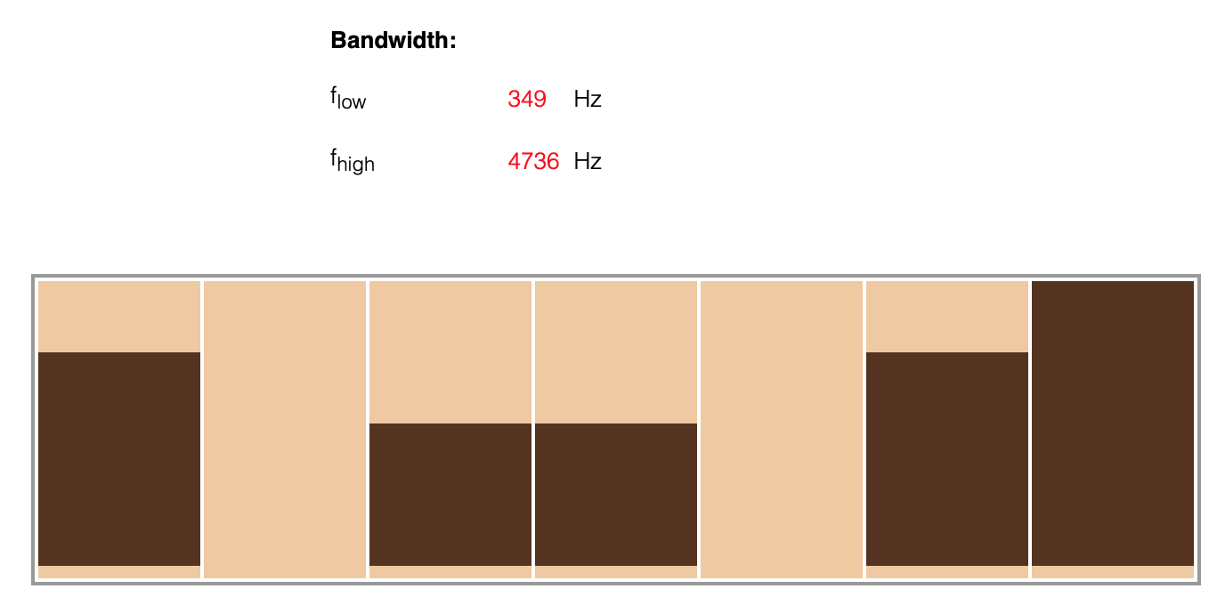

It allowed a double symmetric QRD n7 with 38mm wells and 6mm fins with an F low around 350Hz and an F high around 4700Hz, perfect for my OB midranges.
See calc:
Here only half:
Wells from left to right, in mm: 20 box left wall, 12x6 fins + 13x38 wells, 20 box right wall
Depths: 0 - 50 - 200 - 100 - 100 - 200 - 50 - 0 - 50 - 200 - 100 - 100 - 200 - 50 - 0
The 0.8mm added in width were need to include the fins thickness in the wells width calculation.
You will later notice it's not an exact symmetry since side walls/half wells are 20mm and the central one is 50mm with its 2 side fins.
I believe the effect is minimal, and it was just too hard to build without 2 fins on the central one to hold it.

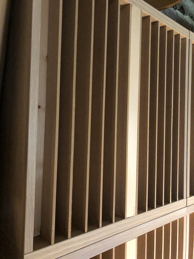

Results:
Boxes are solid while still light, can be stacked 3 or more, and moved around safely.
I've just built a base structure as my ground is not flat.
Once all fins are glued they stay in place, but don't push too hard on them.

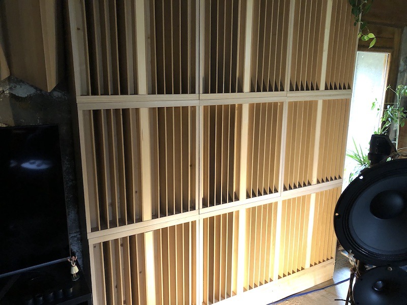

With the leds the effect is I think pretty cool, lovely at night.
I need to dig-in to find some "before" measurements, I have so many I'm not sure I’ll find the right ones.
Not even sure it will be visible there, but I do prefer with 9 per side for sure, while 4 per side already had an effect.
The room is rectangular, and I use it in its width, so it helped a lot to get back some depth in the soundstage, virtually increased it.
Now I have to work on bass traps...
