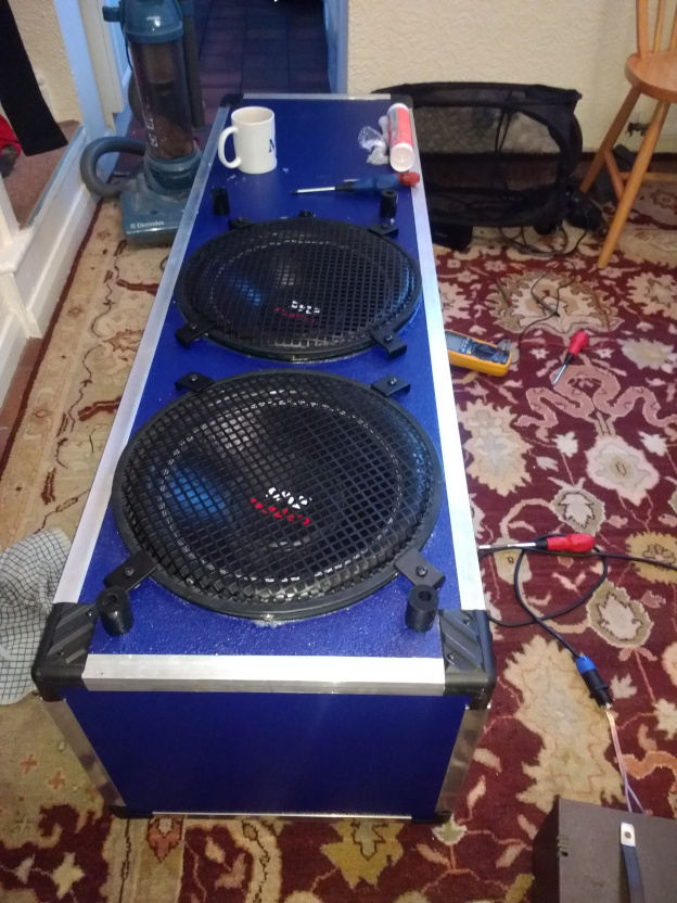

I have built 4 sub woofers around this driver (as its super cheap): 2 subs using two drivers in 200L (pretty flat frequency response) and 2 subs using four drivers in 200L (maximum output in given volume design). I built them with drivers on opposing faces which I found effective for reducing cabinet vibration, to the extent I would always use mechanically opposed pairs of drivers in future subs. If you have have the amplifier power and don't mind a lot of EQ you want about 50L sealed per driver. No problems with vents. I have attached a design I did for a friend using two drivers in ~100L showing what is possible from a sealed box.

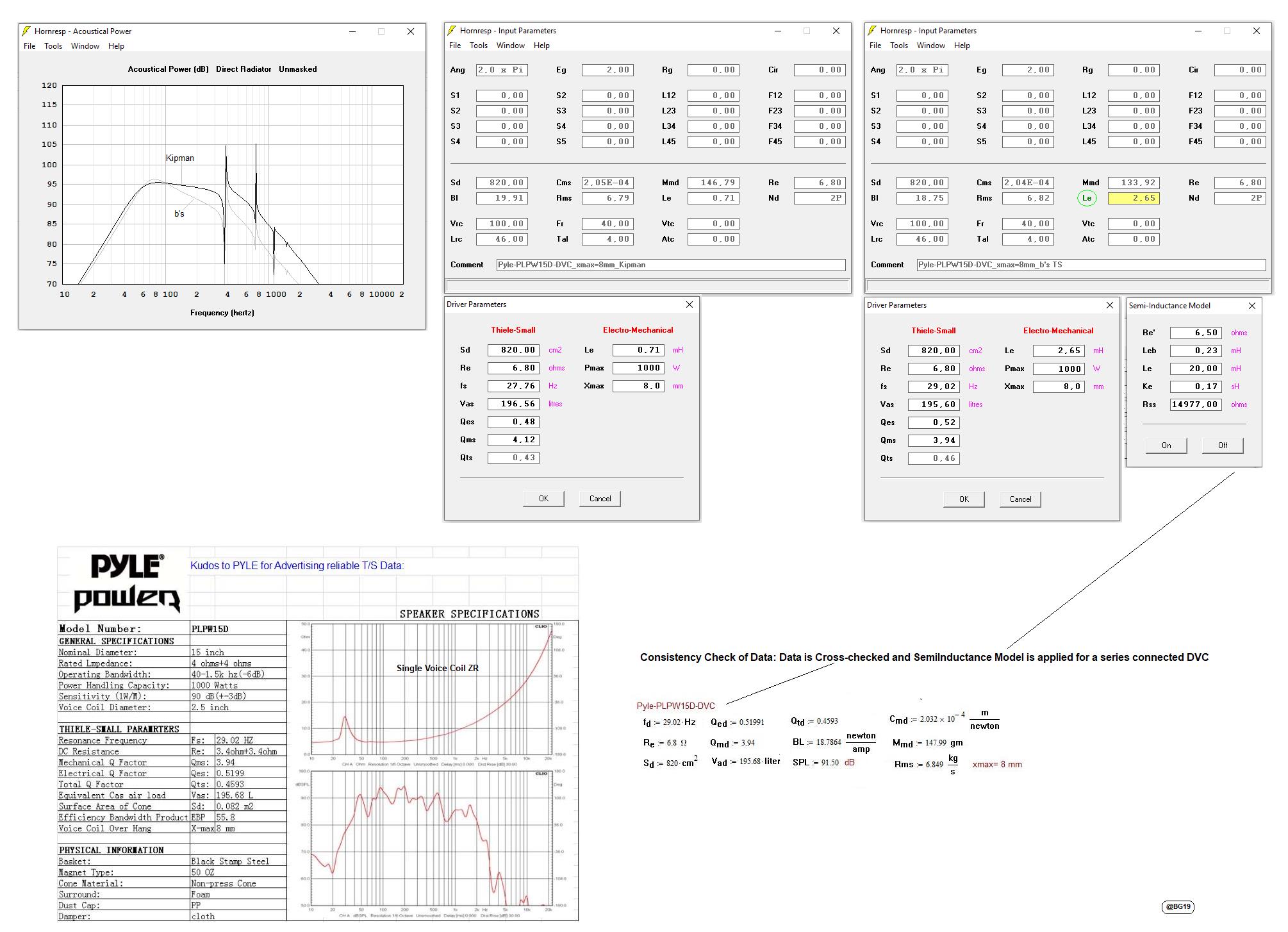

Hi All,
FYI:
b
ah that explains a lot, I misread the inductance? when I measure the box frequency response near field I get that reduction in HF output. I thought it may have been a measurement artifact as its a very difficult box to measure in a room due to the multiple outputs in close proximity.

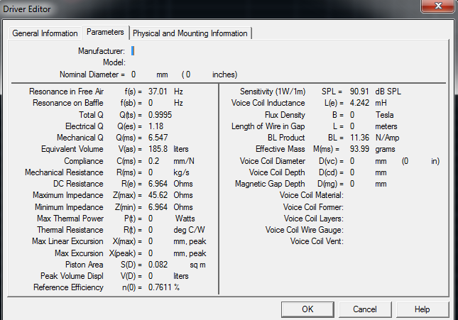

I measured the TS parameters using a WT3 and got the attached results. The driver has been broken in. The added mass was 167g and the piston diameter 323.11 mm. This is with both voice coils in series. The results are a long way from the manufacturers. This is the first time I have used this tool so I could have made a mistake.

well the question is what are the T/S parameters of your particular driver, I only have one sample here where parameters are very different to the manufacturer supplied. For any sim to be valid you need good input data. If you are unable to get measurements, sealed boxes are less sensitive to driver parameter variance and don't have a risk of driver damage if operated below resonance (a simple maximum power input limit is sufficient to limit excursion). However long term power handling is reduced due to box heating compared to ported boxes (probably not an issue anywhere apart from PA).
