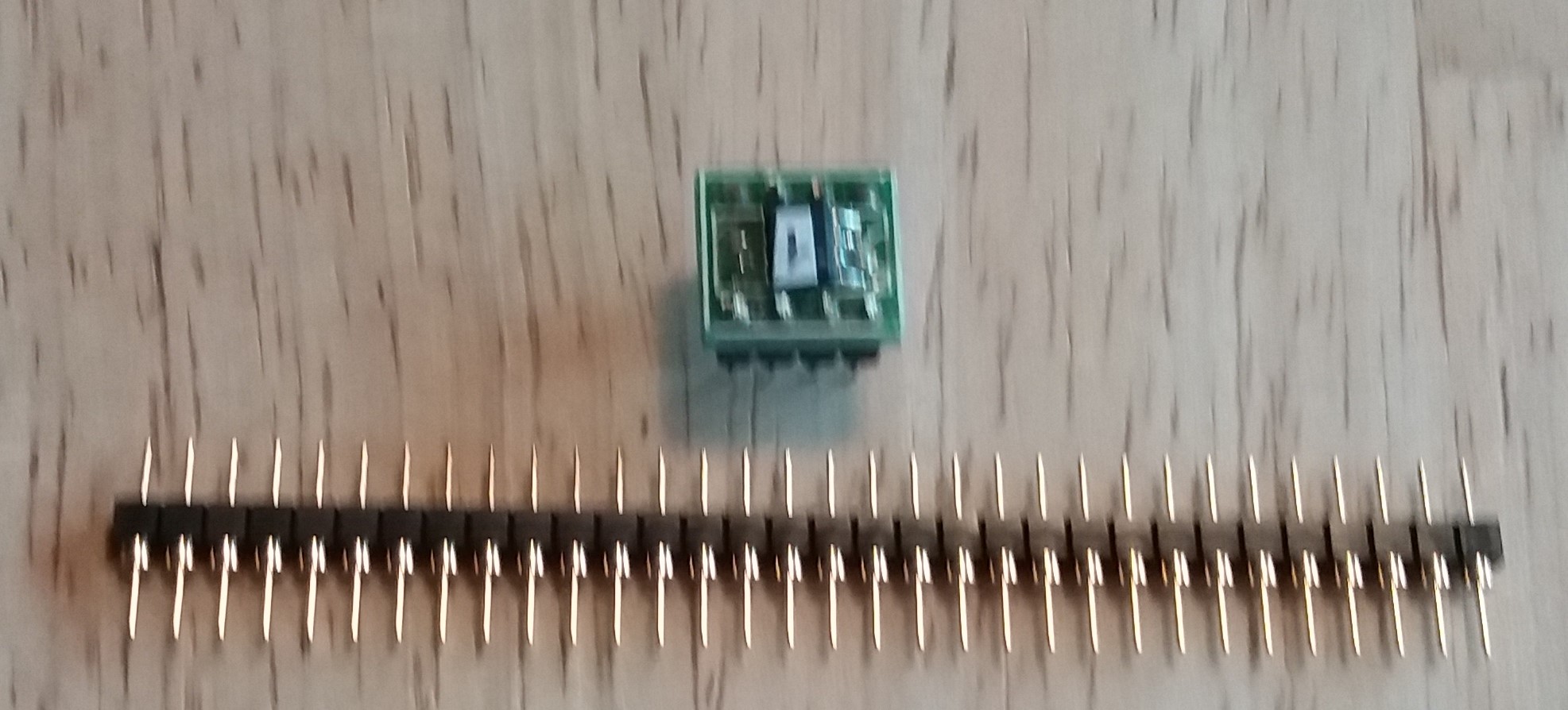

Guys, I've been looking for these parts for a few hours now, for the life of me I can't find them. I got some, years ago, see pic, from Mouser but don't have the ref anymore.
Standard two-sided pin strips that you use to solder on a DIP adapter and then can plug into a standard DIP socket.
Anybody know what they are called and/or an order number?
And sorry for the bad pic quality, but you get my point...

I would just use a normal pin strip for DIP adapters, but the ones with long pins on both sides like in that picture are called stackable pin headers. Like this one that I pulled at random from a search engine: 3 PIECES OF 0.1" 1X40 Machine Pin Male Headers (Swiss Machine Pin)(920-0172-01) - Schmartboard, Inc.

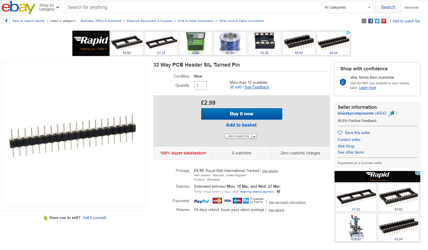

You need to search for 'turned pin header'.
e.g. TruConnect Turned Pin 2.54mm SIL Headers | Rapid Online

It looks like a standard pin header but not with the turned, thinner pins that fin a standard DIL socket.
This is the real deal:: Samtec Part# TS-132-G-AA, available at Mouser.
For some reason called: Headers & Wire Housings .100" Single Row Screw Machine Terminal Strip
