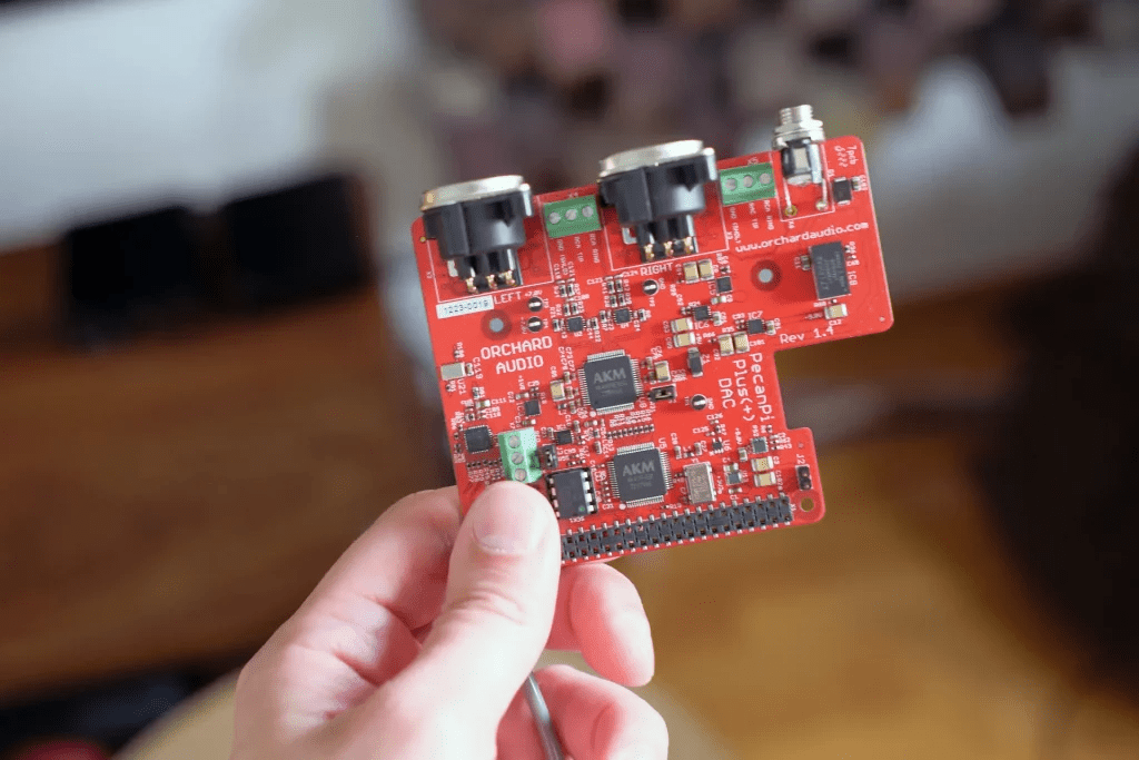

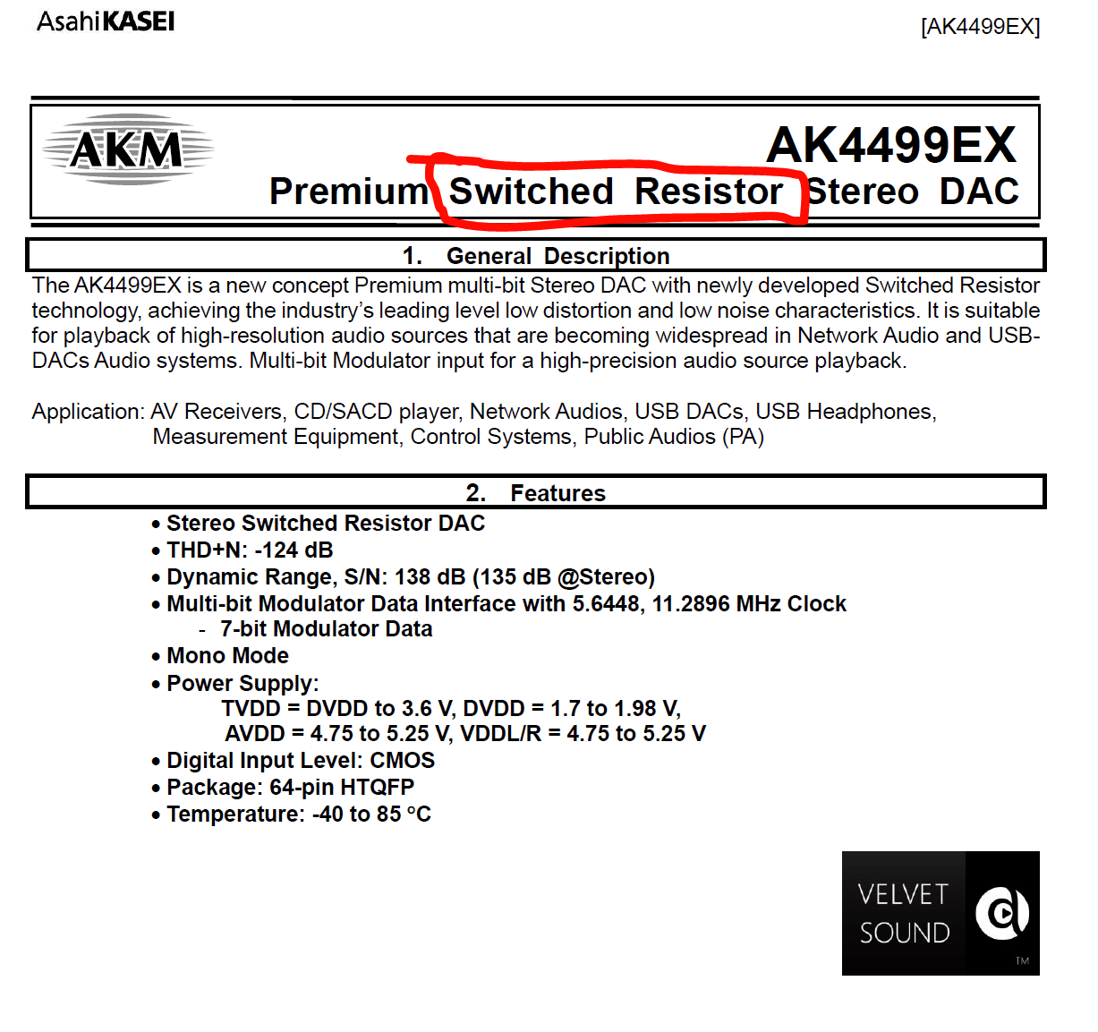

Designing a really good dac with that chipset is not going to be able to be sold for a few hundred dollars. It could cost more than that just to manufacture. So they just use the chipset as a name brand selling point, not because they are using the chip to best effect. I wouldn't be surprised if the old BB R2R dac chip has the potential to sound better to humans, at least if its not in an RPi hat configuration.
I would say 95% of my customers who had the PecanPi and PecanPi+, prefer the plus(+) version. The two comments I get most often comparing the two is that the plus(+) version sounds more natural and has a much better soundstage.

However, I would suggest to look into the noise problems with RPi GPIO bus, not to mention the jitter.
I am well aware of these, for jitter my DAC has a full reclocking circuit that takes care of this with a Crystek clock source. You can see that in this test result here.
As for the noise that is significantly reduced by turning off the Rpi's wifi and Bluetooth.
Hence on my streamer(s), the only option is ethernet. The DAC has an SNR of 133dB, so there are no noise issues.
For those that dislike the Rpi, the DAC also has a SPDIF input so it can operate without an Rpi.
