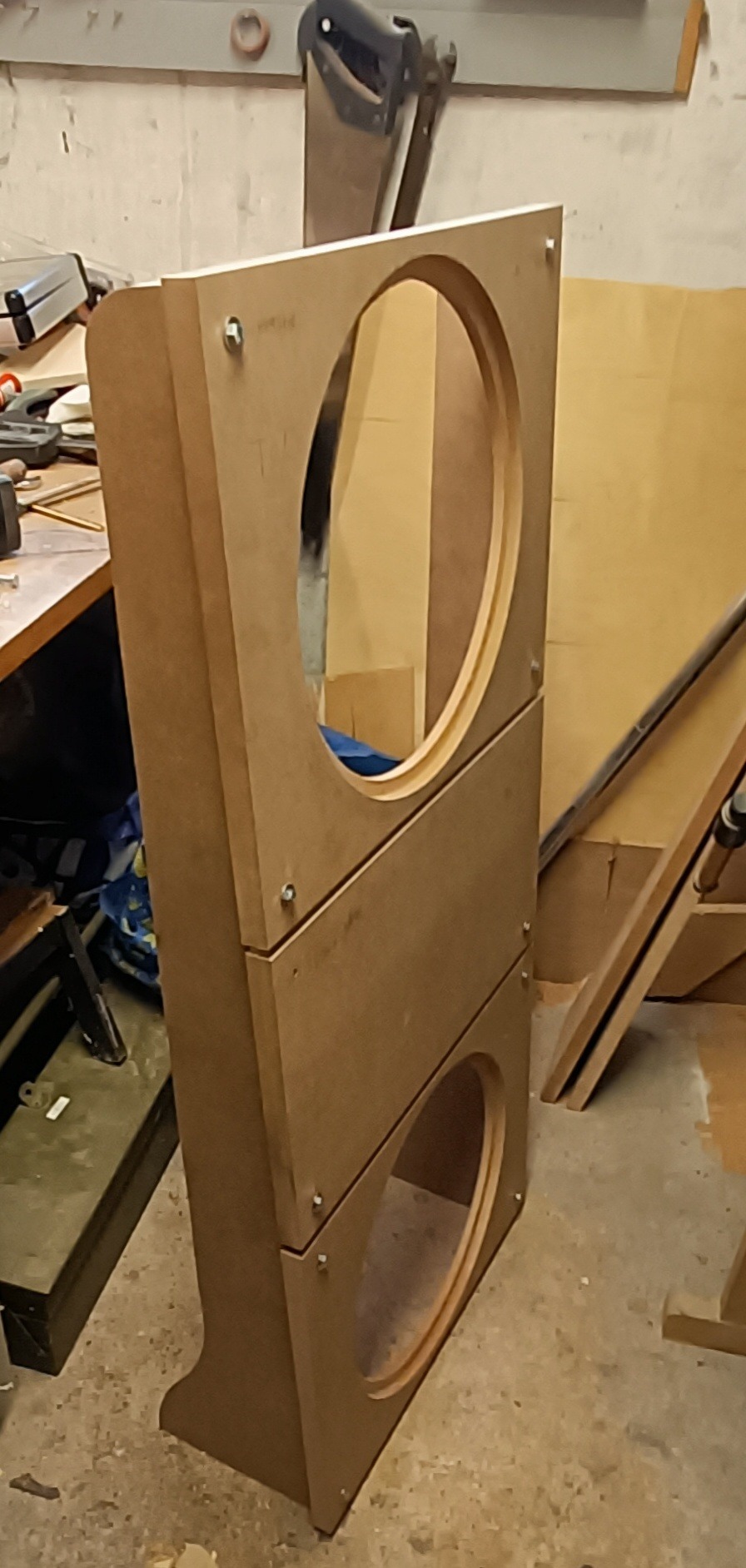

I have nearly finished making a pair of trio15 in 22mm mdf.
I was wondering how to mount the fostex? Surface, rearmounted with chamfering (maybe more shouty?) Or other ideas.

What kind of vinyl did you use?
And how did you handle the corner seams?
I've used a type called golden walnut.
To make beautiful seams, you have to put the vinyl on the large surface, make sure you have enough to bend it all the way to reach the backside of the baffle.
2nd bend one of the longer sides, starting from the middle towards the corners(a heat gun is necessary to get a nice corner. Don't overheat it!) When you're about 10cm from the corner, you cut a 45 degree angle from the corner outwards. Fold the corner from the side of the baffle gently so that it can stick to the front, and make way for the long side. Now apply the last 10cm towards the corner, and let the vinyl go around the corner, forming a triangle 📐 on the side. Cut the triangle from the top towards the bottom in a straight line, so you have 5mm vinyl left.
Apply the same way in the other end of the long side. Then apply the short side, letting the vinyl follow the entirety of the side, don't bend the corner, just let the vinyl protrude over it. Cut of the excess that is protruding, and voila you have a beautiful corner. But I've made many things with vinyl, so practice with small pieces first to make sure you have the technique mastered, before wasting alot of vinyl.
Best of luck with the project.

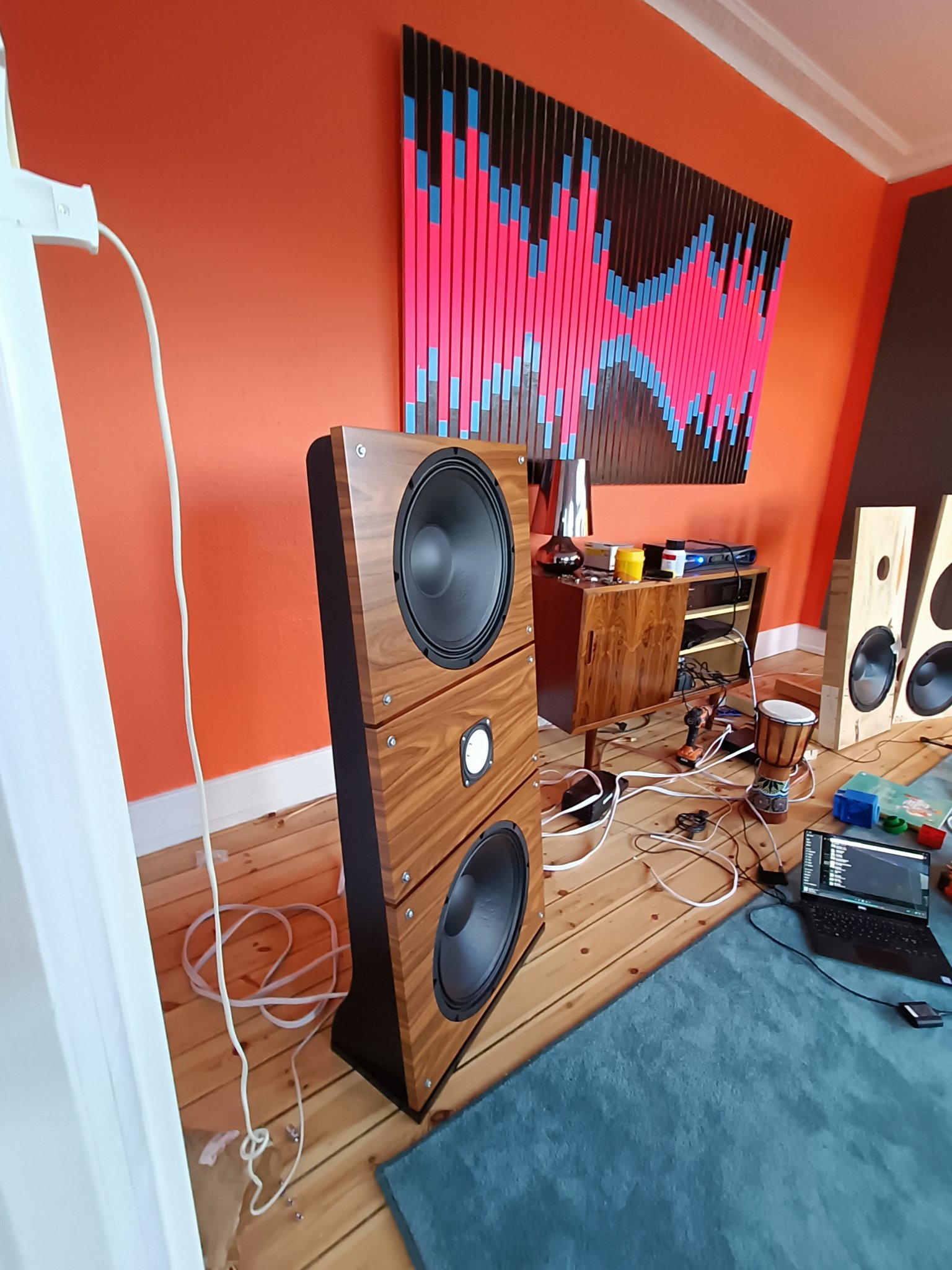

One speaker is all done, need to apply the vinyl to the last one. Pardon the clutter
Hi Mick.
Your speakers look great to my eyes and look pretty much what I have in mind to build myself. How do they sound?
My plan is to make them with two SB OB 15s and the new SB Acoustics 8 inch full range driver. If you don’t mind, could you answer the following questions please:
1) Do you apply any form of filtering to the full range driver? If so, what and at which frequency?
2) Regarding the woofers, do you apply an LP filter to them and again, at what frequency?
Regards
Alex
