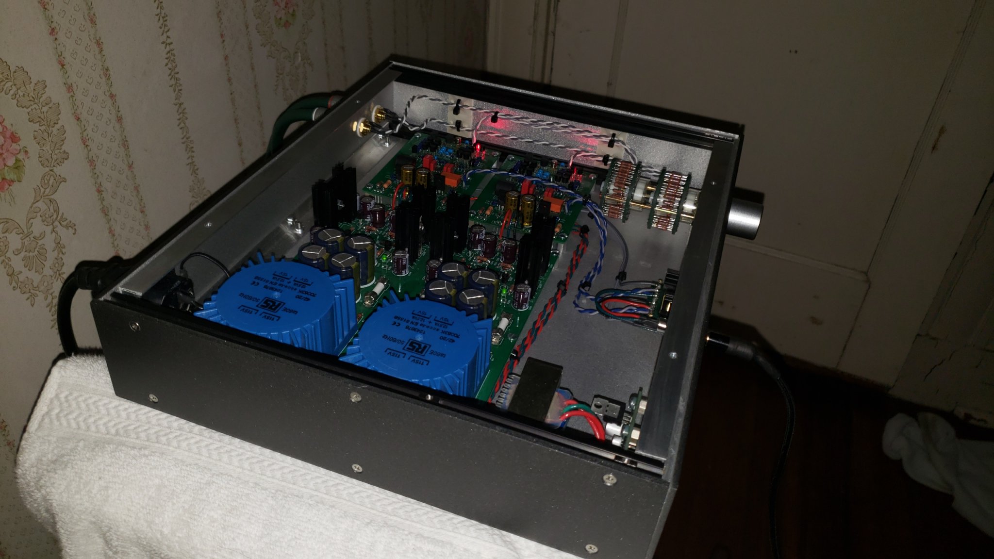

I have one of the HPA2 here at the moment on loan from Henry, it's phenomenal. Have never heard such a transparent headphone amplifier. I have decided to build one and am currently converting the design to a mix of SMD and through hole parts to fit my space constraints.
Parts are still readily available for the original through hole design and I recommend it.

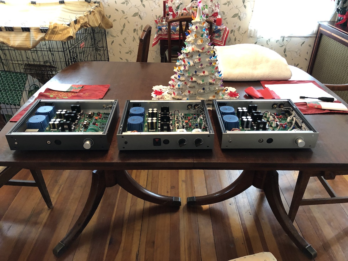

I hope Kevin won't mind me posting photos from his house. I came with three amps to try, plus he brought out the DCG3 I built for him last year.
I'm gratified that Kevin likes the A2. My tastes shifted over the summer and I think I prefer the A2 to the A4 now. It really depends on whether you're in the mood for a very high-end sound, or something more relaxed but slightly less detailed and neutral. Both are good amps IMHO.

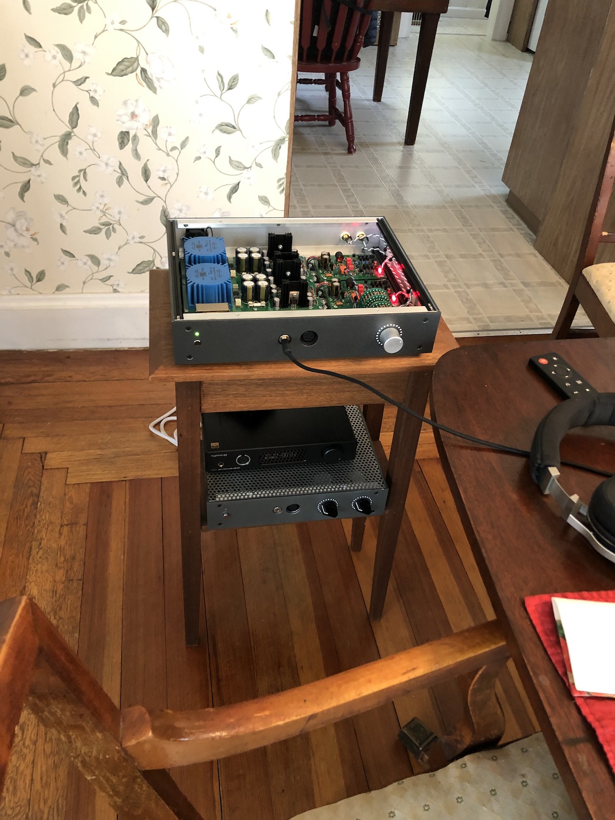

That listening comparison in my dining room was quite an eye opener. All of them were good, I thought the A2 stood in a league of its own and still do.
Source: Topping DX-7S connected to a Roon endpoint. (Using RPI4 runnng Ropieee) Headphones are Oppo Planar-3 with slightly modified Pasanen headphone EQ intended for the specific replacement ear cushions I am using on these phones.
https://github.com/jaakkopasanen/AutoEq
Not blind, not scientific, no familiarity or bias towards any device except mine. I had no preconceived notions that I would/should hear any significant difference between any of these devices. Went through the whole lot at least 3 times and at the end I concluded I really like the HPA2 and persuaded Henry to let me hold onto it for a longer test drive. It seems to be a very synergistic match to my planar headphones.
