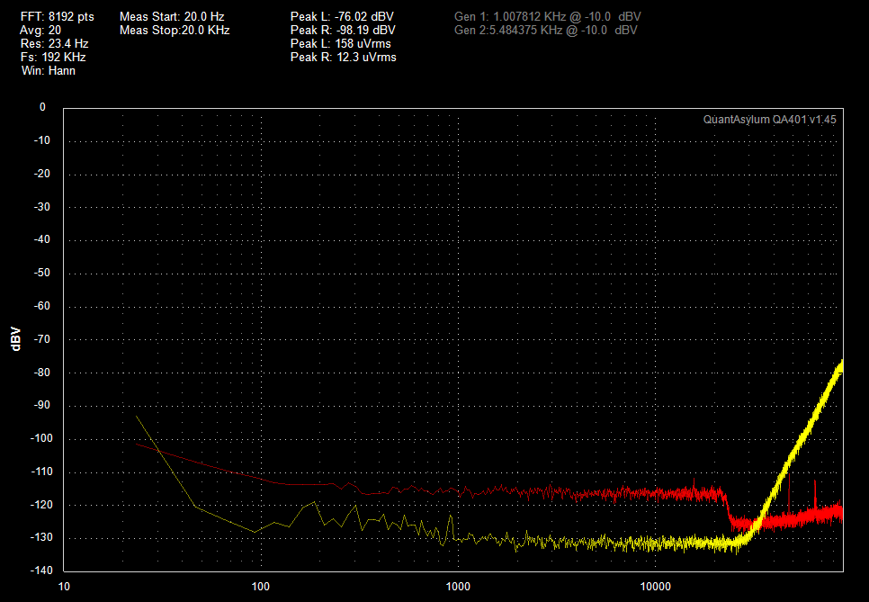

Some users with wide-bandwidth amplifiers have noticed possible issues with out-of-band noise above the audio range being "modulated" by the power amplifier into audible noise within the audio range. That may be your issue here.
I think rather than attenuators between the miniDSP and your power amplifier you might try some low-pass filtering. A simple shunt capacitor working in conjunction with the output resistance of the miniDSP unit might solve this issue. I've made a few posts on this previously on this and other forums and users have had success doing it.

What I'm alluding to here is above-band noise (possibly) causing the issue. As an example, here's a measurement of the noise floor of a 4x10Hd unit (yellow) and a standard 2x4 unit (red.) Note the noise-shaping utilized in the 4x10Hd unit.

I haven't found output noise to be dependent upon the internal DIP switch position which controls analog gain output, but other users have noted this. I would start with that and then add a shunt capacitor across the miniDSP outputs to limit the above-band noise (that I showed above) and see if that results in improvement.
