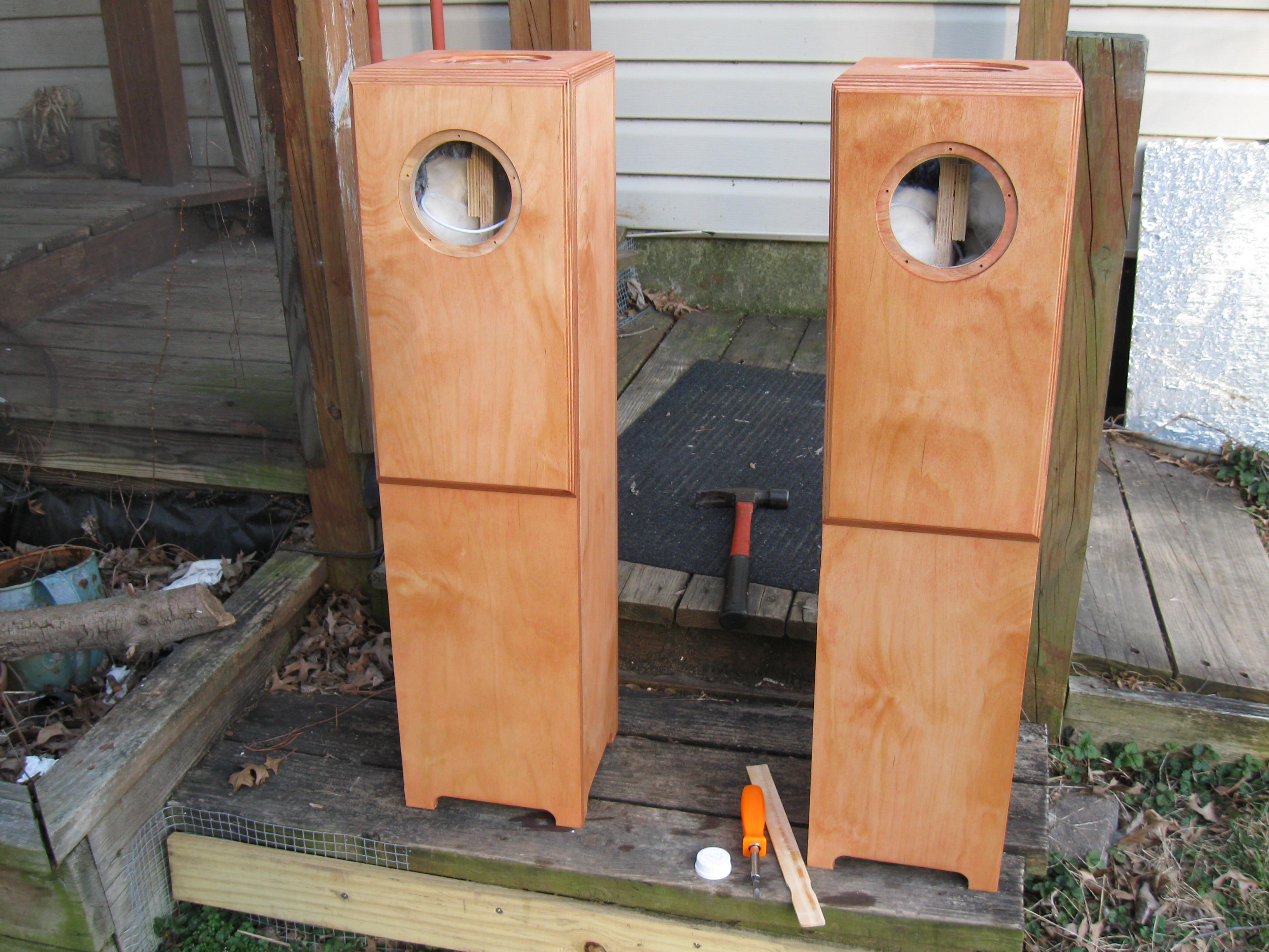

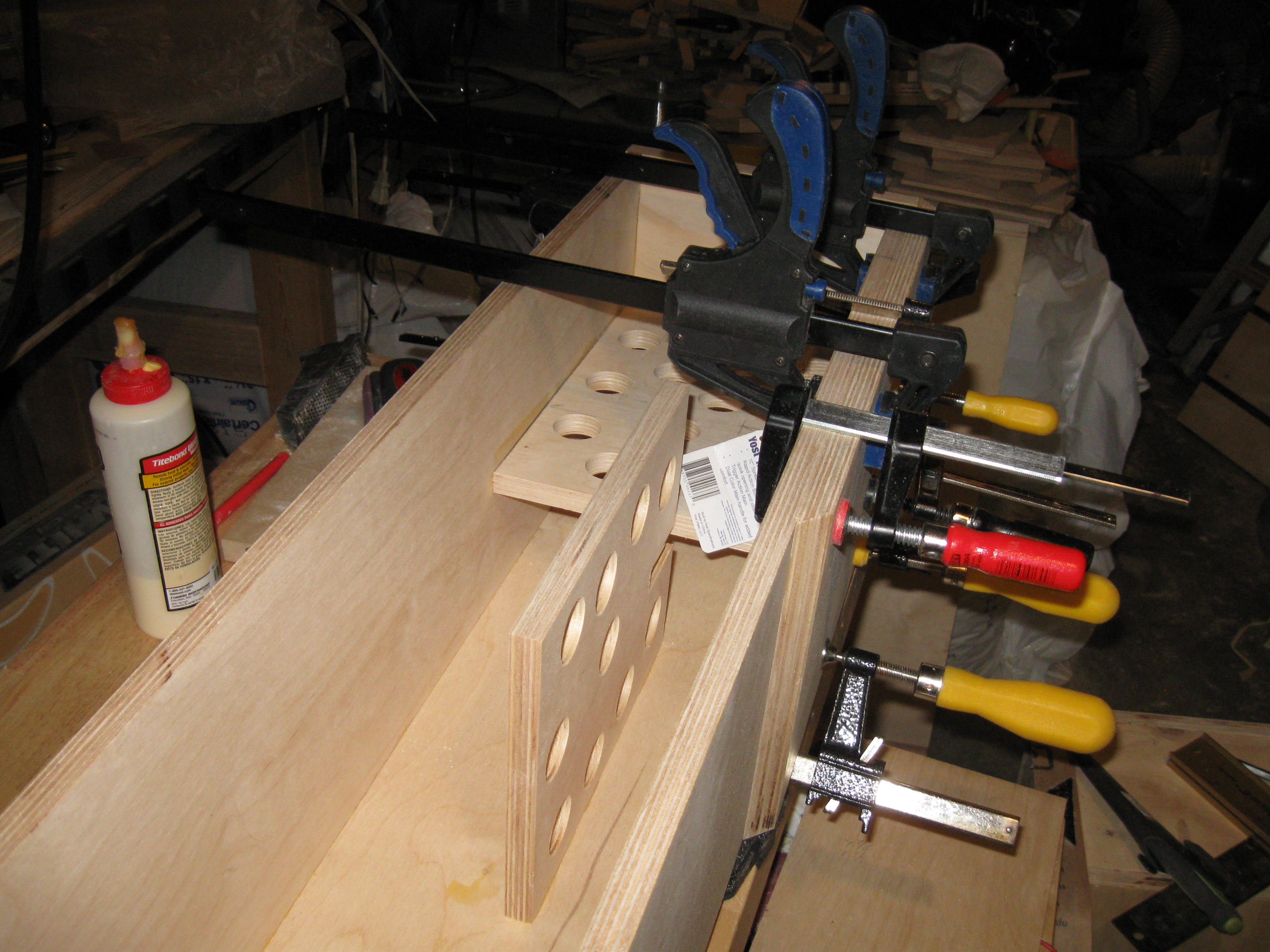

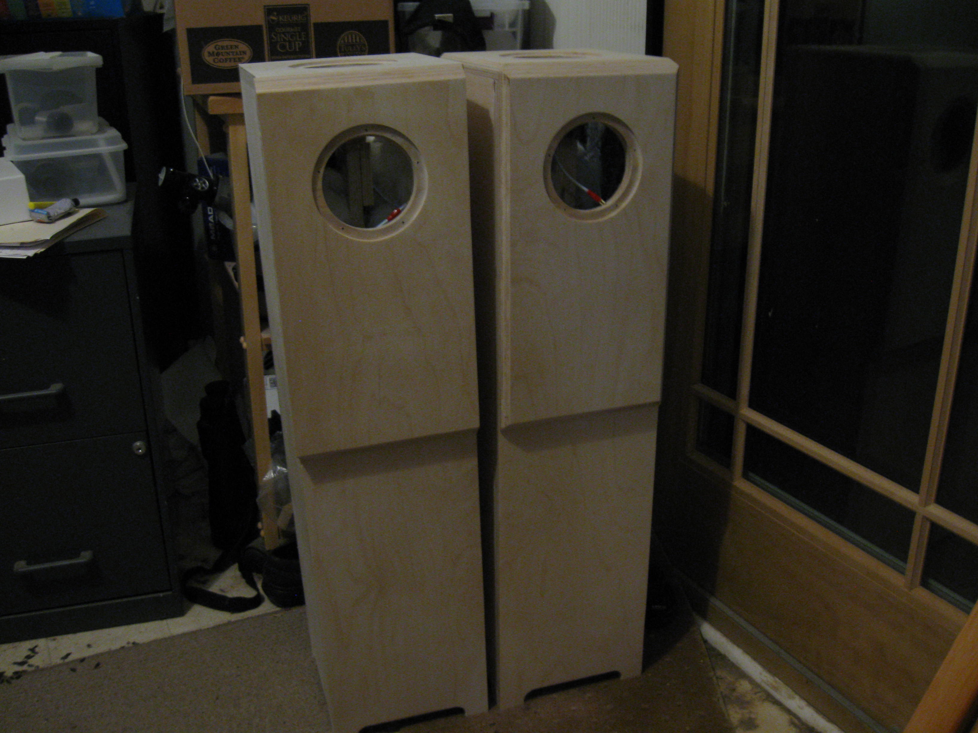

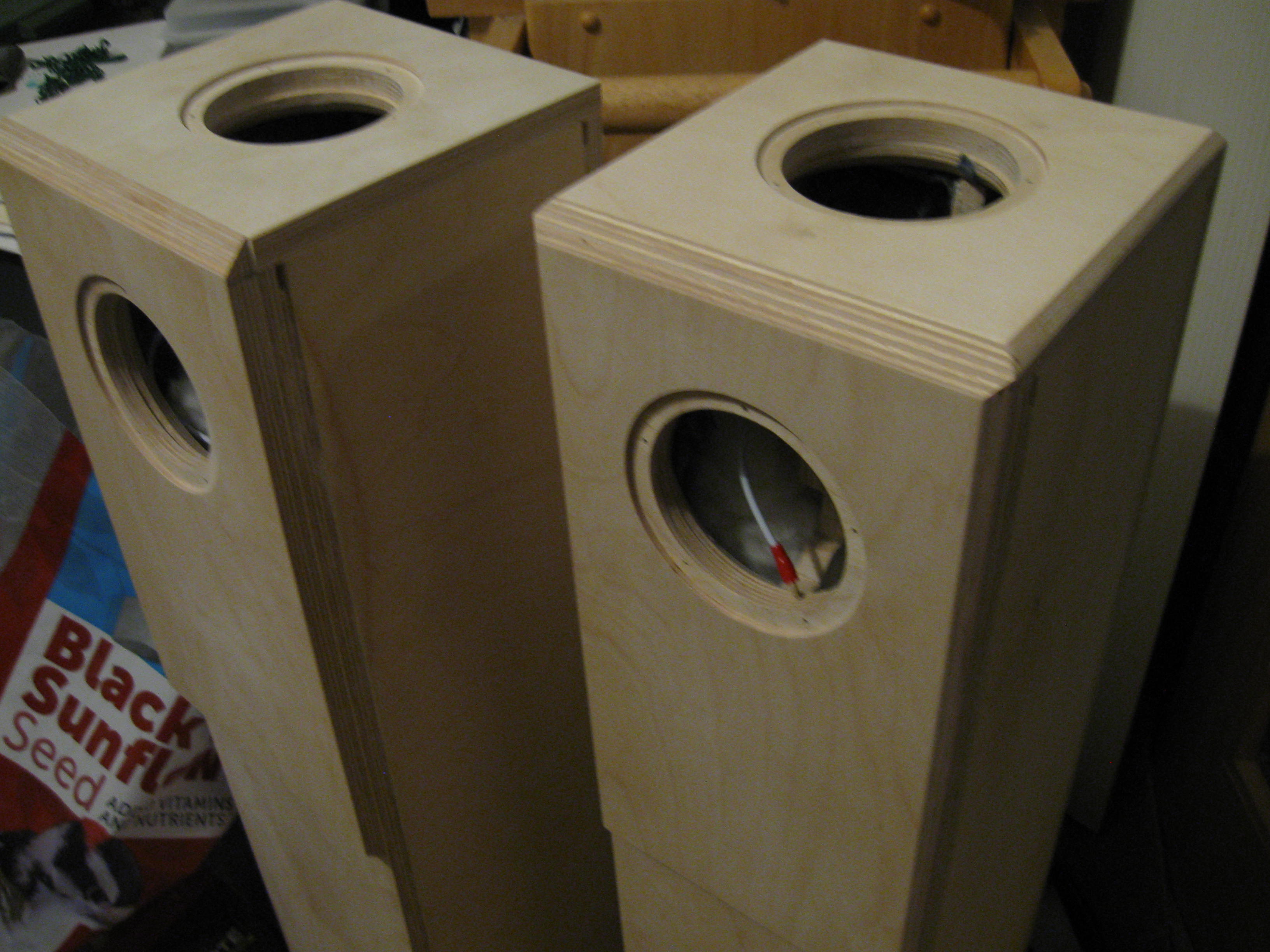

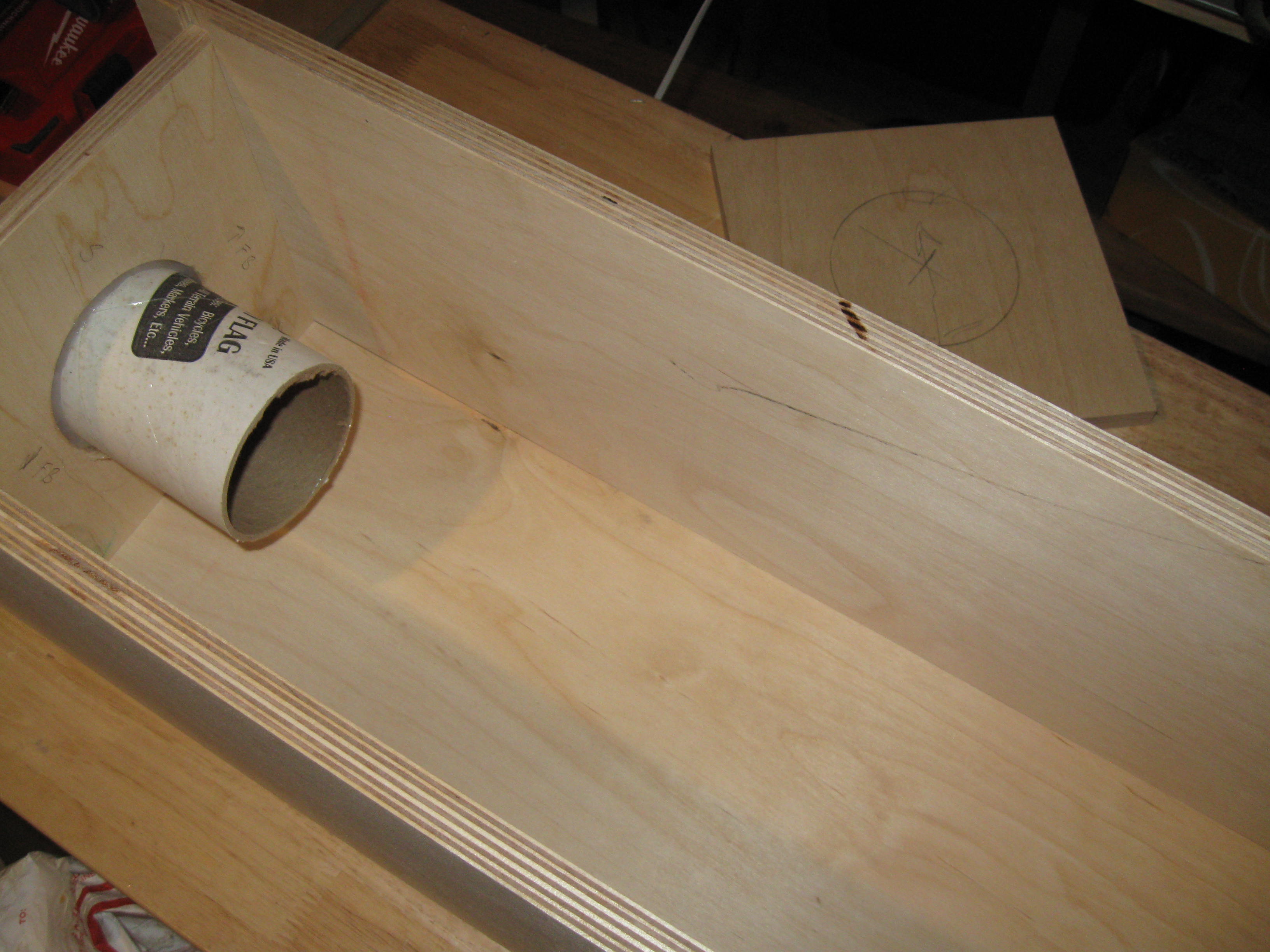

Micro tower with Pulvia 7HD
Here are some shots of the process. I doubled the baffle and top to make the magnets fit. Chamfered some of the edges. They have been stained with cherry and to me look great.
