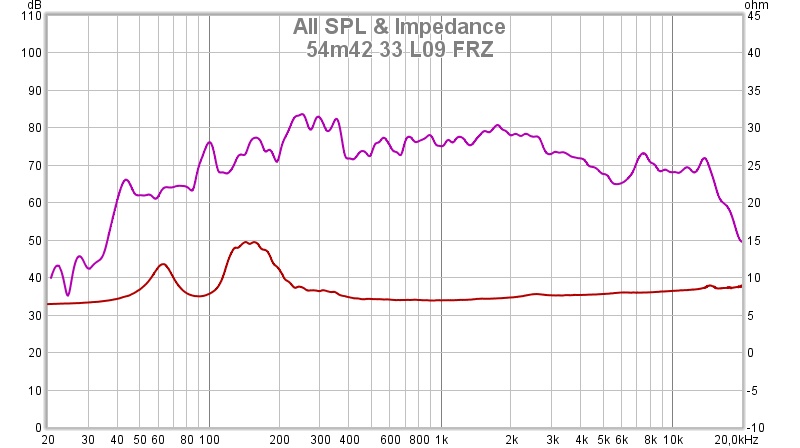

when foam starts being used as a correction in a loudspeaker design it's time to move on....
If (you don't like foam)
  • increases the number of aluminum waveguides,
  • increases the cost of the material,
  • increases assembly time,
  • reduce the impedance peaks as in the 54m42 project.
else
else
  • add a few pieces of foam,
  • reduce the impedance peaks in five minutes,
  • the budget remains below 100 euros of material.

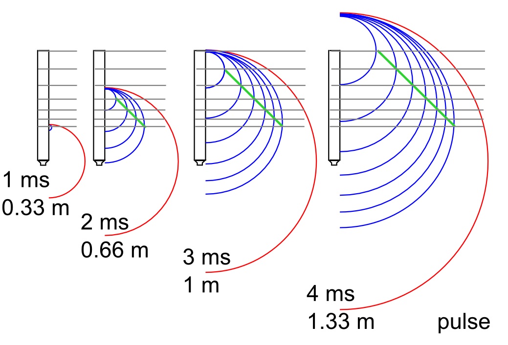

The purpose of MDD technology is not to regularize the frequency response but to emit delayed and consistent secondary sound waves to improve the listening experience.
The use of foam rubber cubes is only one option, it can be used by those who want to try to make prototypes, saving on the purchase of materials and reducing construction times.
Then it is time to abandon most speakers… they almost all use some kind of damping. Foam is not particularily effective, as pictured it would be more like a slight push towards aperiodic… i use this same technique if the bass in one of my miniOnkens needs damping down.

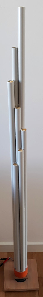

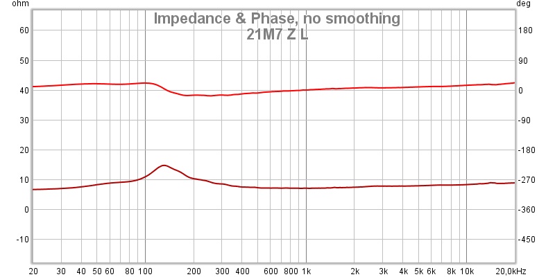

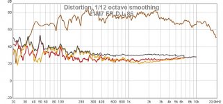

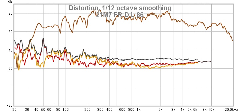

21M7 a new MDD project
The sound quality of the 21M7 project is excellent, the construction is simple and economical. With about 50 euros you can quickly build a pair of omnidirectional stereo speakers superior to any other type of cabinet with the same budget.
