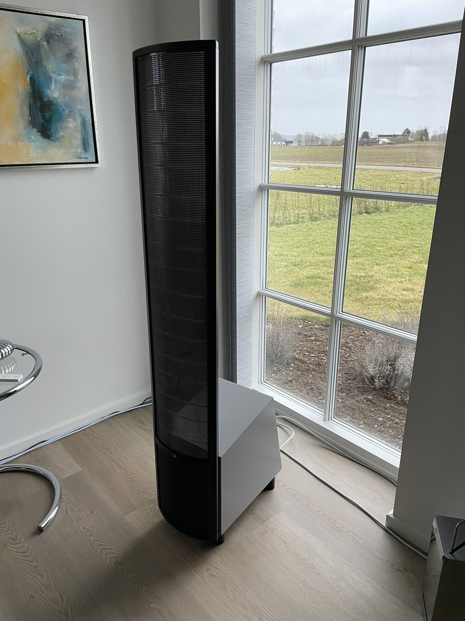

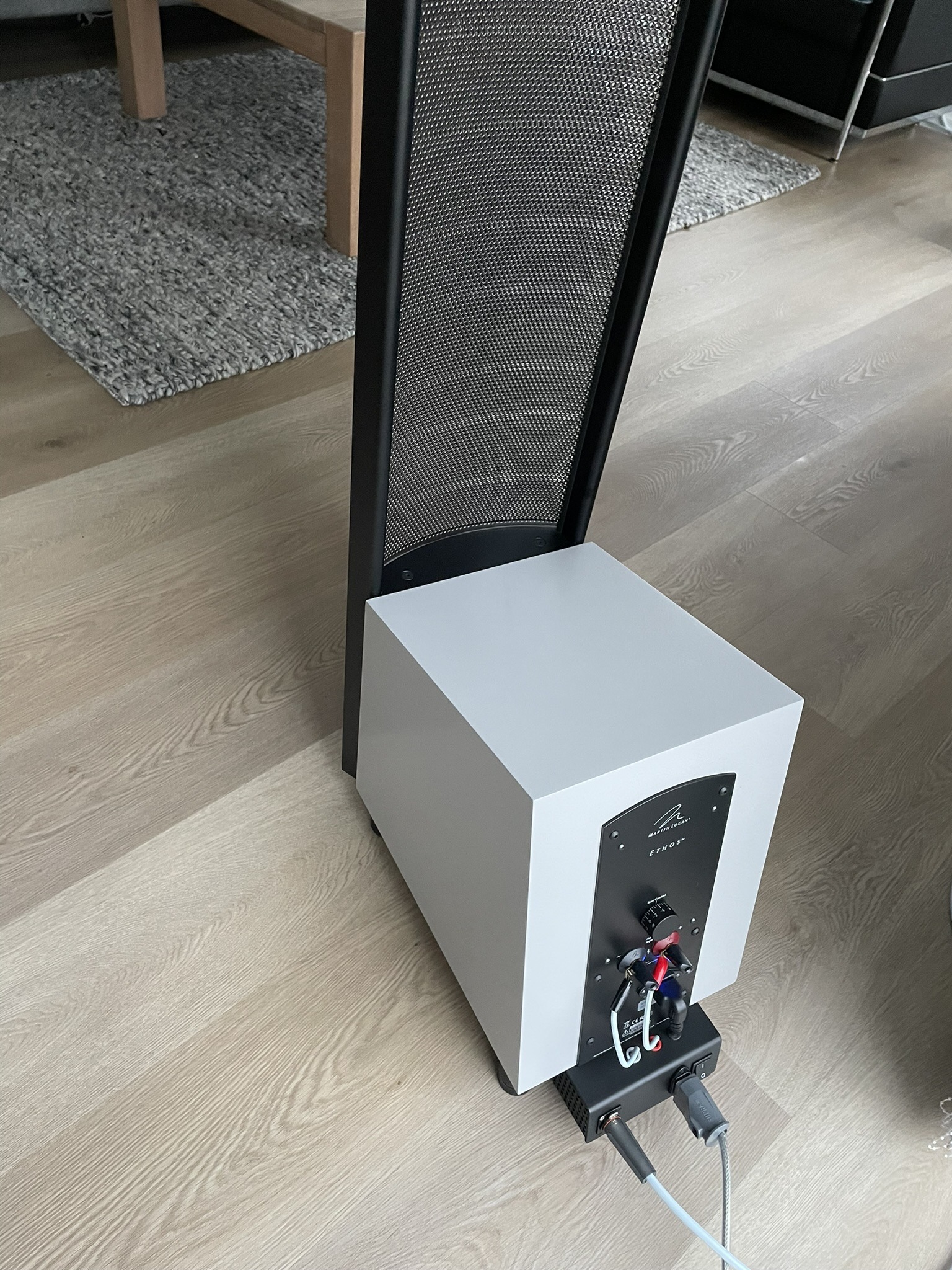

Just finished a small project adding a Hypex NC500MP under each speaker to make them active. Also had the cabinets spray painted in satin gray polyurethane furniture paint. I think it looks more up to date 2024-ish. By the way, the hypex does quite good driving the ESL load. I had a dialogue wiht Hypex (nice people!), and they confirmed that it would not be a problem with the ESL load. This is a point where Hypex differs from Icepower. Icepower would probably have a challenge with the capacitive load. Anyway, now my Ethos are fully active with hypex driving the esl's and icepower for the subs. Works nice

Nice job! Looks very smart to have the speaker the same color as the walls!
Did you happen to note what woofer is in there? Pics?

The color on the sub is actually gray, and the walls is white. They blend in nice though, and makes the speaker more discrete. The original finish was cherry.

I didnt take pictures of the bas units. They were ML branded. I have been building DIY speakers with many different brands of drivers. I have never seen anything that looks like the ones in the ML's. Probably some american stuff!?
