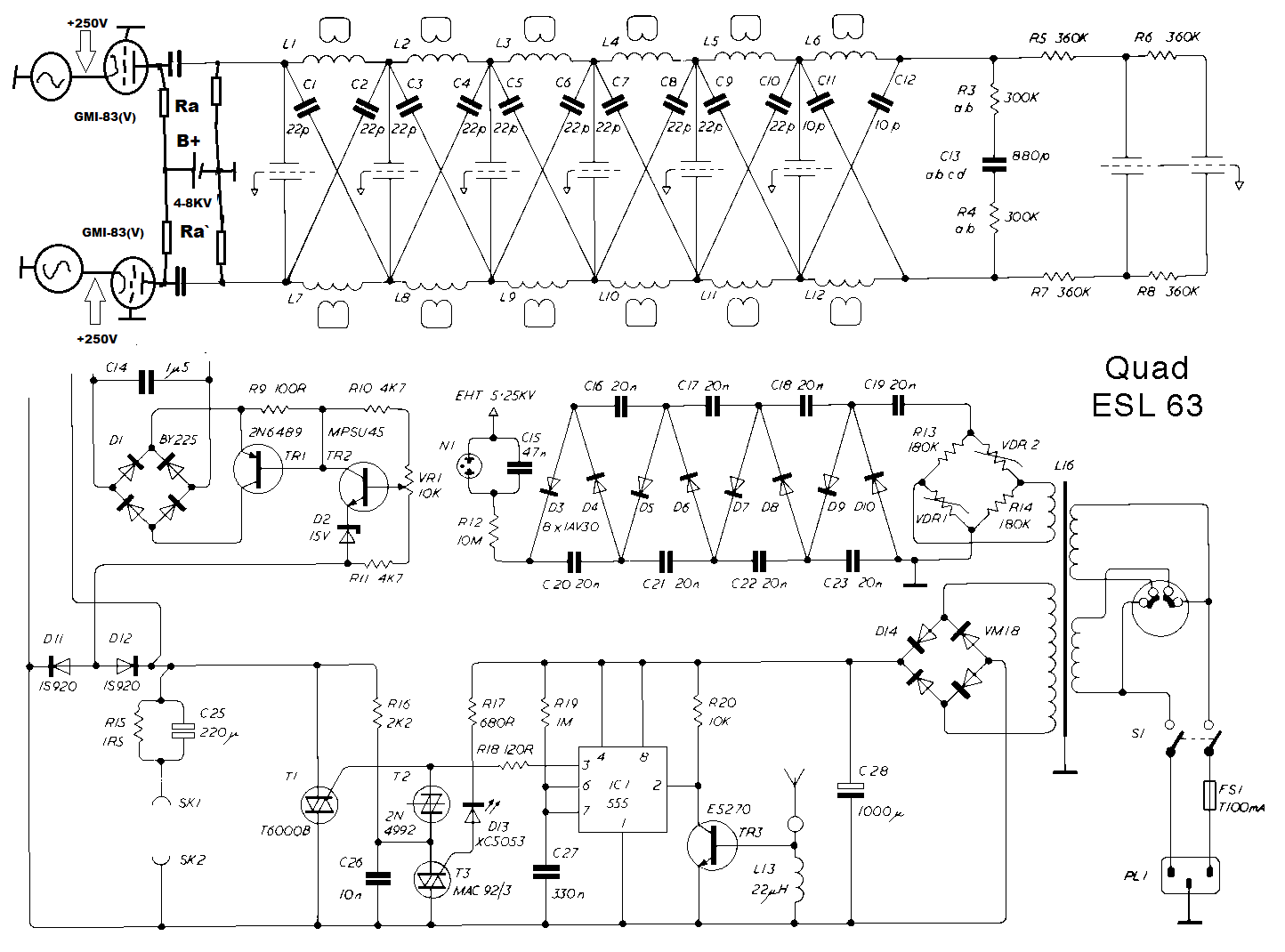

Maybe I`m wrong but maybe this can be some sort of the basic solution ? , two GMI-83(V) 60W(65W) pulse modulator tubes operating in push-pull class AB1 , with both grids grounded (g1&g2) and semi indirect heated cathodes driven , direct driving ESL stators via two high voltage block capacitors ...
edit , maybe is better solution that both very high loaded anode resistors (Ra & Ra`) to be replaced with some suitable center taped inductor ?

That looks like a suitable tube at first glance, but at 50W heater power? I'm frugal at heart.
Also, I understand Vgk should be around -300V, so current-driving the cathode (which I favor) you lose 300V output headroom.
At this point I am looking at two parallel tubes of the 6JS6 variety, inductively loaded.
Edit - it's a very nice tube. Tempting.

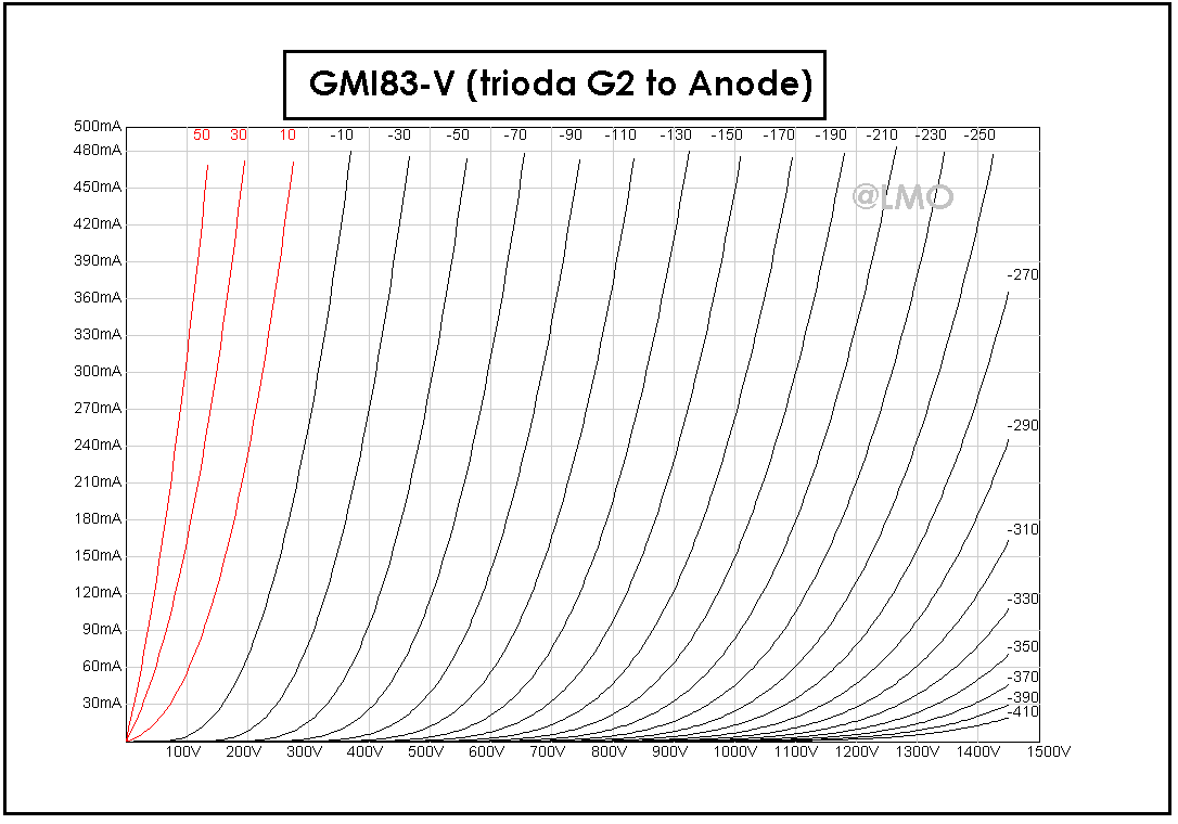

Well 50W of heater power is must for those GMI and simmilar HV pulse tubes to get very very high anode peak current , that GMI-83 actually have four in line cathodes , and that model GMI-83V have semi-indirect heated single round cathode in diameter which is something like EL34 tube bulb ,
any way 6SJ6 and simmilar tubes can be also very good solution , inductively loaded ,
btw , my idea for around +250V on GMI cathodes is to automatically get anode B+ source for let`say EL84 tube triode strapped which in the same time drives GMI-83 cathode .
