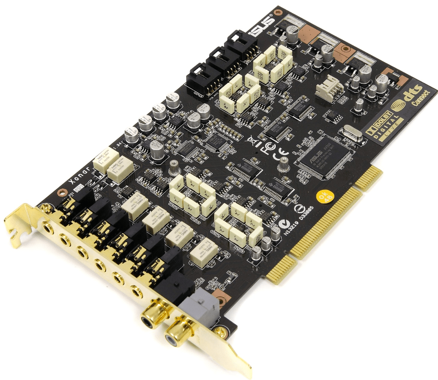

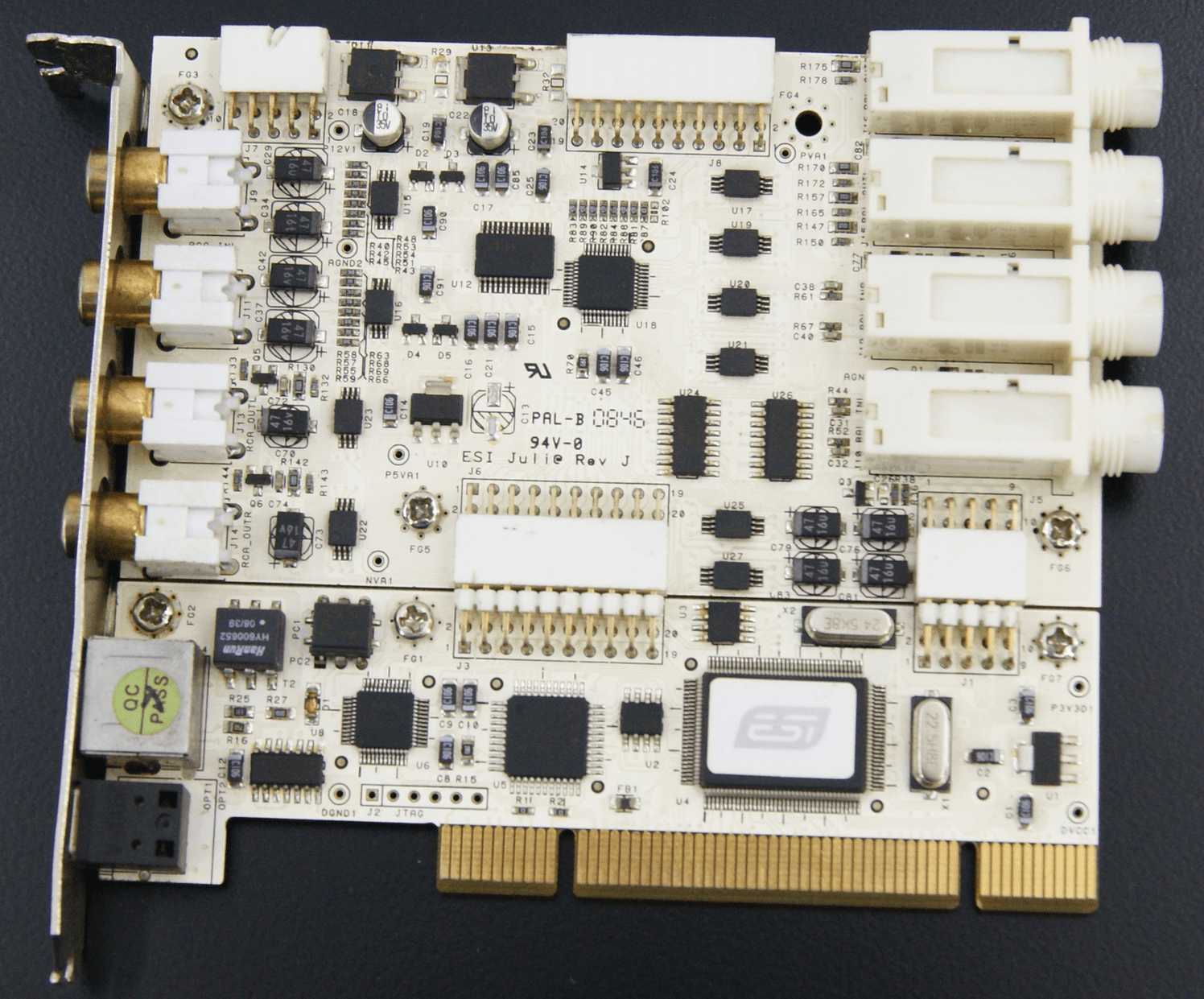

PCI soundcards (along with RS232) used the -12V, for their analog section, typically followed by a regulator - see the linear regulators on the analog board of ESI Juli@:. BTW ... I've never seen a use for (-)12V - [pin 14] .... Any sound card op-amp will use a separate (-) buck convertor.
Asus Xonar D2:
Since PCI-e has no -12V, PCI-e cards have to use the buck convertors.
The ATX -12V has been specced only at 0.5A.
