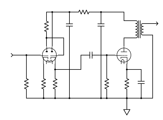

TP 2 is 1 leg of a 2K2 resistor that is fed directly from the output tx, It in turn connects to a 20 ohm res.. The 2K2 resistor is shunted(?) by a 330u cap.

Ok, this is a 12AU7 or 12BH7A input voltage amplifier, which is direct coupled to a 12AU7 or 12BH7A cathode follower,
capacitor coupled to the single ended, self biased output tube. Pretty simple. The secret sauce is in the parts quality.
Just measure the DC voltages (plate, grid, cathode) of each tube, with respect to ground.
Once for the good channel, and again for the bad channel. That's about all you need.
And list them here.
V1 plate =

One thing, is it possible to install the tube sockets wrong on the board, are they keyed? That does happen.
Here's an approximate schematic from publicly available information, but the optional feedback is not shown.

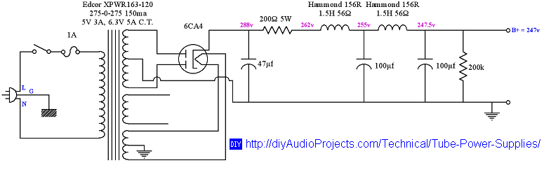

Another thing that might be measured are power supply voltages. Tube amp power supplies often look something like this:
There is typically a transformer, then a rectifier, then some stages of RC or LC filtering. At each stage of filtering the voltage is a little lower (as indicated in purple numbers in this example). If there is a power supply that looks something like one in above pic, you could measure the voltages at each point similar to the example.
Of course, this assumes you know how to measure high voltages safely. Do you know how?
