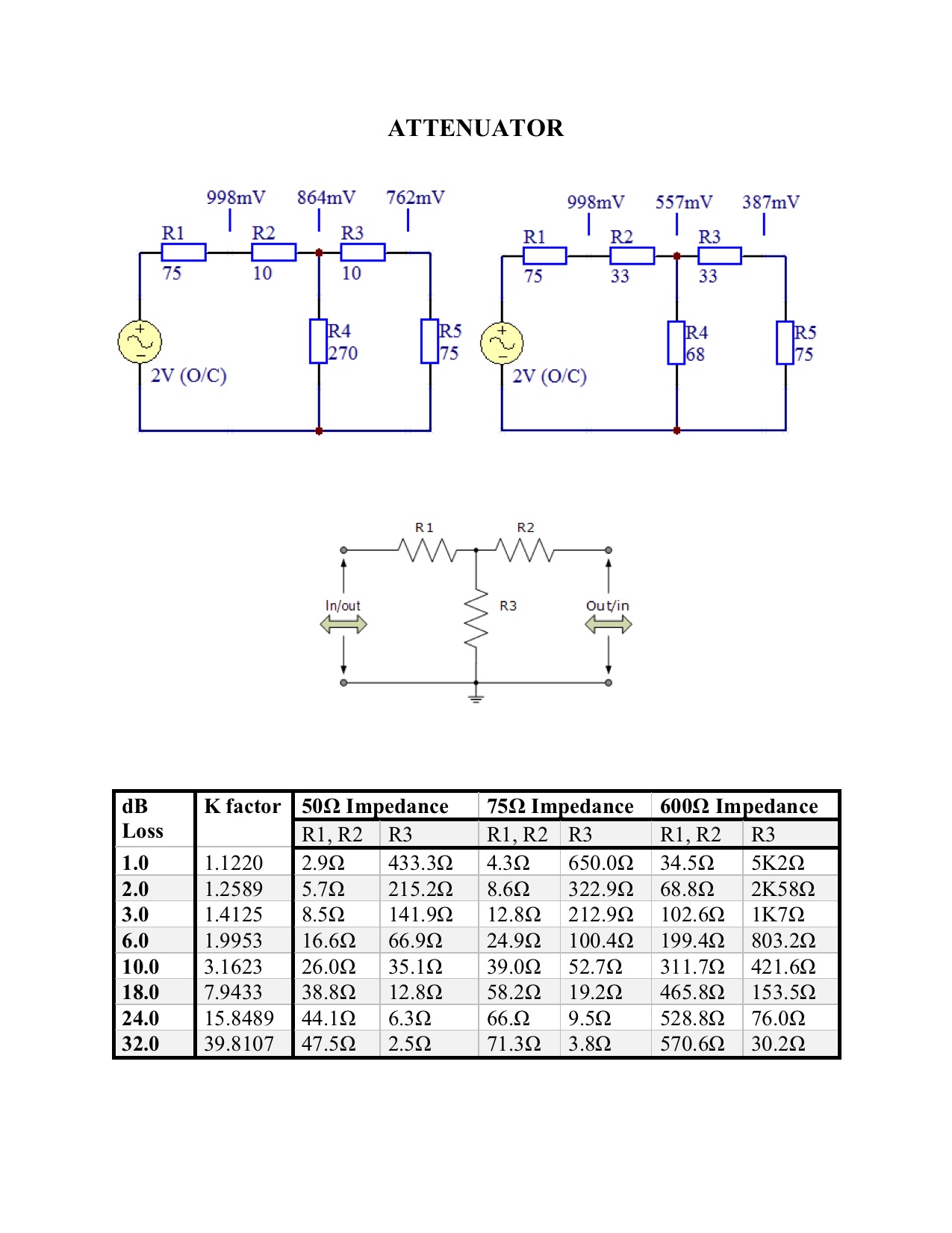

My current source for the TU-8200R is a Chord Qutest DAC with output impedance 0.4-0.9 ohm at 1 V (as measured by Stereophile). Will there be a problem if I use a 75 ohm T attenuator like the ones below?
