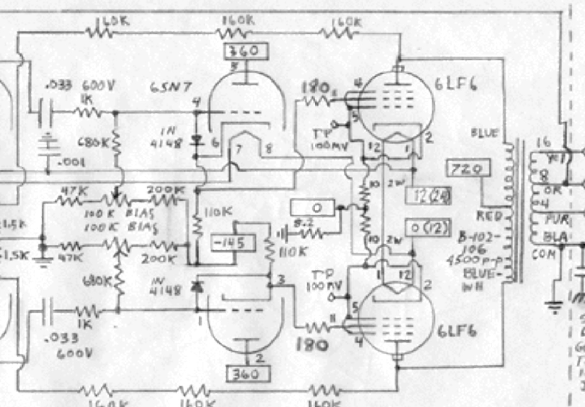

Here is an other approach (see attachment).
This is how i would do it (off topic as it is not "enhanced" mode but true triode with EL509 tubes or 6LF6).
But be carefull as it can byte you (Plus 720V and minus 145V are required).
It is a push pull version but can be easily converted to SE.
Here you can use a small tube to drive the screen as not much current will flow (as it is negative instead of positive charged)
Good luck and have fun !

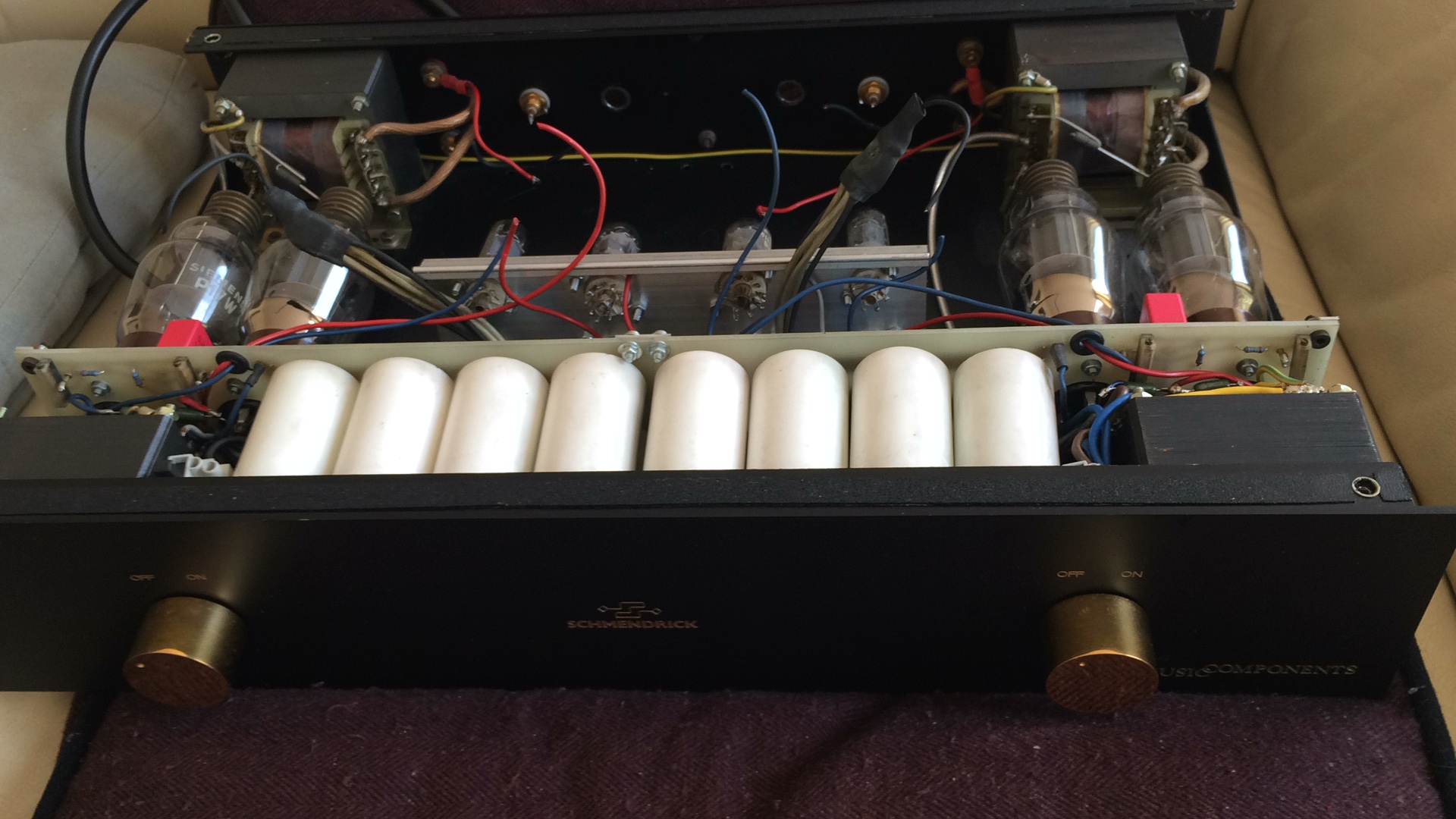

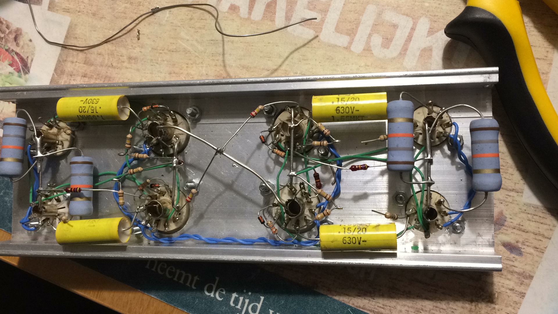

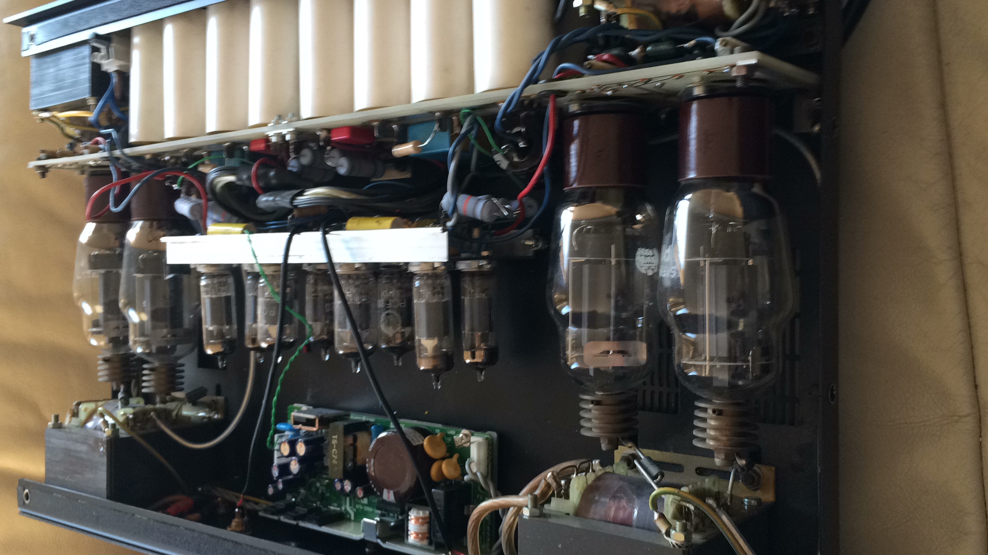

A project i did for a friend:
"Brocksieper Music Components Schmendrick"
After the mod this thing really rocks!
Screen grid driven with very low bias voltage as grid 1 is now shorted to cathode.
+650V anode voltage fully balanced design.

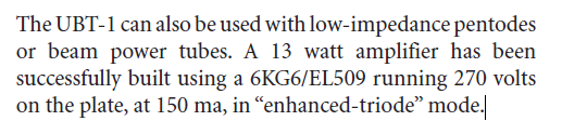

Perhaps I should mention that I'm planning to use the el509 by JJ. And at 270V on the plate and at 150mA. Since that has been done with the el509 and UBT-1. So any dc coupled examples are not a shoe in for me. I'll just go with power drive/source follower...it it the same thing?
Bas,
If you have it, could you provide a link/reference to the EL509/UBT-1 at these operating conditions, please? UBT-1 specifies 160ma max.
Following this with great interest and wish you the best. I have a pair of UBT-1s sitting idle, as well as several NOS 6KG6as.
10mA to the screen not in total !
I would sell the 6KG6 tubes and buy a double amount of EL519 instead or trade. Not because there is anything wrong with them but there are people who have amps using these tubes and having difficulties getting replacements as the sockets are different. In many cases replacing the sockets in not an option.
