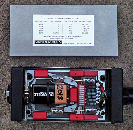

That's very nice. Do you have a schematic for it, by chance?Built my (SE) versions back in 2010 for my Quads and Vandy sub combo. No balanced versions alas..
These dip switches are used to select the capacitors and resistors that form the amplifier's high-pass filter.How does the switching work? I assume that's why the battery is in there
I believe the purpose of the battery is to bias the two capacitors to "improve" the sound quality. Maybe @AVWERK can verify the circuit.
Regardless of it's effect on sound quality, what effect does a bias voltage have on a circuit like this?I believe the purpose of the battery is to bias the two capacitors to "improve" the sound quality.
It’s been 13 years since I made this and going on memory the battery was used to put a voltage on the shield like the Audioquest series of battery biased cables and was a real pain to implement
I believe JBL had something valid on keeping caps biased I recall ? but don’t hold me to it..
I did have one battery drain one time and could not tell it’s effect on the sound stage so building a set without the bias
would make it easier
I went off pics of an existing one for reference and hand drawn schematics. I will have to look around for it

DC bias is to improve the linearity of capacitor. JBL introduces DC bias with electrolytic capacitors in its crossovers. However, I don't know if film cap need DC bias to improve it linearity.Regardless of it's effect on sound quality, what effect does a bias voltage have on a circuit like this?
http://diyaudioprojects.com/mirror/members.aol.com/sbench102/caps.html
https://electronics.stackexchange.com/questions/292682/are-film-capacitors-affected-by-dc-bias

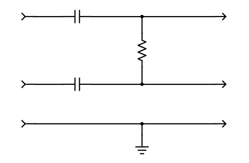

Based on the images, I come out with this schematic:
For 50kΩ amplifier input impedance (NONE dip switch on), capacitance = 0.0302µF,
for 10kΩ to 33kΩ input impedance (dip switch #8 on) capacitance = 0.149µF,
for 5kΩ input impedance (7,8 dip switch on), capacitance = 0.224µF.
Can someone verify that the above schematic, components values and calculations are correct? Thanks.

@SoaDMTGguy
Please check and post the component values in your M5-HP, especially the capacitor across the battery terminals.
For the balanced version, just duplicate the capacitors, a 10MΩ resistor and 2 extra dip switches on the inverting phase and install a toggle switch to move the shunt resistor ground connection to it, this will allow the user to select a balanced or single ended connection.
