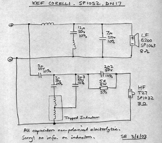

So, opened up a mint condition KEF Corelli speaker set. Manufacturing seems to be Mar-May of 1978 based on the stamps on the driver (1974), Dividing network and enclosure.
Everything looks in great shape, just looking to replace the Caps and spotted the resistor starting to fur out. W22, 3RO.
I believe the 3RO means 3 Ohm resistor. Is the W22 the wattage? Google tells me it's a type of wire-wound resistor.
What would be a safe wattage/power rating to not blow/damage the T27/B200 drivers.
Thanks in advance!

For anyone looking for the SP1052 dividing network photos:
These are Welwyn resistors and W22 is 7W. 3R0 = 3 OhmIs the W22 the wattage?

Thank you for that useful reference sheet @Wieslaw Lipowski ! Waiting on replacement caps and resistor for rebuilding this. Working on the Tangent Crossover in the meantime.
Is that resistor broken or out of spec?The closest I'm getting is 5% tolerance at that rating
