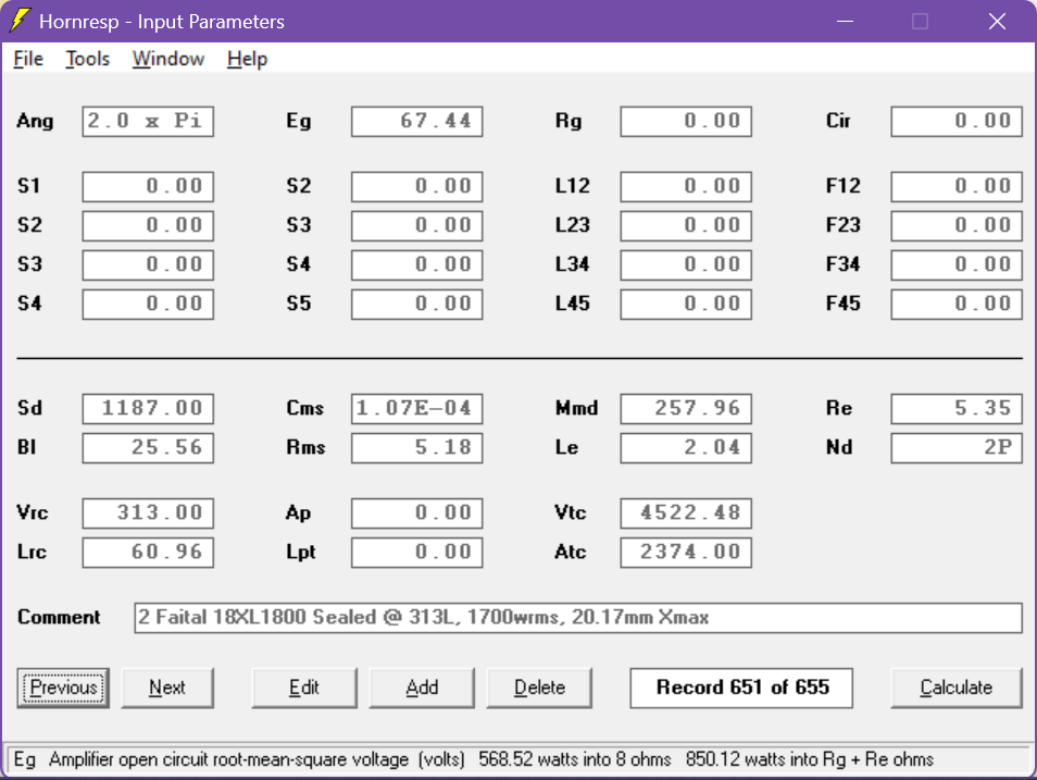

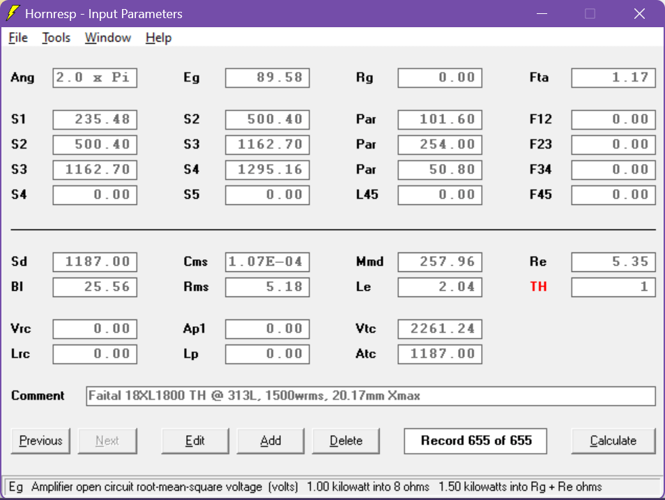

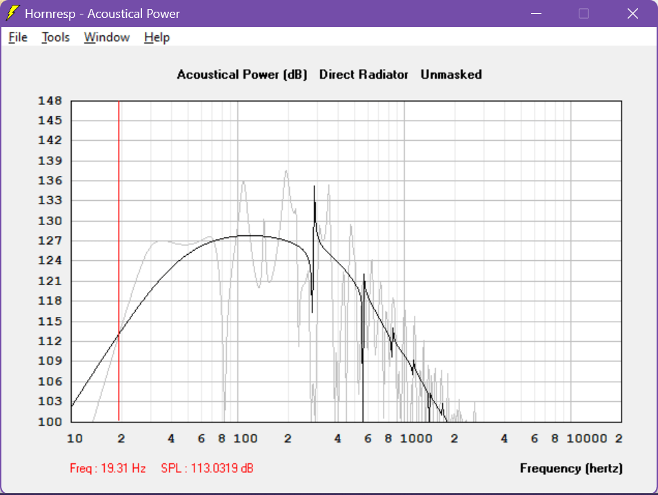

I considered ported @ 13-15Hz but didn't want to make any compromises regarding port velocity and GD. I can feel 10Hz with my 4 subs and that's good enough for me
