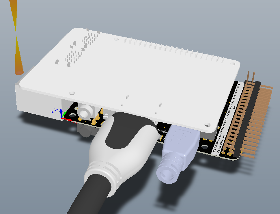

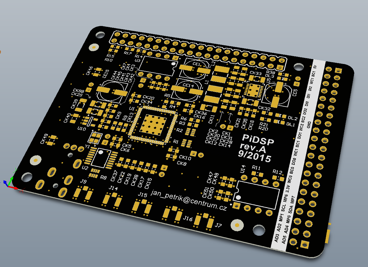

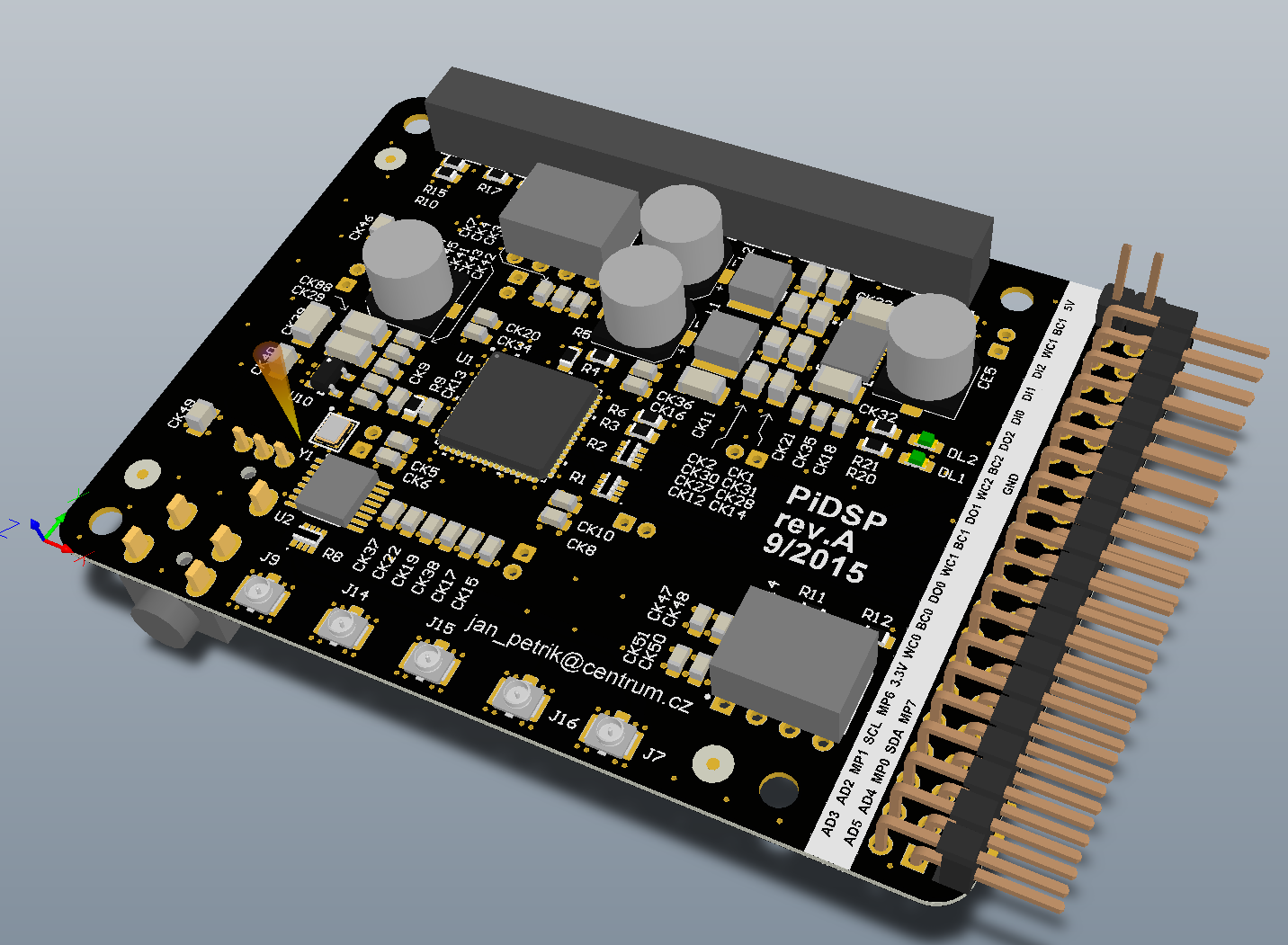

sorry for a long time without any updates/replies. I was spending my summertime outside. I got back to the project at the begging of September. It took way longer to get the board to shape that I liked(enough plane capacitance, good grounds etc.) on 4 layers.... Finally, it's done.
I've just placed order for 10 prototype boards at Elecrow, let's see how log will it take - my estimate is 2-3weeks. It's just guess, I haven't ordered from them before.
The design is a bit different from last time. I wanted to have something to play with and play on(my speakers are waiting on it), so skipped larger 10cm wide variant with smps for opamps in favor of smaller RPi HAT module(changed name to reflect it).
Power supply:
LP5907 for oscillator, pll, and ADC
LM3370SD for 3v3 and 1v2
Clocks:
single crystel oscillator
selectable external clock
4 MCLK outputs via U.FL
I/O:
bidirectional to RPi
3x full I2S outputs
3X I2S input with shared bit clock and world clock
4X MP
4X AD
SPDIF IN - 3,5mm mini toslink :)

Question is how good the ADAU1452 is at removing the jitter from the RPI I2S port which contains quite a lot jitter. Anyway, RPi can be used as a control front end to DSP anyway, which enables the use of wireless technologies. So you could for an instance have an iOS or Android GUI controlling the volume and the input source selection for the DSP running the digital crossover application.
