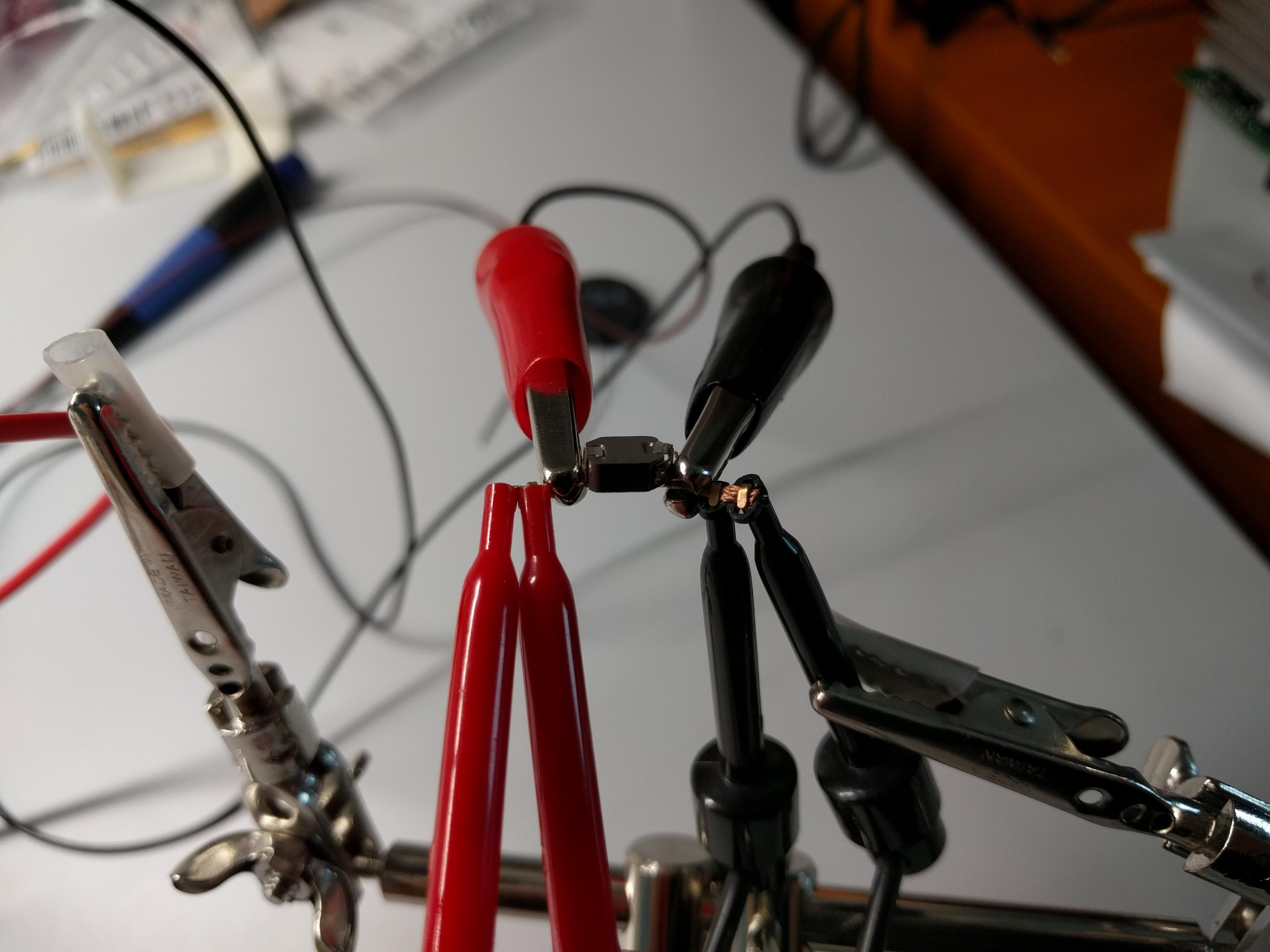

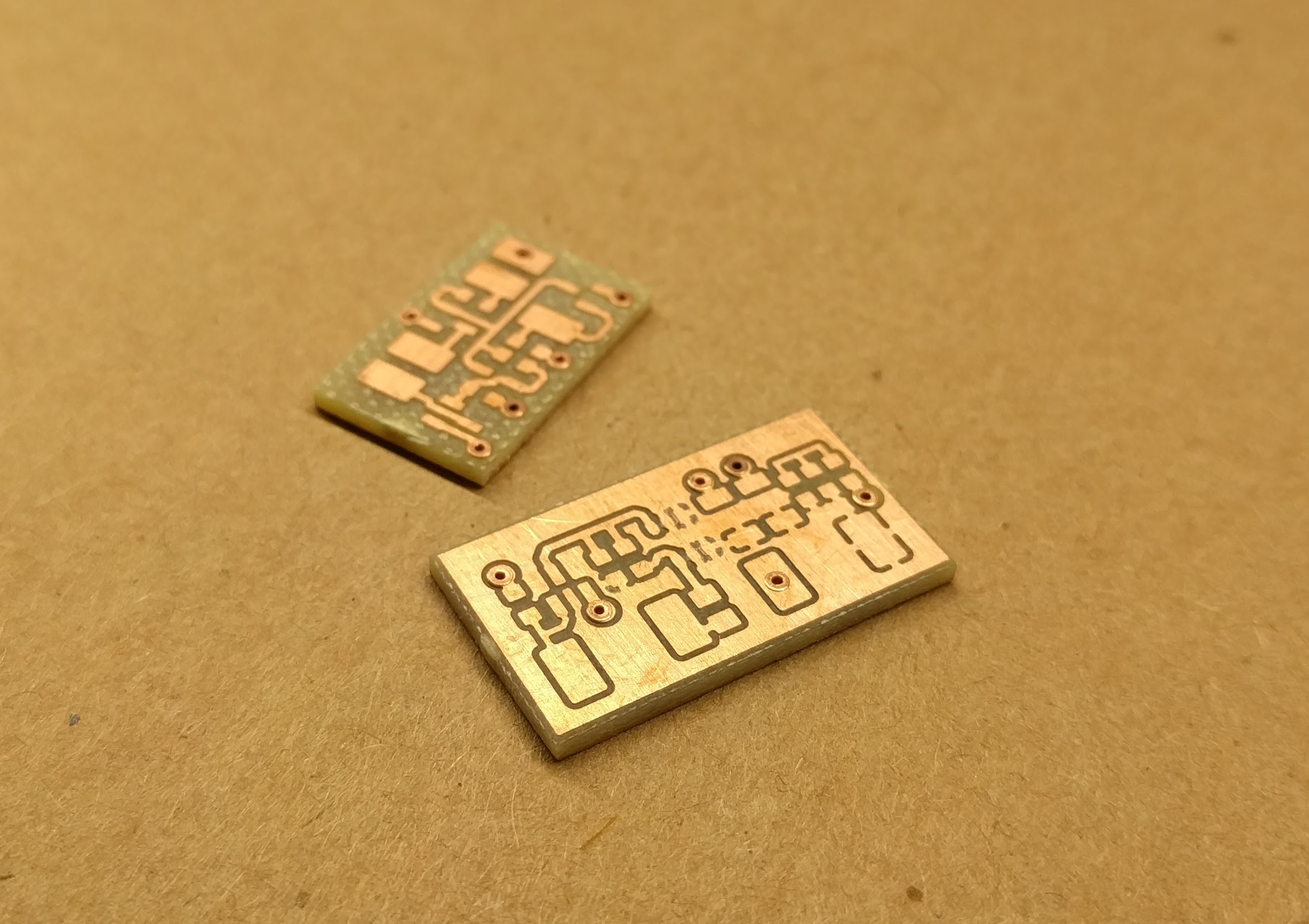

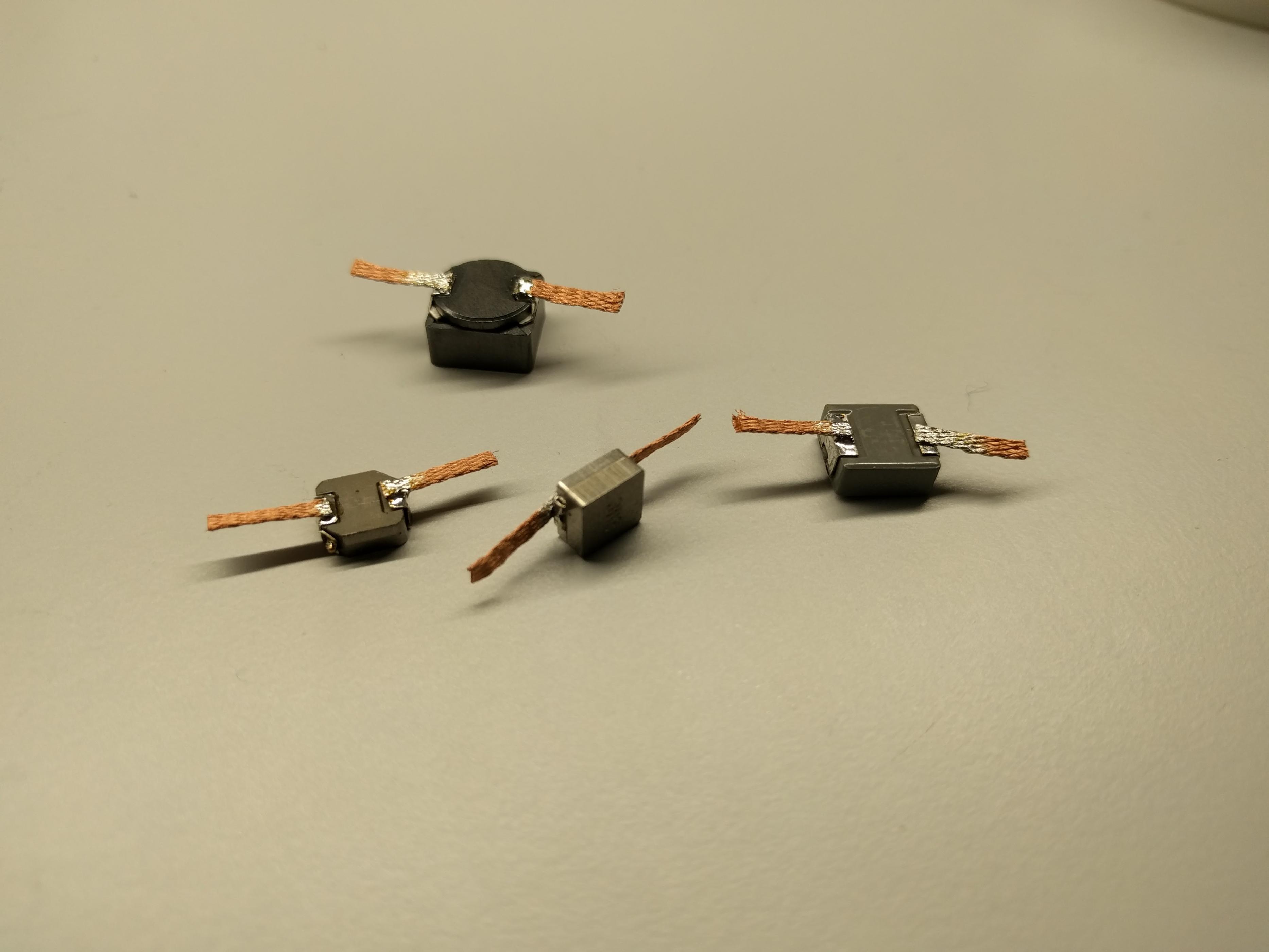

thx to my friend(thank you Honza) and his LabView skills I was able to do some crude C/W testing of the inductors. Test were rather rough - no climatic chamber/box, just a programmable power supply and constant power script in LabView. The winner is 7443340330​(not on pictures), with cca 7.25C/W. The original part has C/W roughly twice as big. I have the new part soldered on one of blue boards and ready for some more testing :)

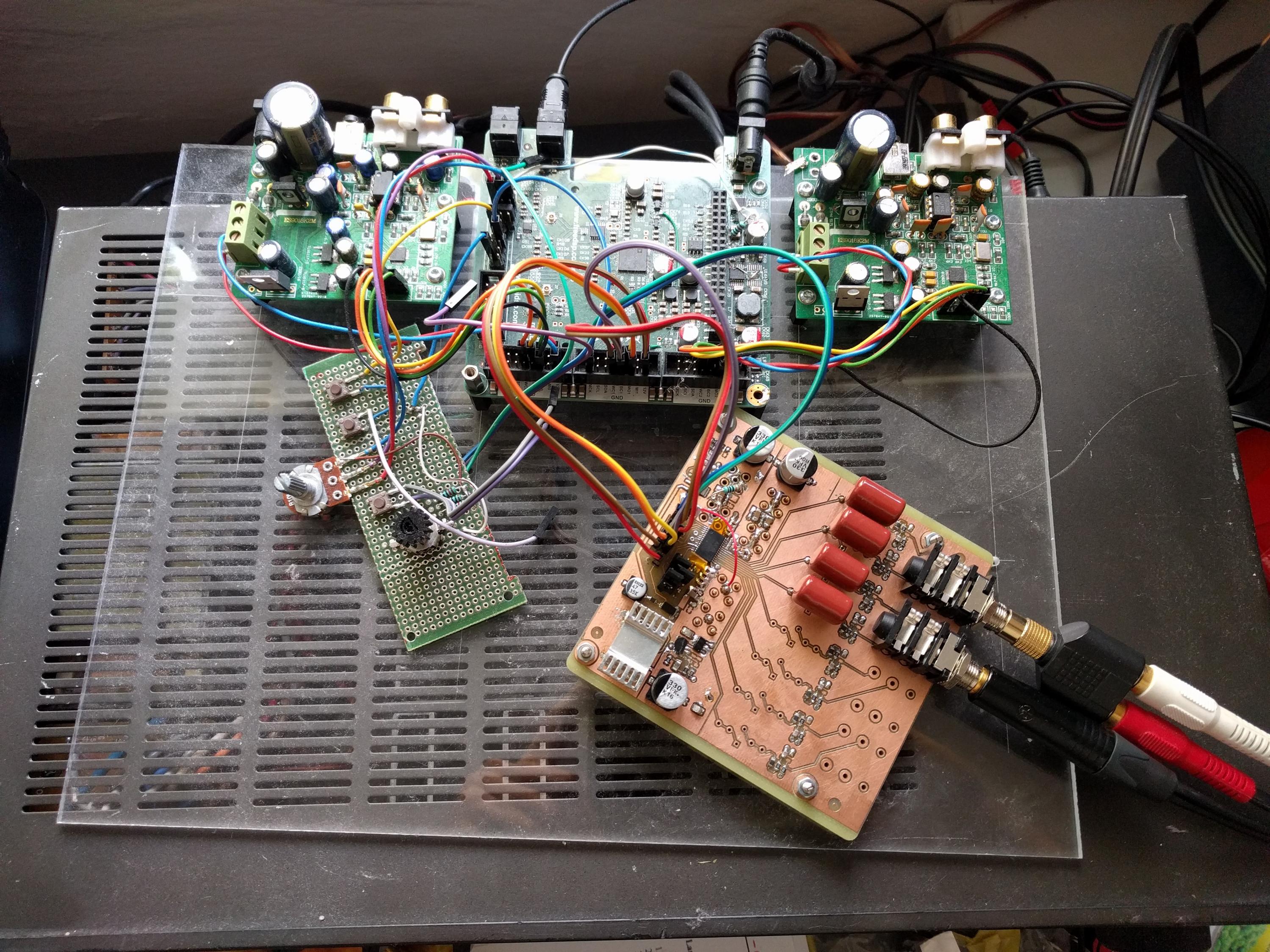

Layout is almost done, I'm going trough DRC checks and pondering about some footprint updates. Also two variants of rotary encoders are on the way - one from bourns, one from Alps.
Question for you guys (and gals.) ), do you like dents for volume control?
Take care,
Pitrsek
Take care,
Pitrsek
Pitrsek -
No more 'dents,' Please - I'm already dense enough....
On the subject of 'detents,' I find them useful for variable resistors that control logarithmic functions (like some mixers have 1/10 dB detents, that let you quickly reset levels in between 1/2 dB markings. In all cases, they're useful where the circuit values are controlled in a predictable, step-wise fashion - so you want to hit a known increment quickly and repeatedly.
Indented controls seem less useful to me on linear, analog, or continuously variable circuits where whatever value they might have in repeatability is nullified when the setting you need lies right between the "!@#$%^&*" detents.
For example - if you're using a rotary encoder to switch a resistor network which gives highly repeatable outputs - then detents (with a blessed numeric readout of how many 'clicks' have been taken - NEVER trust the alleged humans in your process...) make good sense.
OTOH - if you're using a linear or audio-taper potentiometer to set an opamp's bias or to establish channel tracking, then detents merely show your profound contempt for the device's users, since a simple pot with an accurate and readable metering circuit is a much better solution when used with even a slight degree of facility.
Now, this is just one idiot's opinion - I'm sure that there are folks here with diametrically opposed opinions, based on their own experiences - and I certain that a statistically significant number of them may also be correct.
Cheers (ducking...)
Jim

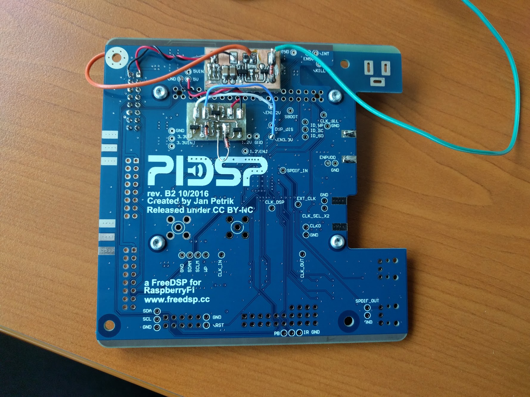

With B2 revision, there was no provision for powering down the expansion boards(ADC/DAC etc.), which is pity. For B3 revision I've designed simple high side switch. Before I close the pcb design, I just wanted to test the switch, so I lets have some test-boards. Second board is new and better power sequencing - resetting diodes and some minor tweaks. Again, just testing before using it in the the new revision.
Also we will have a AMA on 13.06. So if you feel like, please stop by!

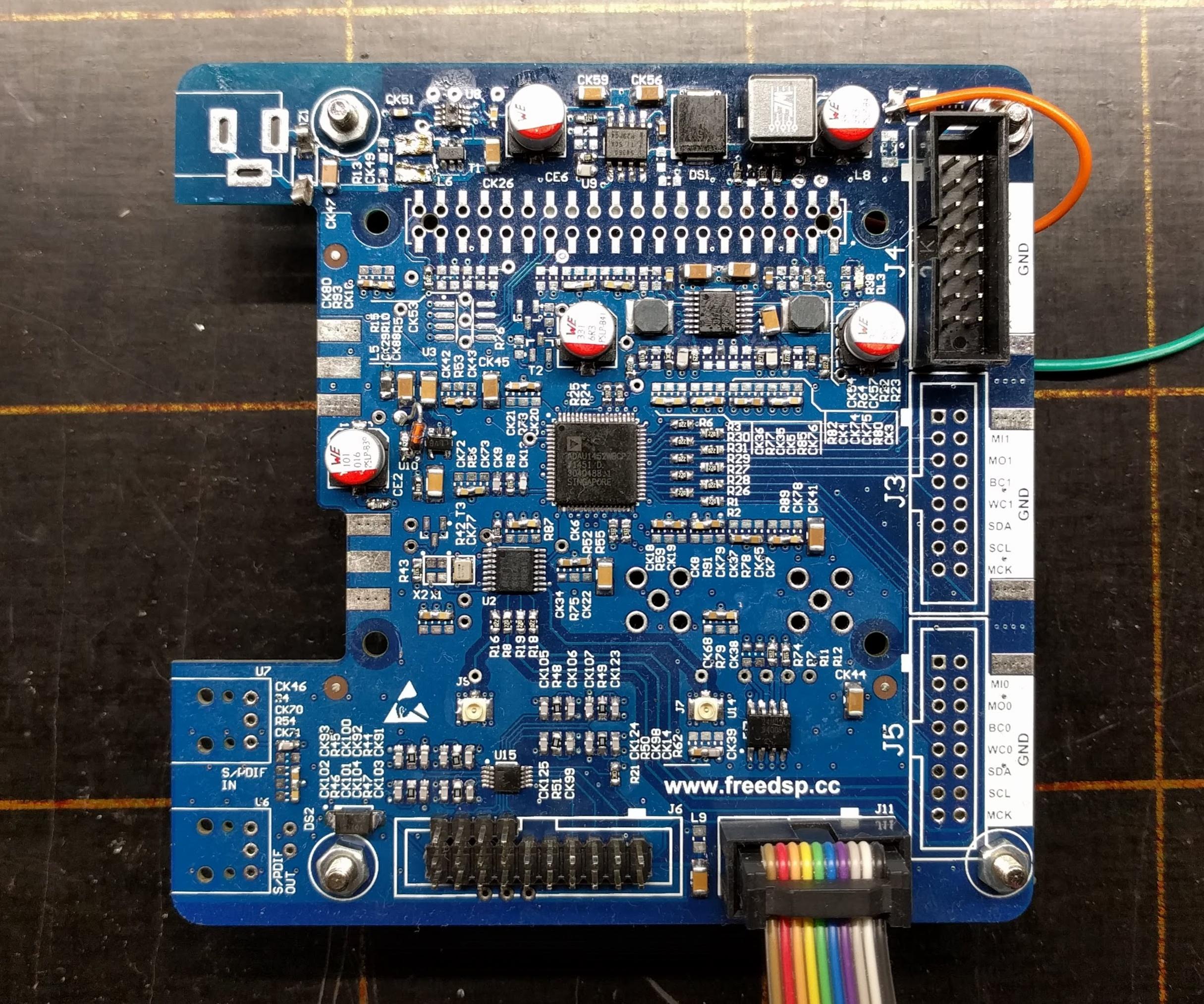

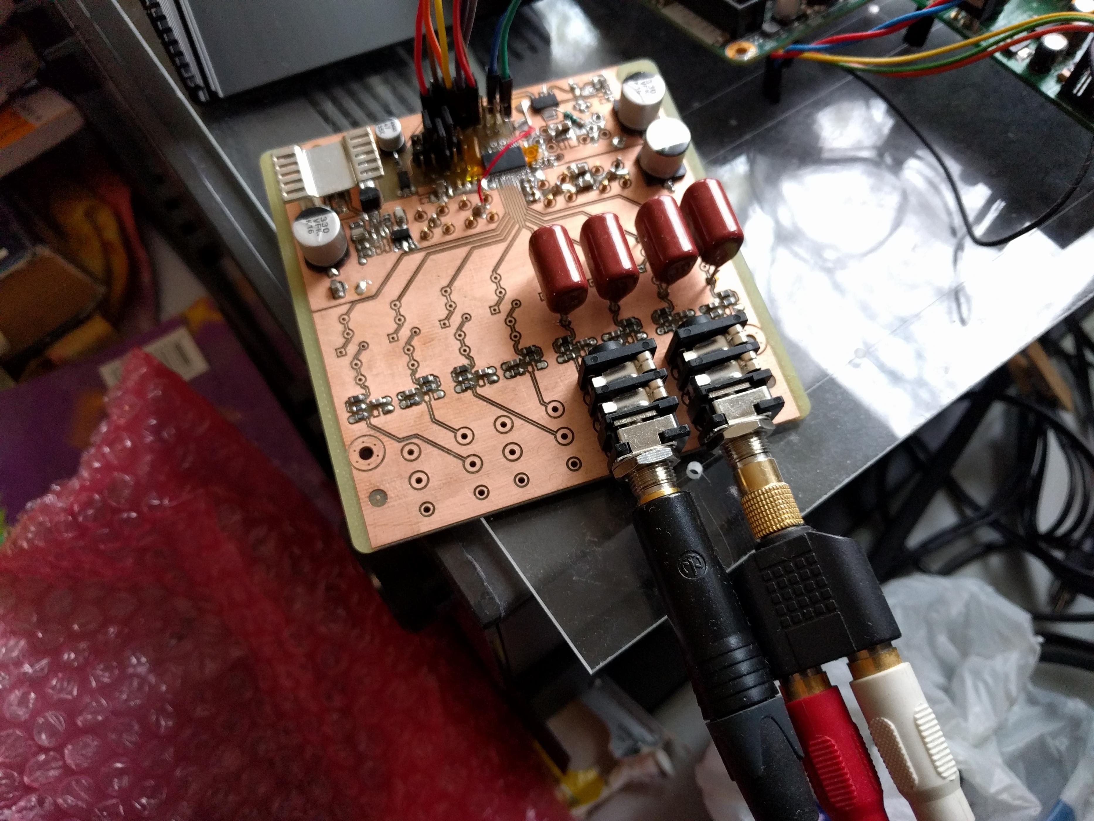

sorry all for a silent period. I was working on a budget(AK4440) 8ch DAC to go with the PiDSP. I had prototype up and running, even with I2C register setup:). And was about to finish final board design, when I discovered that AKM decided to EOL this chip.... was in a bad mood for a while.
Anyway, I'm testing the blue board with all the changes.
I'm sorry that updates are few and long between, the thing is that the project has been in development for so long that my drive is not what used to be + other projects and life in general :eek:
@shuksan: Before the failed AK4440 DAC I've worked on DAC with AK4458 .Decided to do AK4440 instead - easier and cheaper. I'd be happy to have a chat about the DAC if you'd like.

I was working on a budget(AK4440) 8ch DAC to go with the PiDSP. [...] when I discovered that AKM decided to EOL this chip.... was in a bad mood for a while.
When I look at the available options for the FreeDSP expansion boards I think there is room for some "budget" IO board for starters and tinkerers. Expcecially for the PiDSP because it doesn't have any IO's besides the SPIDF ports. I'd be building something to become "in stock" and can be purchased pre-built and ready to go so users can get involved in FreeDSP easier. For me personally, I purchased a FreeDSP Classic but never purchased the parts or soldered it together yet. :)
I want to make an expansion board for FreeDSP using TLV320AIC3104 (or possibly 3106, because it has 4 i2C addresses. The 3104 would require an I2C multiplexor). What's nice about these codecs is that if wired right to a Header connector, the IO can be very flexible. (RCA, XLR, 1/4", 3.5mm, etc). Each single channel input and output would be a 3 pin header (+, -, GND). For a stereo single ended IO the dongles would lead to two headers, connecting only to the +/GND pins. They have enough power to run headphones, but can also do differential line outputs or single ended outputs as well. So it becomes a "switchboard" of such. But what I find intriguing about them the most is that they are budget. The sound quality is "good enough" and "much better than a PC sound out", but it's not audiophile and therefore it's not out of reach for basic uses. They can be mass produced at reasonable costs as the chips are around $1.70 - 1.95 per 1ku.
The plan is to have 4 of these chips on one board. The result is a 8x8 IO board with all IO's being switchable between balanced, or single ended. Plus the inputs have up to 59db of gain! It would use one FreeDSP header, and would use TDM on the Serial data in/out coming from the ADAU1452. Maybe my plan is something that you find interest in. I'd be very happy to contribute to the FreeDSP project with my custom IO Board if the FreeDSP team and contributors would be interested in the help and I can get the team on my side for the project. It might solve your goal to have an 8 DAC, with the bonus of also getting 8 ADC channels as well. I believe this would be a great starter board for most projects. Very flexible.
If we find some interest I can start a new thread and start posting my project details.
