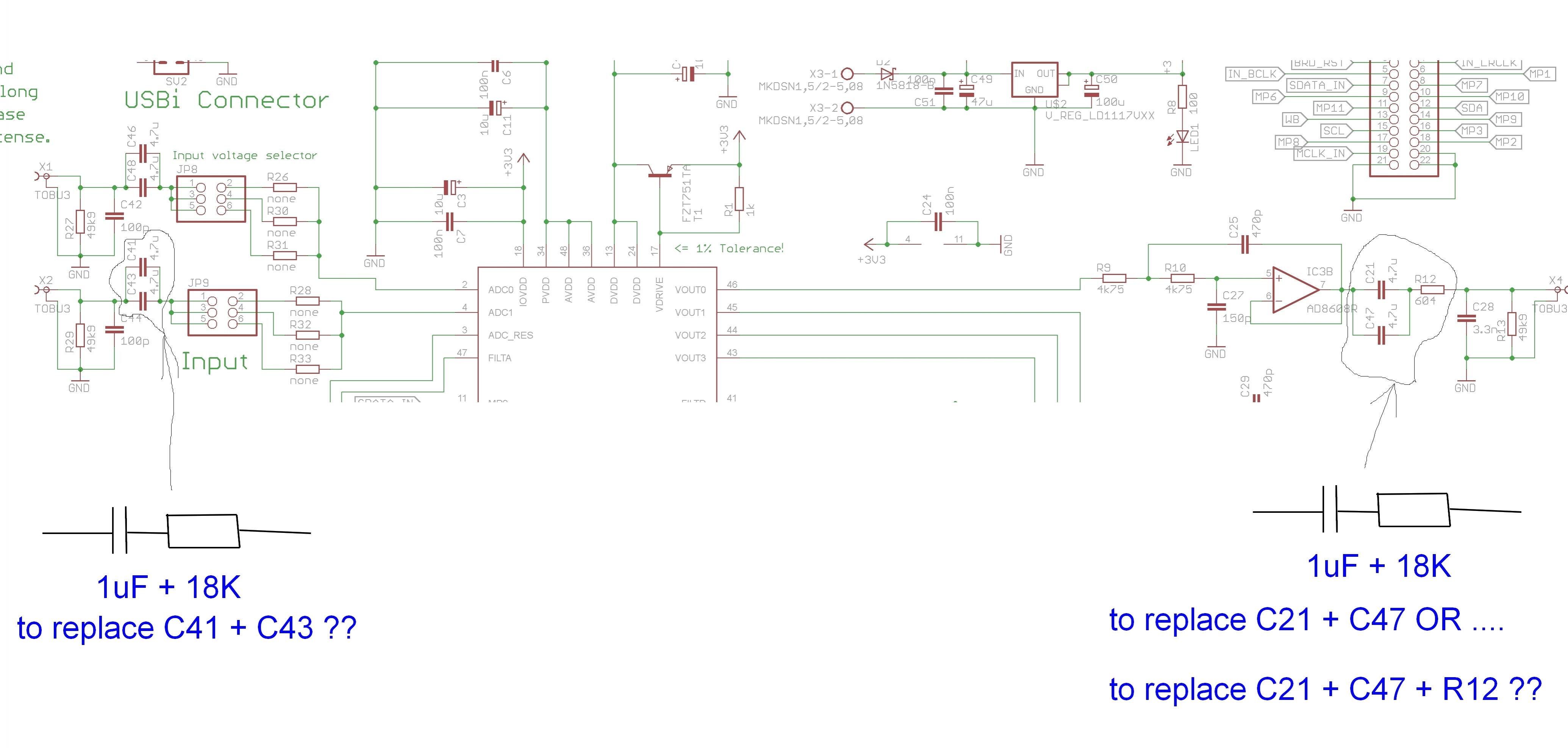

wima caps replacement ..
Hello,
I saw FreeDSP wima caps replacement information on ...
https://www.diyaudio.com/forums/dig...-4-digital-crossover-board-9.html#post4285896
Please help me to understand proper schematic ..
2 WIMA caps in parallel --> to one 1uF in series with 18K resistor or ??
Can someone draw which components ( 2 wima caps + resistors or only they .. ) can be replaced by one 1uF in series with 18K resistor ??
What means "per channel, or use 2 in parallel." ? ...
Best regards,
Emil

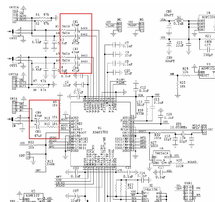

NEW BOARD + CAPACITORS
Hello everyone!
I would like to buy my first DSP card, the FreeDSP Classic SMD B, but I am undecided because I also found this card similar but very complete and well done, in my opinion
AudioDSP - development board with DSP SigmaDSP ADAU1701 processor - Kamami
What do you think? Can you advise me?
Then in order to avoid the 47mF polarized capacitors in series on the inputs and outputs on this card can I put the 1mf WIMA? How can i do to replace the polarized capacitors?
Thanks in advance for your advice

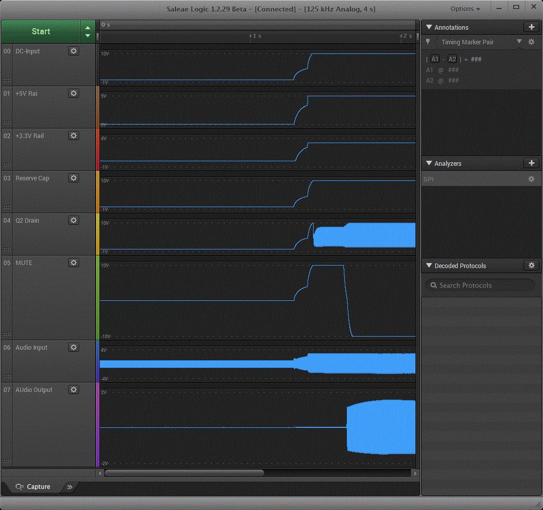

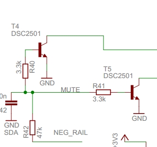

strange mute circuit.not sure if that works as intended. best to use a specialmute transistor, with the base weakly biased to a neg rail.to mute saturate the npn from a 3.3V rail using a pfet. generate a neg rail using a sw c charge pump using a clk like a LRCK or bclk from a serial DSP port, as it is only neg bias no curretn need to be delivered
Joined 2018
Hi basreflex-San,
Well, this is my original mute circuit. I never seen like this before.
I know it looks unusual, but it works as I expected.
So I inted to use this one for priventing form digital noises.
HILO
HILO

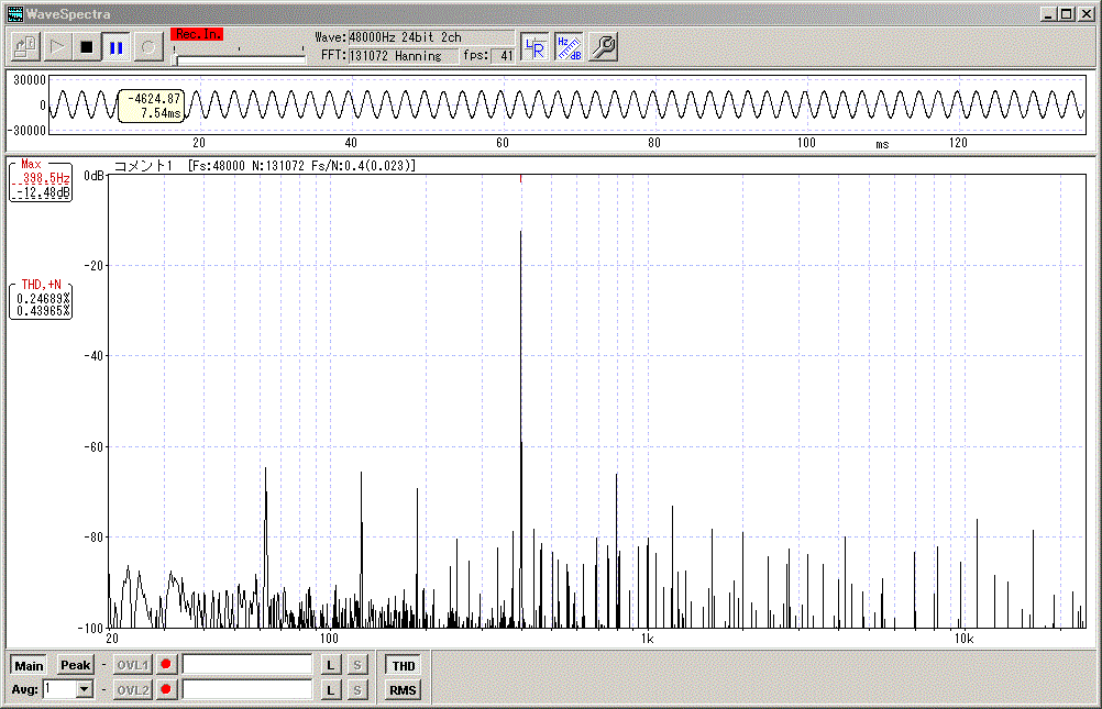

Joined 2018

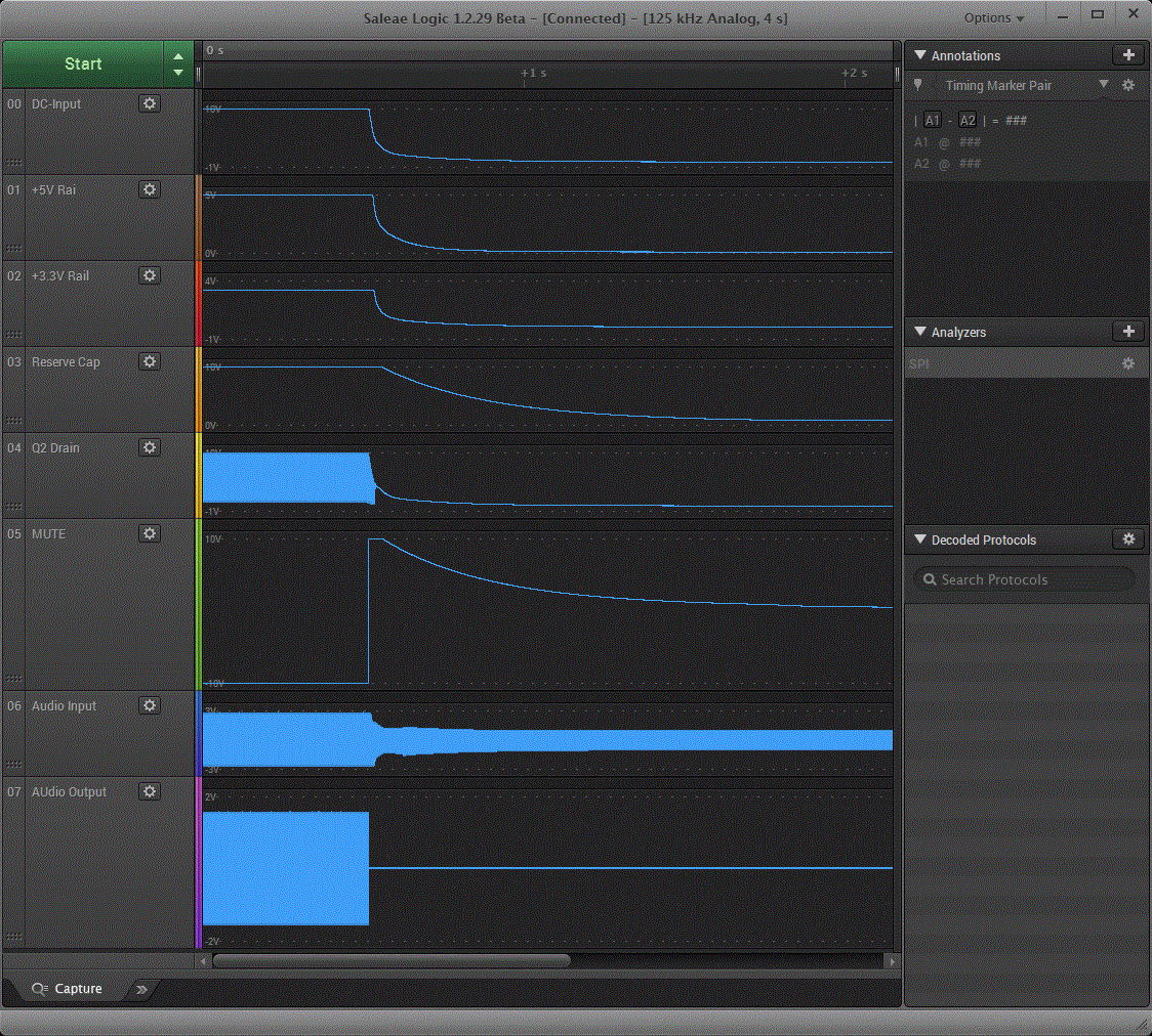

Hi basreflex-San,
My original muting circuit almost works, but it was not perfect in the point of view of Audio design. Muting release action was not enough for audiophile use. Therefore I need to add negative power supply as you mentioned before. The actual test result was shown in following URL ...
DIY DSP PROCESSOR PROJECT PAGE
Thanks for your suggesting,
HILO
HILO
Cyberpit-san
the neg rail can be simply done using a LRCK or BCK toggling at C35
the mute is done using a special mute transistor that can tolerate a high neg VBE, such that the CB diode does not add distortion. DSC2501, the collector is connected to the signal to be muted.
to mute pull the MUTE line high using a pfet out of 3.3V, when off the MUTE line is pulled to the neg rail by the 47k resistor. the neg rail can bias many mute transistors

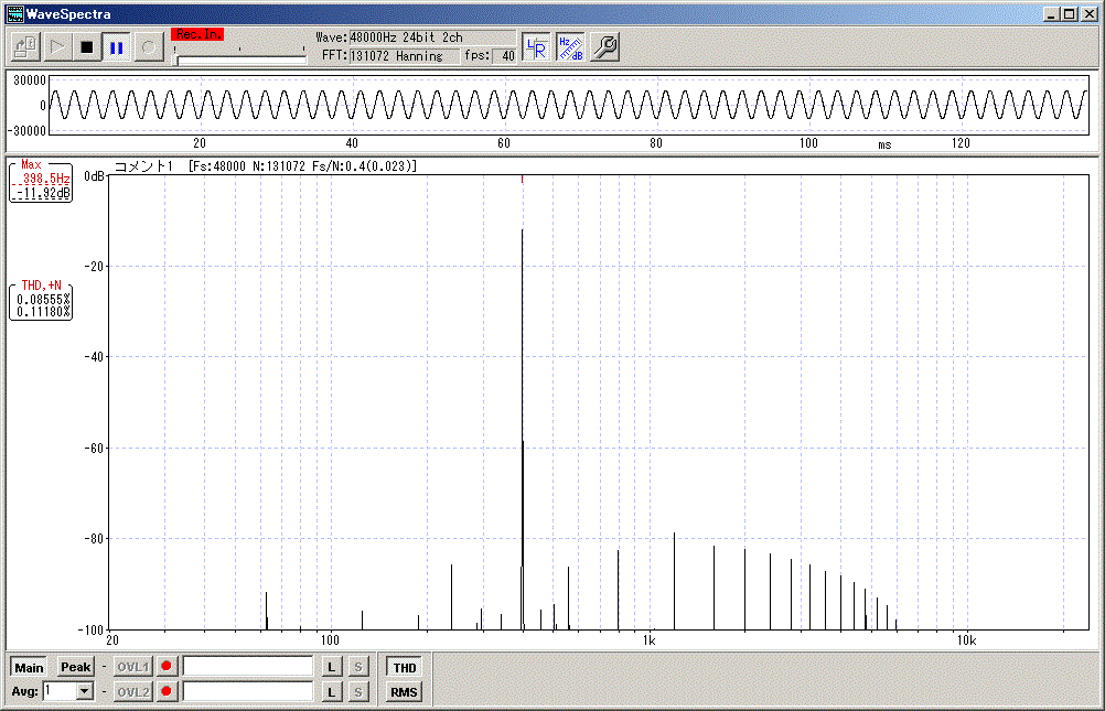

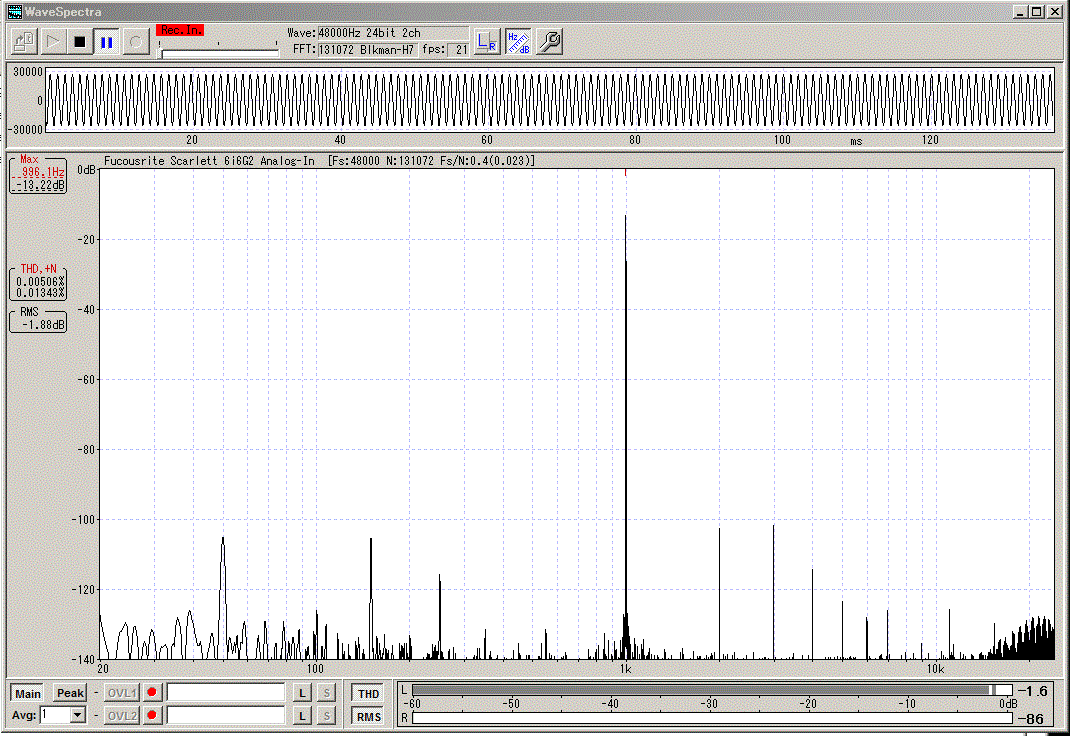

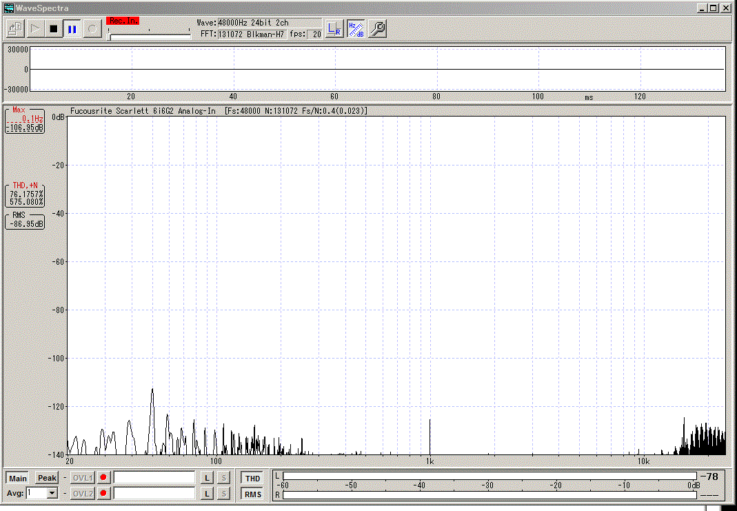

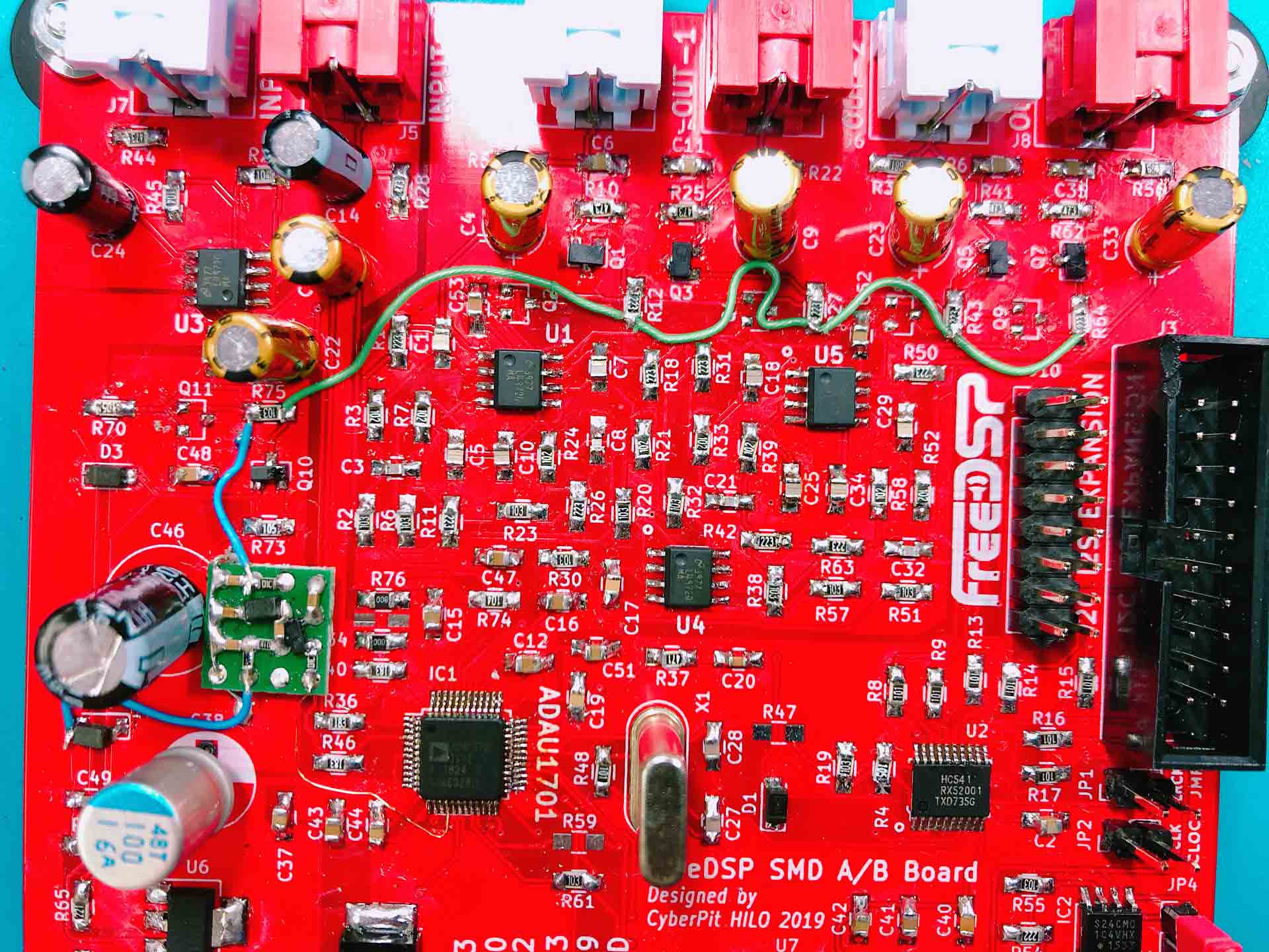

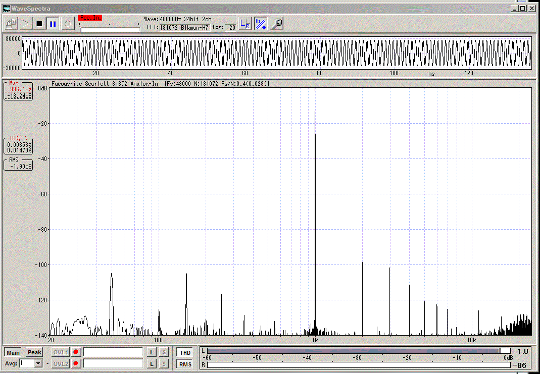

Joined 2018
Negative Biased!
Hi basreflex-San,
Now I attached Charge-Pump card on my board. The result was very fine. I could know the ADAU1701 has a good enough embedded audio ADC/DAC performances (I changed my measuring USB-Audo I/F from 16bit to 24bit) 48kHz. Using LRCK is suitable for this purpose, BCLK was too fast to drive with single-ended FET. Next version board design will integrate this part.
HILO
Hi basreflex-San,
HILO
