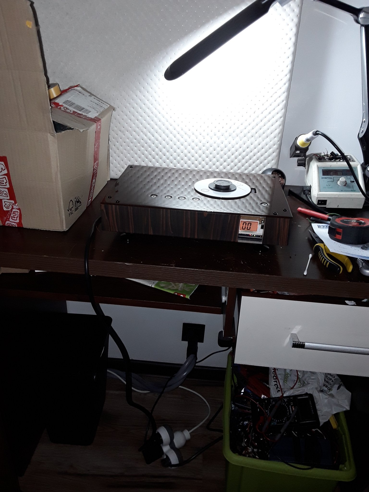

Replaced C906 electrolytic cap with 0.1 uf mkp cap. Still display 00. Laser beam good, checked using cameraYou may try to replace c906 with a good 100nF MKP.
Does laser fire-up at TOC reading ?

Already have a citizen clock installed and power supply cap upgraded before. All voltages are ok.
Poor quality PCB may be the cause. May not be able to find
the fault or oxidized part.
JVC RC-ST1, ST3 a bit different. Also, for 8V I recommend to use the LM7808, and do not do separated power supply for 5 V. Just check the 1st page: "Nothing worked better for me than a single LM7808 from National". Try to find National 7808 or old ST.
The ST3 is no good?
Does anyone have an updater list och which products that are useable?
Crystal ageing... I had that not fault but somehow irregular behaveiour if i can sad so. I replaced original after some years with better crystal. Or build a new master clock generator and connect to XTIN pin...what else can be at fault
Already installed master clock, output checked OK.Crystal ageing..
Adjusted laser trimmer and it worked for awhile, and after sometime
Toc error came back.
In fact have 2 units have similar behaviour
