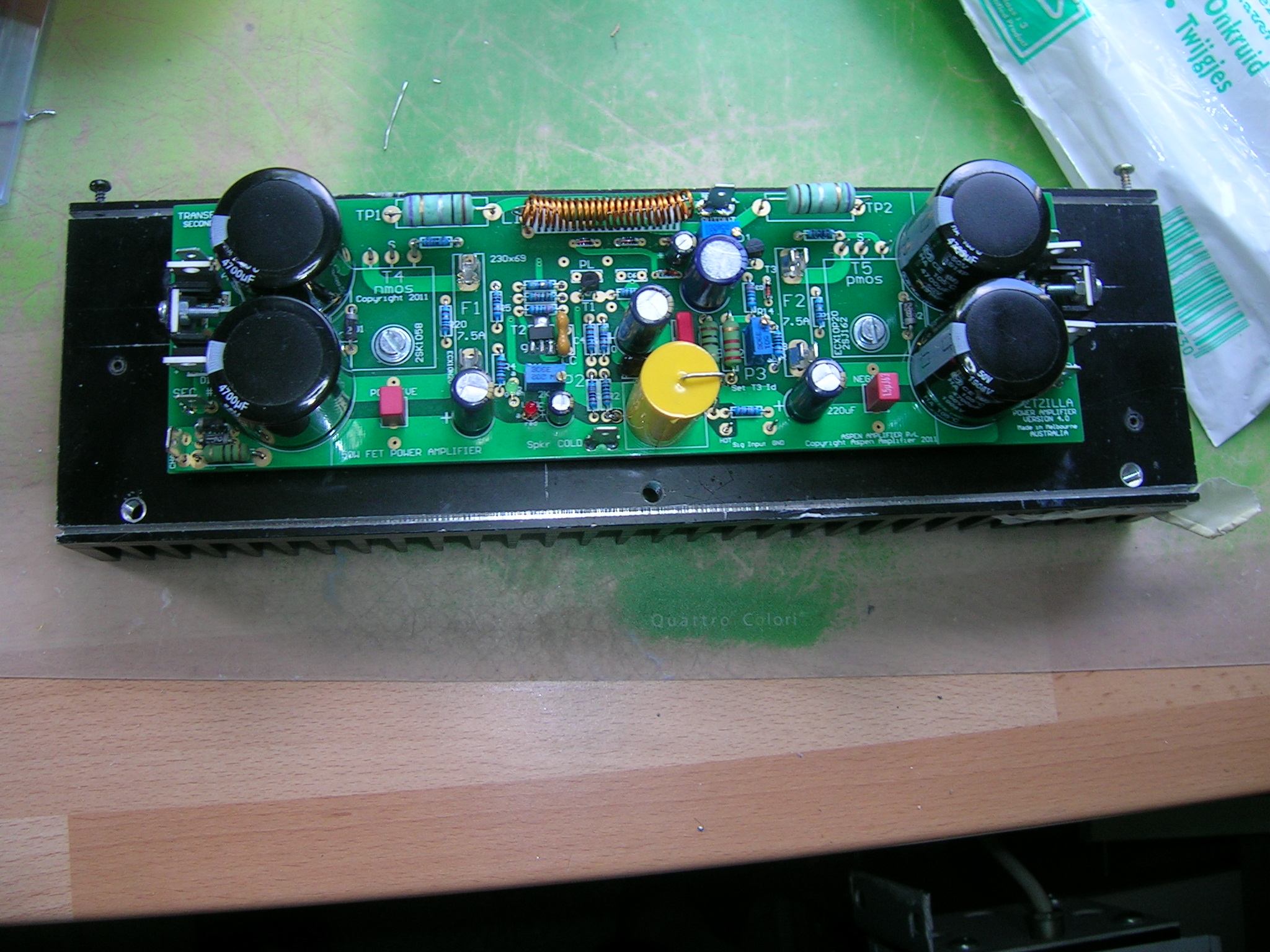

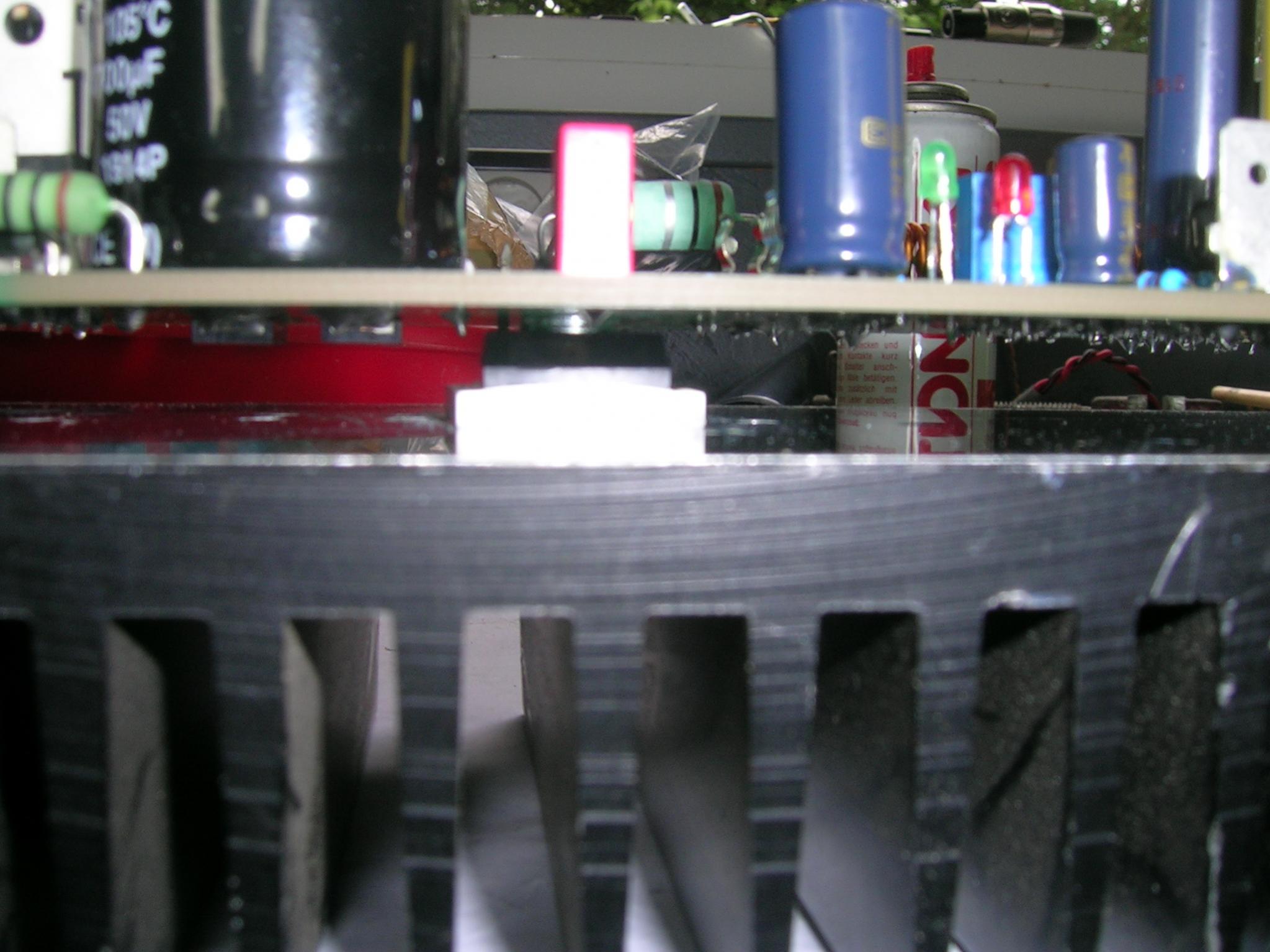

In the building doc you can read use 2 spacers between tranny and board acting as standoff.I'm using a aluminium oxide isolator of 3mm between the sink and tranny this way my board is 1 cm distance from the sink.I'm planning to srew the tranny flat against the board or would that be a bad idea?
Hugh,I've checked this and D1-2 ain't interfering the trannies at all cause I use the TO-247 Fets.Minimum 3 mm distance from the leads.
My concern is will the fets heat up the board in a dangerous way.Pointing out my question also to AndrewT
Edit : did use the spacers anyway,now there will be an airflow between the board and the top of the trannies
Here's the pic

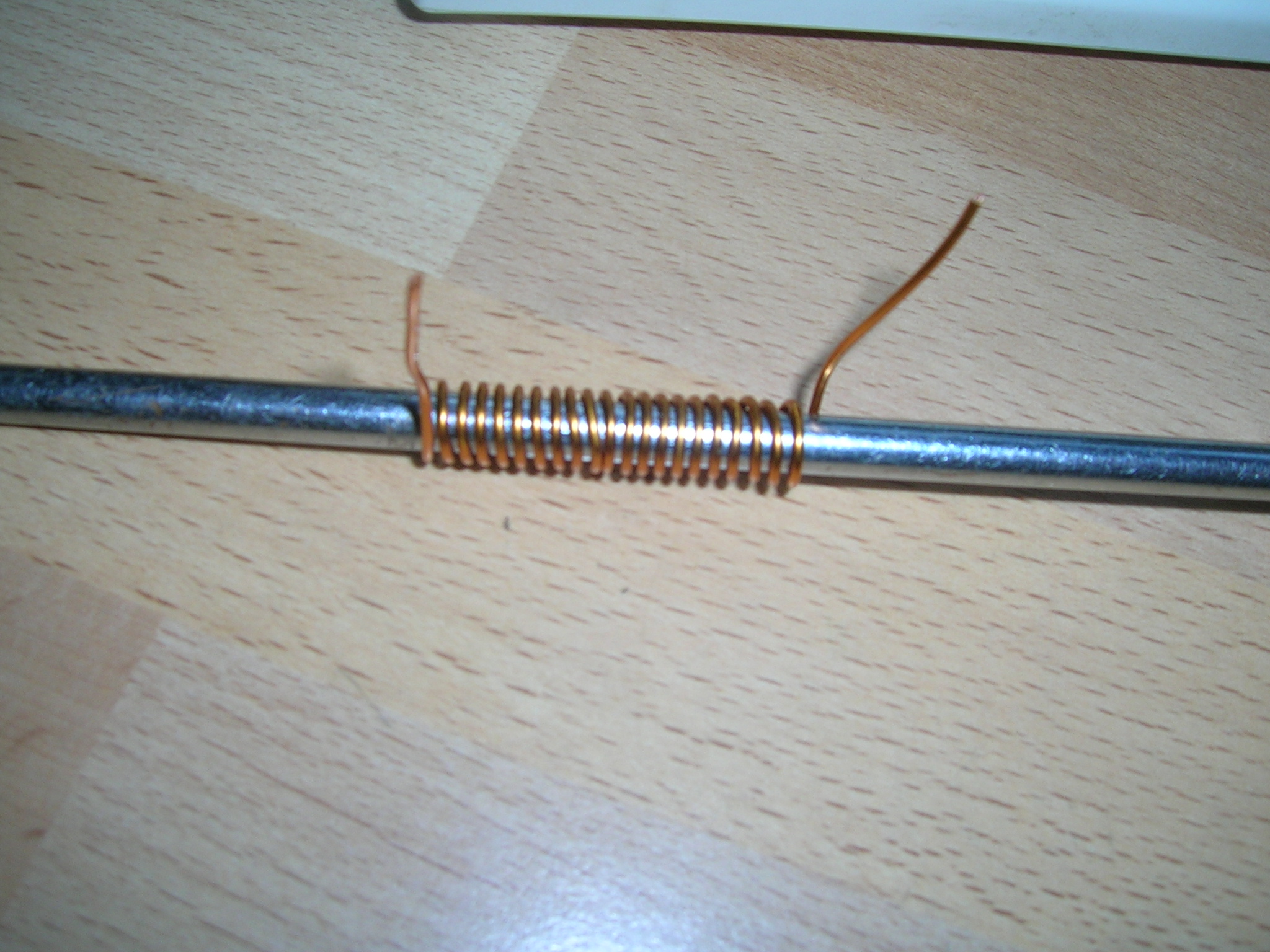

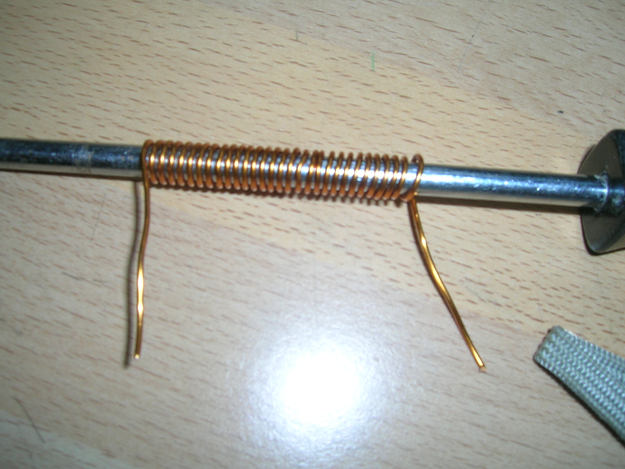

It seems the coil is wounded the wrong way

Yes, MM, your voltages are about right.
When you wind the inductor, hold screwdriver in RIGHT hand, with wire in LEFT hand.
Now, position start of wire at right, on top of the driver, and wind towards, down, under and back to the top, towards you for the next turn, and so on. That will ensure the correct technique......
Hugh
