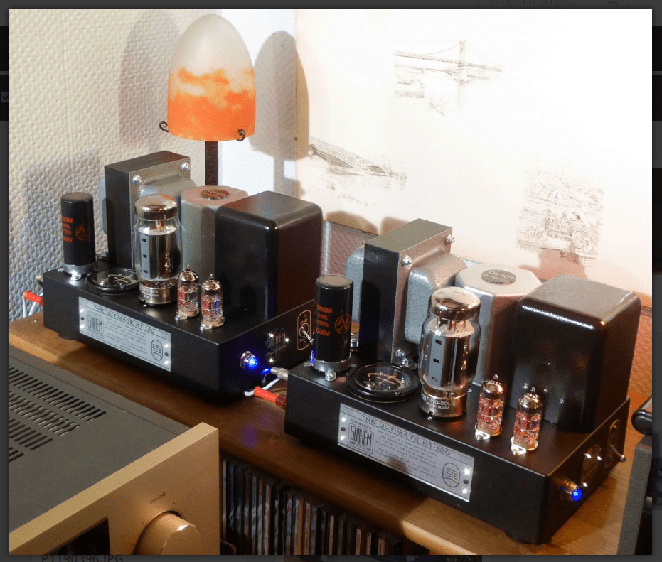

Aw sorry ! Mine are Ultra-Linear cathode bias operation , not triode... They use a single-ended KT120 per block, for a 12.5WRMS nominal output (clipping at circa 14W) :

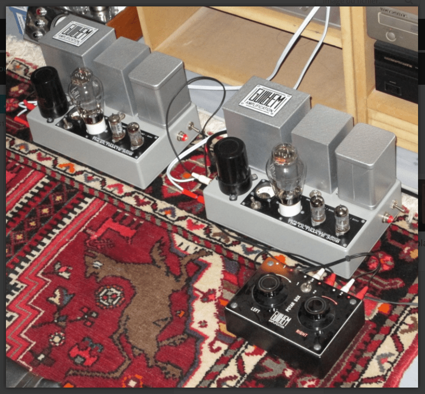

With the 300B triode this time, but still in SE cathode bias operation, I reach 8WRMS nominal (clipping circa 9WRMS) :
That said, if you want to stay SE and Triode, you could effectively parallel two 300B at the output stage : then you would then reach 15WRMS safely...
