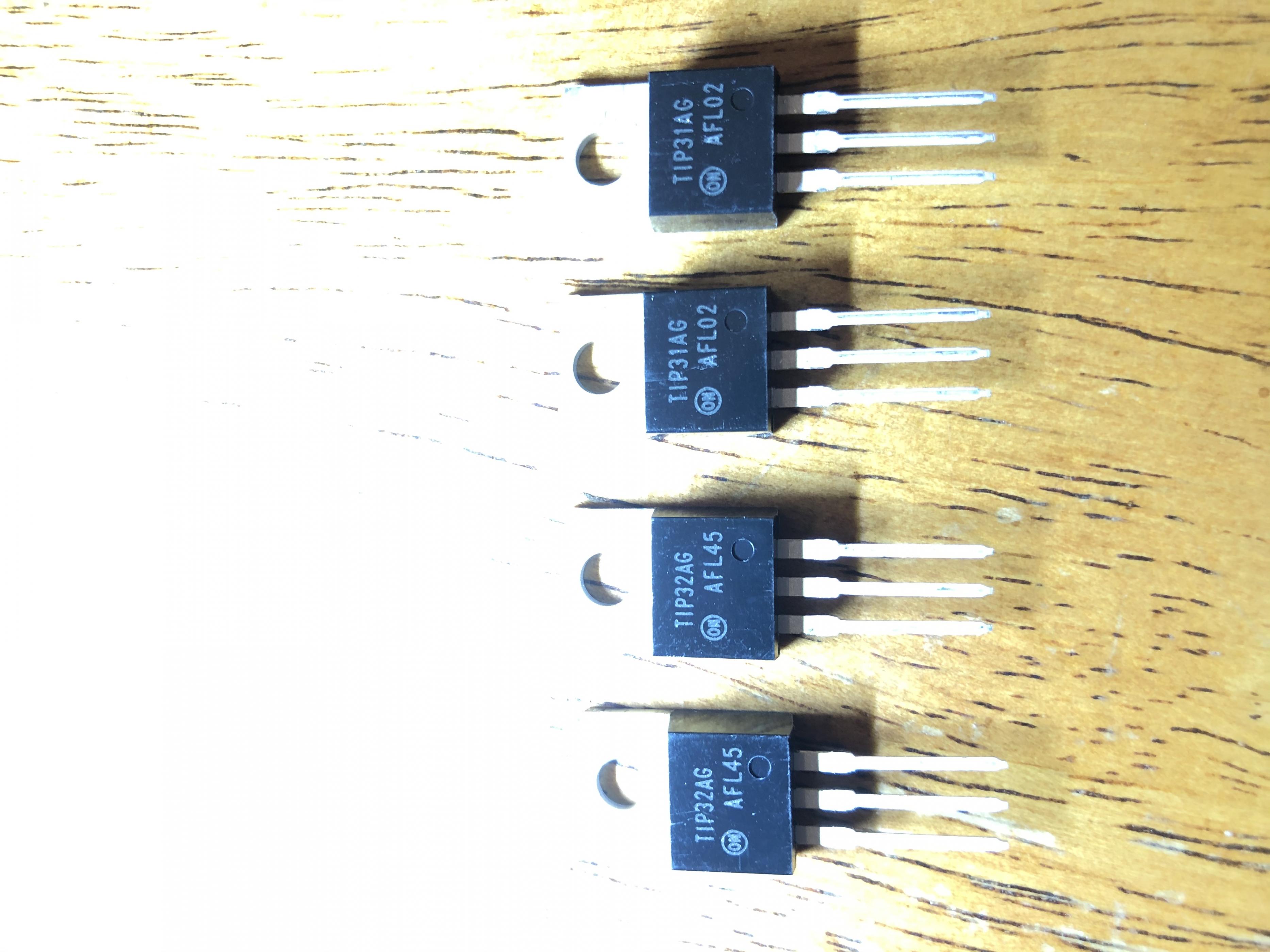

They are the cascode transistors. Remember that the v3 schematic has all the pieces, what you choose to use is up to you.
To clarify:
TIP32 (replaces obsolete 2SA1837)
TIP31 (replaces obsolete 2SC4793)
Can someone please assist, I bought the transistor kit for the F5-V2 from the diy store and I’m not sure where these are used? I’ve studied the schematics and don’t see them. Thanks in advance. View attachment 915586
